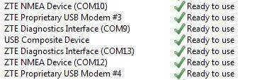

Run as Admin > dc-unlocker2client.exe > Scan for > ZTE modems after Scanning and it Detects Close it!
Note : Remember the PORTS [Application Port] and [Diagnostic Port]

  5. Run dc-unlocker2client.exe Scan for ZTE modems after Scanning and it Detects Close it!
  6. Note : Remember the PORTS [Application Port] and [Diagnostic Port]

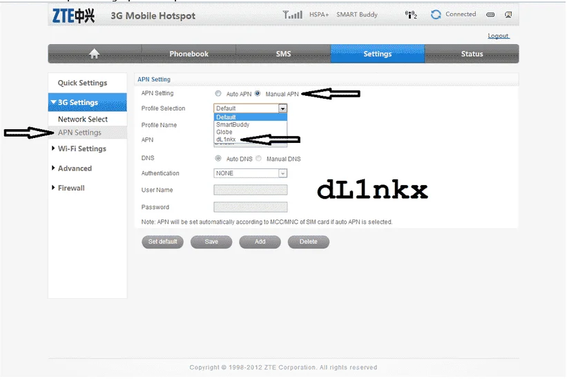

★ ★ZTE MF60 CHANGE APN w/o DEBRAND★ ★
REFLASH or DEBRAND to Change the APN

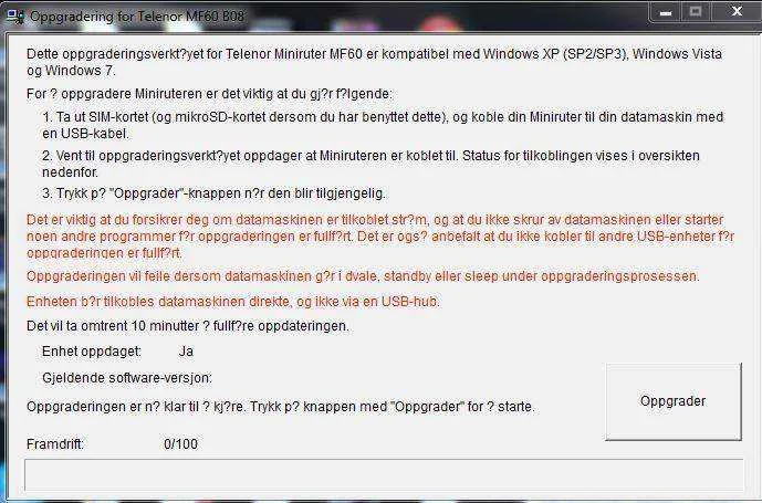

1. "Run As Administrator" telenor firmware tool and wait until the upgrade button becomes available.
2. Close the tool. DONT UPGRADE YET!!

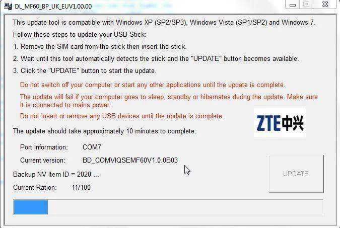

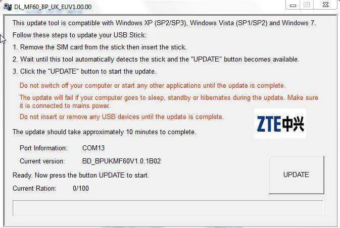

4. Start the official ZTE firmware tool. and pâtch TOOL!

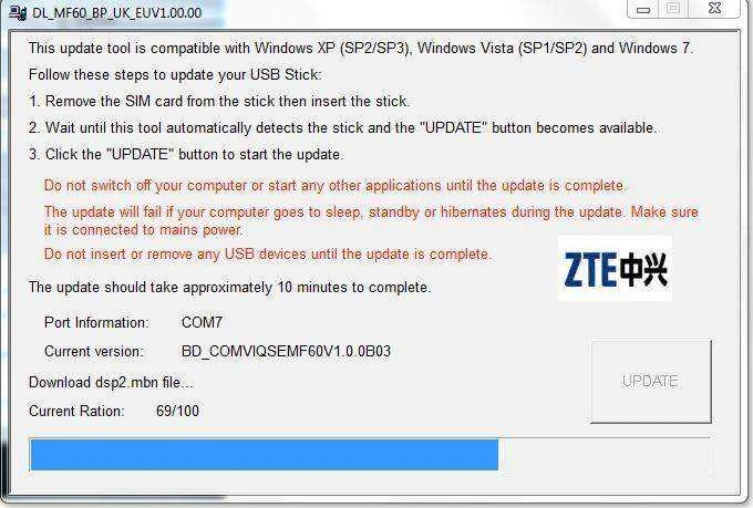

5. Once it is pâtch , next is UPDATE!
6. Wait until it's finished, it will take around 5-10 mins
7. Now you have original ZTE firmware installed! The HOME now is m.home or 192.168.0.1 . The PASSWORD is "admin"
8. To enable USB mode, simply run Telenor tool again and wait until the upgrade button become available. Close the tool. That's it. With the original firmware, the battery indicator is still there even if you're in diag mode.

Note: Before you change your APN , DISCONNECT FIRST!
