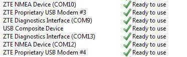

  5. Run dc-unlocker2client.exe Scan for ZTE modems after Scanning and it Detects Close it!
  6. Note : Remember the PORTS [Application Port] and [Diagnostic Port]

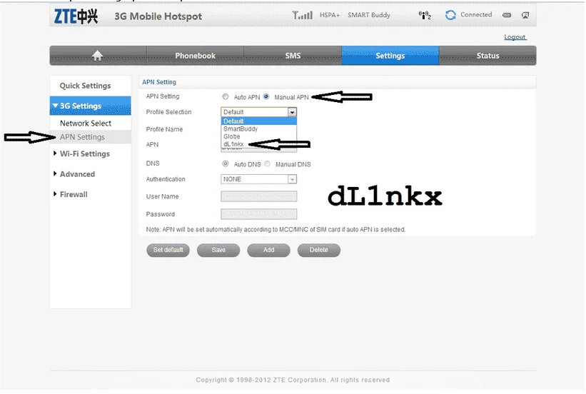

★ ★ZTE MF60 CHANGE APN w/o DEBRAND★ ★
REFLASH or DEBRAND to Change the APN

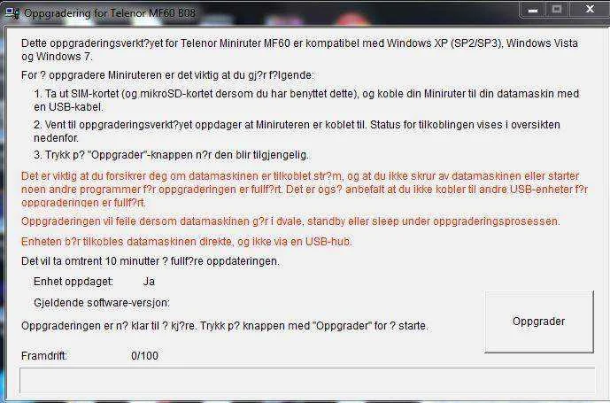

The original ZTE firmware tool. Download the file called You do not have permission to view the full content of this post. Log in or register now.
Telenor firmware tool You do not have permission to view the full content of this post. Log in or register now.

0. Connect the Modem using the "USB wire"
1. "Run As Administrator" telenor firmware tool and wait until the upgrade button becomes available.
2. Close the tool. DONT UPGRADE YET!!
3. Now your windows should found the new devices, it should look something similar to this. Wait until all devices are installed.

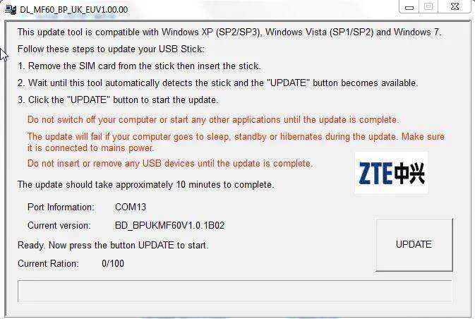

4. Start the official ZTE firmware tool. and pâtch TOOL!

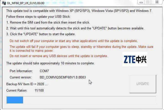

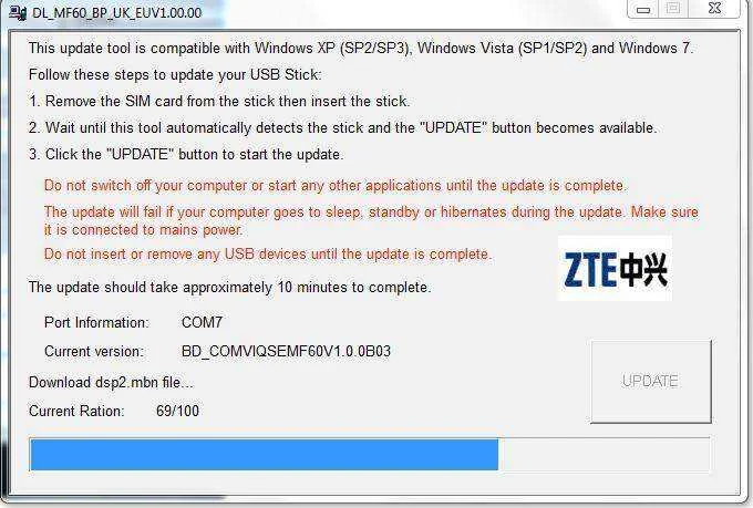

5. Once it is pâtch , next is UPDATE!
6. Wait until it's finished, it will take around 5-10 mins
7. Now you have original ZTE firmware installed! The HOME now is m.home or 192.168.0.1 . The PASSWORD is "admin"

Note: Before you change your APN , DISCONNECT FIRST!
