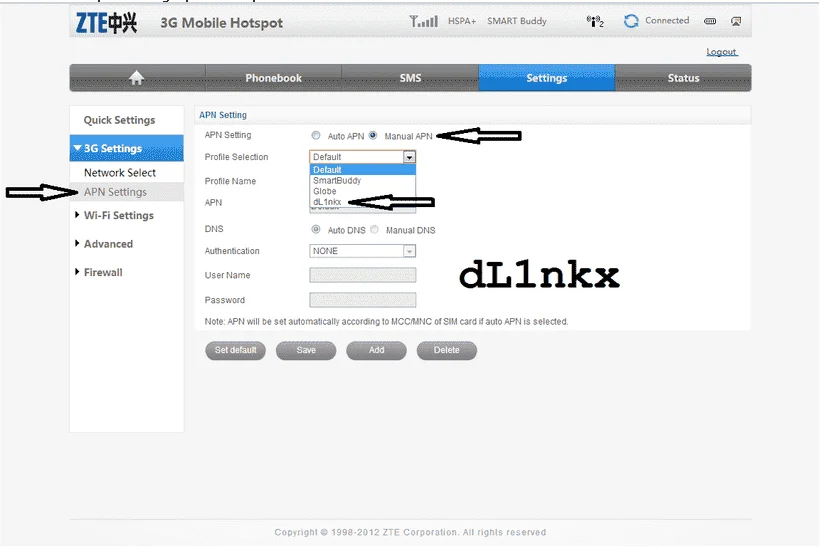

★ ★ZTE MF60 CHANGE APN w/o DEBRAND★ ★
REFLASH or DEBRAND to Change the APN

7. Now you have original ZTE firmware installed! The HOME now is m.home or 192.168.0.1 . The PASSWORD is "admin"
8. To enable USB mode, simply run Telenor tool again and wait until the upgrade button become available. Close the tool. That's it. With the original firmware, the battery indicator is still there even if you're in diag mode.
9. Enjoy your debranded ZTE MF60!
Note: Before you change your APN , DISCONNECT FIRST!
