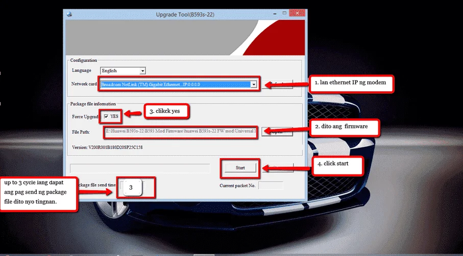

DEBRANDING PROCEDURE​
  1. Connect your modem thru lan cable to your pc​
  2. Turn on your modem​
  3. I open ang Multicast at sundan ang setting sa screen shot​
D5iokJV.webp ​
  1. Bago i click ang start button sa multicast i off muna ang modem. ngayon balik ka sa multicast at i click ang start button.
  2. turn on your modem antayin hanggang sa mag full bar na ang signal ng modem it means tapos na ang update.
  3. click stop button sa multicast at i closed ang application(multicast).
  4. Turn off your modem then turn on again.
  5. Go to your browser at mag log in ka sa gui ng modem. I refresh mo lang ang browser kung hindi parin natatanggal ang tattoo or globe logo

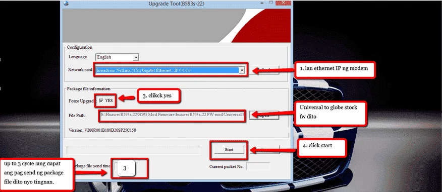

How to get back to original globe firmware? The same procedure lang po ng debranding pero this time "universal to globe stock fw bin file" na ang gagamitin nyo. pwede rin mag update thru gui ng modem.
How to return to globe stock firmware after "RESET" in universal firmware? After reset while using universal firmware hindi po natin ma aaccess ang gui ng modem natin. Eto ang dapat nating gawin.
1. Connect your modem to your pc by using LAN cable then used static or manual ip
(if you dont know how here's the You do not have permission to view the full content of this post. Log in or register now.)
USE THE FOLLOWING IP ADDRESS
IP address 192.168.254.1
Subnet mask 255.255.255.0
Default gateway 192.168.254.254
Preferred DNS server 8.8.8.8
Alternative DNS server 8.8.4.4
2. Reboot your pc
3. Go to your browser and type 192.168.254.254 dapat ma access mo ang GUI ulit ulitin mo Lang hangang makapasok SA GUI.
4. Once nakapasok kana sa gui it means detected na ng pc ang modem mo. I open ang multicast at gayain lang ang nasa screenshot
5. After multicast settings sundan lang ulit ang procedure sa taas from 4-7. ( Debranding procedure)
6. Balik uli SA browser type 192.168.254.254 dapat ngayon maka access kana SA GUI. Log in as user (if Hindi maka login as user default password Ng globe I reset mo uli ang modem then mag login uli) upload ang config file para may admin access ka.
7. Tanggalin sa manual ip ang pc at i reboot.
8.. Then go to your browser type 192.168.1.1 done! Globe stock firmware kana ulit. Kung gusto mo ibalik sa universal same procedure ng mga naunang tuts sa pag update….. Good luck
