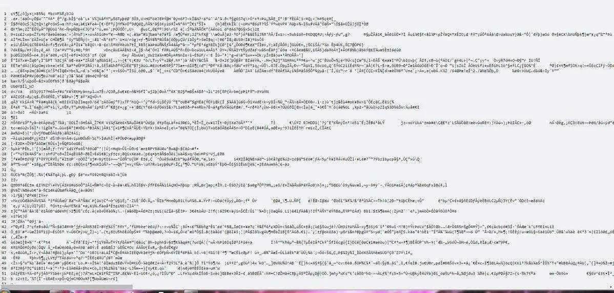

good day po sir ryanpaul17. me problem po ako sa modem ko Huawei b593s 22. nagagamit ko eto before. then as per my friend's suggestion na mag finland firmware mas ok daw. then after a month nagkaproblema. my mistake is nireset ko. kasi dati nagrereset ako pero thru the tutorials nababalik ko sa globe stock then debrand ulit. pero this time hindi ito working sa finland firmware. baka me solution kayo? thanks!
Yes my solution tau download mo muna ung tool ng debranding s22 gamitin mo muna ung globe stock para mabalik ung gui mo then.. ngaun babalik ka sa 192.168.254.254 or 192.168.254.1... kapag nakapasok ka go to SYSTEM> upload configuration chose file eto ang ilalagay mo You do not have permission to view the full content of this post. Log in or register now. antayin mo matapos.. after nyan login kana dto 192.168.1.1
user: admin password: password123.. openline na yan.. at para madebrand ulit yan..
LAST STEP :
Download mo to universal tested ko to at eto ang gamit ko...
hindi na tau gagamit ng debranding tool
- log in ka sa gui mo
- go to home
- go to update
- local update jan mo ilalagay ung dinownload mo.. wait hanggang matapos... after nyan patayin mo ang modem mo or reboot/restart.. Congrats!!! pm mo ako ulit kapagwala padin
WARNING!!! WAG IRERESET
