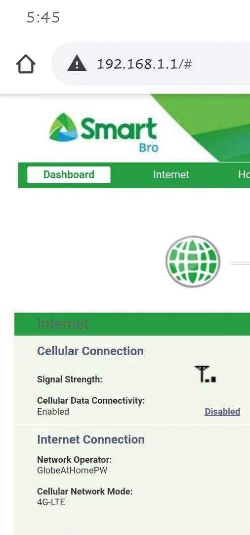

this will include flashing and openline steps.
download You do not have permission to view the full content of this post. Log in or register now.
step1: tangalin ang batery at picturan ang mav adress.
step2: buksan ang downloaded file sa pc at pumunta sa step1 folder..
step3:run the installer (instal update)
step4:remove simcard
step5:open step 2 in dow
nloaded file
step6: run swdownloader
step7: click file then open dun sa ibabaw
stvep8: hanapin sa step 2 folder ang
Nezha_MiFi5_LWG_Only_Nontrusted
step9:click on the green bulb magiging red un
step10: conect natin si wifi via usb
ung cable dapat with transfer
then i on agad ang wifi pag ka connect dapat may arrow na lumabas
step10:click ok pag natapos
step11: disconnect the usb and exit na ung program
step12 : i on ulit at wifi at magiging White screen lang sya
step11: iconnect ulit sya sa pc at open device manager ng pc
step 12 : sa device manager ng pc sa other devices meron don error click mobile AT
tapos update driver -》Browse my computer for driver software-》Let me pick from a list of available drivers on my computer-》Show All Devices-》Have Disk-》Disk-》browse- 》MSUBSer
nasaloob ng step3 folder
step13:choose marvel AT
step14: sa Mobile Diag Interface naman same steps pero piliin this time is Marvell DIAG USB Device Version: 2.0.0.1 [10/11/2012]
step15: close device manager
step16: punta kayo sa step 4 folder run mifi tool 1.0.0.3
step17:chinese kaya baka ung ibang pc d makita ung mga button. click ??. palitan ng com3
step 18: sa pangalawang IMEI enter IMEI ng globe at home modem nyo if wala hanap kayo dito sa phc madami nakakalat. then click ung katabing button dapat mag green click nyu ung sa taas nya na button to confirm na na encode sya
step19:ganun din sa mac pero gamitin nyu ung sa pocket wifi mismo na mac.
step20: click ?? sa may ok button position. and exit driver.
step 20 reset wifi and inset globe at home simcard
connect kayo sa wifi ng pocket wifi
if may password smartbro ang password.
punta sa 192.168.1.1 then log in smartbro ang user at pass
step21: router tab clicknsofware upgrade then browse -》NZ_MF_FX-PR3_AT2.22_SB_V09.bin
nasa step 5 folder -》install
step22: restart device then log in ulit sa 192.168.1.1
step23:under Internet hanapin ang Mep
then enter code "@2N@t1Tr3"
then click unlock dapat maging lock ang makita mo.

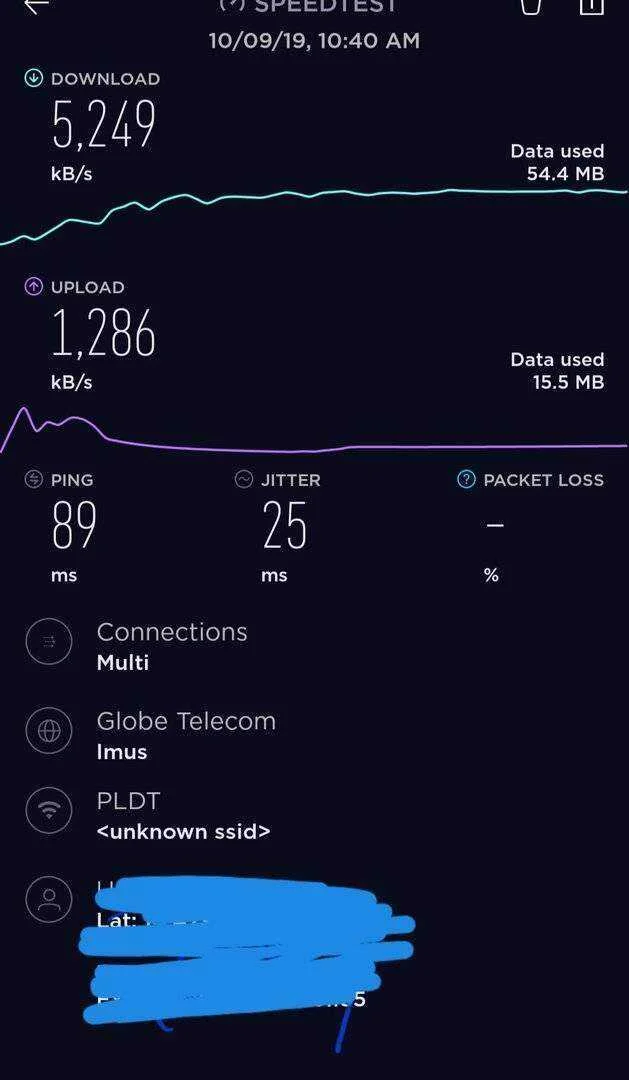

step24: restart device and browse using globe at home sim!
step25 : pa like ng thread and wag i update kasi d stable ang updated version :) tip if malaks 4g sa inyo i 4g only nyo mas preffer kasi nyabstronger signal like 3g kaya bumabagal
