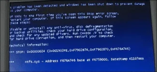

Windows Starts and Blue Screens or Freezes
If Windows crashes or blue-screens on you every time it boots, you may be facing a hardware or software problem. For example, malware or a buggy driver may be loading at boot and causing the crash, or your computer’s hardware may be malfunctioning.
To test this, boot your Windows computer in safe mode. In safe mode, Windows won’t load typical hardware drivers or any software that starts automatically at startup. If the computer is stable in safe mode, try uninstalling any recently installed hardware drivers, performing a system restore, and scanning for malware. If you’re lucky, one of these steps may fix your software problem and allow you to boot Windows normally.
If your problem isn’t fixed, try reinstalling Windows or performing a Refresh or Reset on Windows 8. This will reset your computer back to its clean, factory-default state. If you’re still experiencing crashes, your computer likely has a hardware problem.
