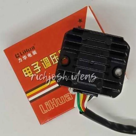

Sa rectifier --
Kailangan mo syempre fullwave din na rectifier(with 5 pin)
images.jpeg 👈ganito itsura
Remove old rectifier :
New wiring for new rectifier.
5 WIRES
1 Rectifier RED wire - to red wire of your harness (ito yung +batt) yung wire sa dating socket.
2 Rectifier GREEN wire - to green wire from the old socket.
3 & 4 YELLOW and WHITE/YELLOW and PINK/WHITE and PINK - huwag mag taka kung may pink, minsan ganun yung kombinasyon ng kulay ng rectifier pero pareho lang sila ng trabaho. kahit magbaliktad sila ng koneksyon sa yellow/black from stator at white from your old socket ok lang. Dahil sila yung magfufullwave (sa 2 wire na yan dumadaloy ang kuryente na galing stator)
5 BLACK from rectifier - sa constant +12v . Siya yung mag kokontrol para hindi ma over charged yung battery mo.
