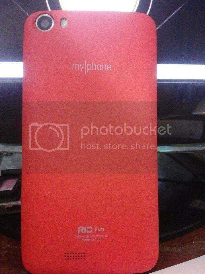

boss may problema ako hindi ko alam bakit pag eturn on ko AGUA RIO FUN KO hanggang sa myphone lng sa startup lng .. ano ba dapat gawin ko ??? hindi ko naman na eroot ee . hindi ko pa nagagalaw cp na to.

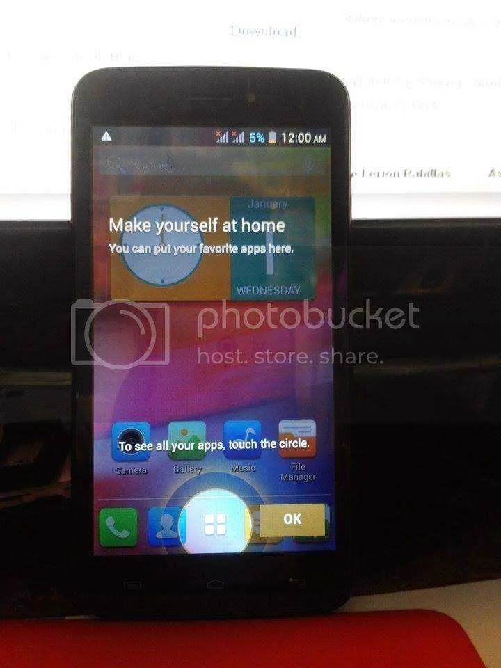

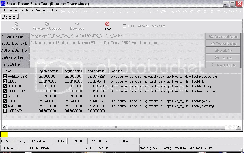

1. Extract your downloaded Stock ROM to Desktop.
2. Extract to your Desktop and Open SP Flash Tool.
3. On SP Flash Tool click “Scatter-loading” button.a. Locate your downloaded stock rom.b. Select “MT6572_Android_scatter_emmc.txt”. Wait files to be added in to SP Flash Tool.
4. Turn off your phone and remove battery.
5. Click “Download” button or press F9 button.
6. Connect your phone to your computer using a USB Cable.
7. The process will start, wait until a green circle will pop up. And you’re finished!You can now safely disconnect your phone and turn it on.
NOTE: uncheck secro and userdata para po hindi nawawala ang imei o nag e invalid imei
DONE
credits to Xian
see the attachment for the download link
kaylangan mong ifullflash ang unit mo

BROM ERROR : S_CHIP_TYPE_NOT_MATCH (3168). error sir
ibig sabihin sir ung rom na na dl mo hindi pwede para sa unit mo
