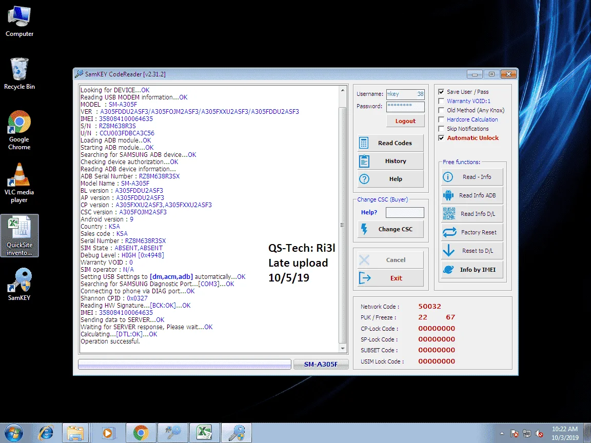

How to Open Line samsung A305F using Samkey cost 3 credits. (samsung 305F is now supported on Samkey)
1st step
Go to Samsung Setting and then enable your developer mode by pressing Build no 6 times
2nd step
enable USB debugging
3rd step
Turn off password, remove sim card and Google account.
4th step dial
*#0808# and enable and select DM+Modem+Abd then press OK
5th Step
Plug in your Samsung A305F to your pc and Click read codes, it takes 5-10 minutes depende sa server. wait mo hangang maging successful siya
at yun! successful :D
NOTE: pag nilagyan nyo ng sim at ng hihingi ng codes, may makikita kayo ng codes buttom right, yan ang gagamitin nyo UNLOCK CODES :D at magiging open line na siya 101% :D and dont forget to disable your developer mode
SANA MAKA TULONG
