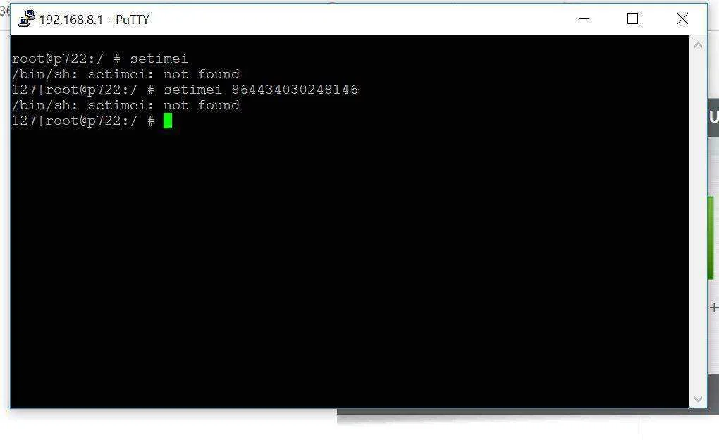

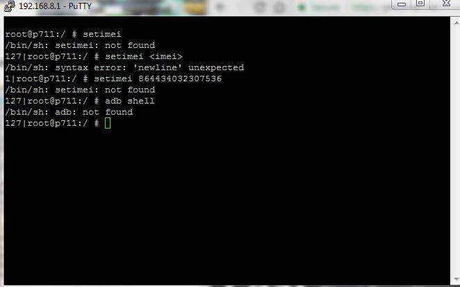

Sir tried doing it pero not found ung error. Updated na po ang firmware from sir Jhowel. Help please.
