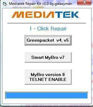

1, hayaan nyo lang bukas ang remoted device natin at ikonect sa pc/laptop natin open nyo si tool Mediatek repair kit
2,since wala tong gui,telnet,169 ip, pwede natin sya irepair gamit yan pagkaopen nyo ng tool, CLICK Green packet v4/v8 depende sa firmware ng device nyo
3,After successful Repair, magkakaroon na tayo ng telnet at web Gui,kung wala pa,mag reflash tayo basta mabuksan lang si gui or telnet for repair ni mybrokentool

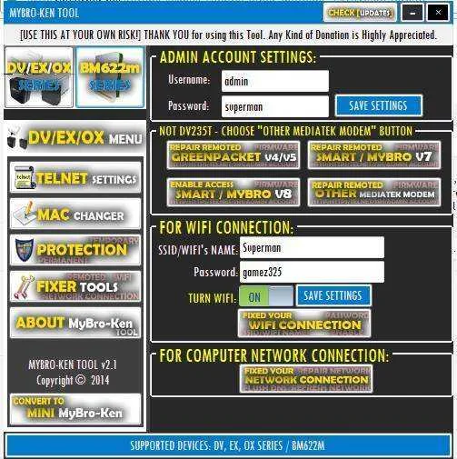

4,Ang problema ngalang Unknown Admin ang GUI at TELNET natin,
5,Dito naman papasok si MybroKen Tool

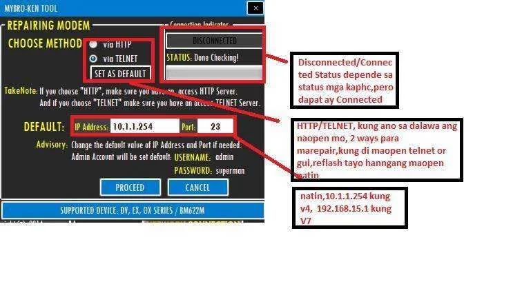

6,Choose molang si DV/oX > Fixer tools > repair remoted DV, then access it via http/telnet after succesfull repair using the tool, Okay na ulit ang GUI at telnet mo accessible na sya using smart smart,admin admin, user user, at ang 00:11:22:33:44:55 which is mac ng remoted ay babalik na sa default mac neto
7, reredirect ka nyan sa Https:/10.1.1.254 or 192.168.15.1
8, log in as admin
9,Reboot your device
10,Log in as Admin : admin, after that iconfigurate nyo muna si protection,after that Change to live mac na
You do not have permission to view the full content of this post. Log in or register now. Password: florant3
Mybrokentool
