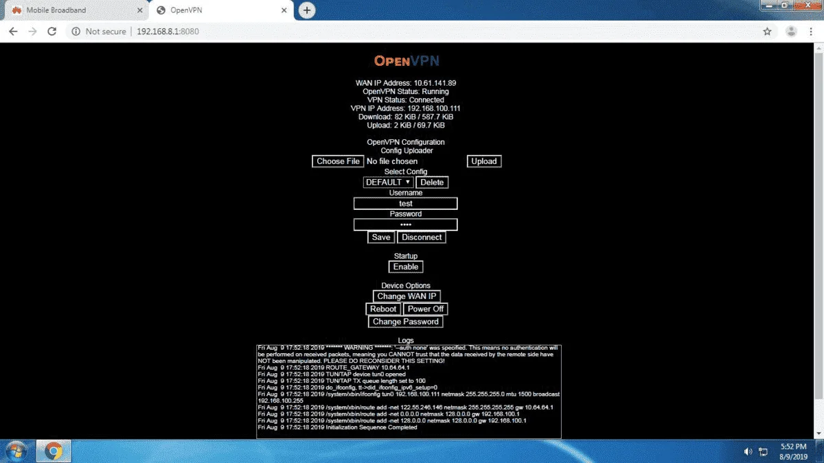

OpenVPN only [Fast UI response / lite binary mbedtls]

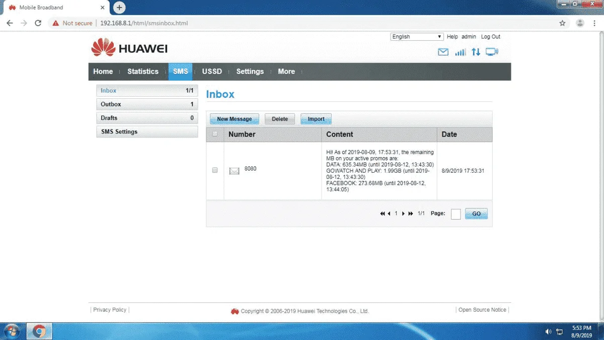

Show download/upload speed in home

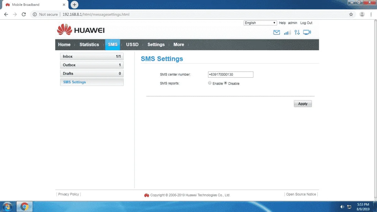

Enabled SMS center settings

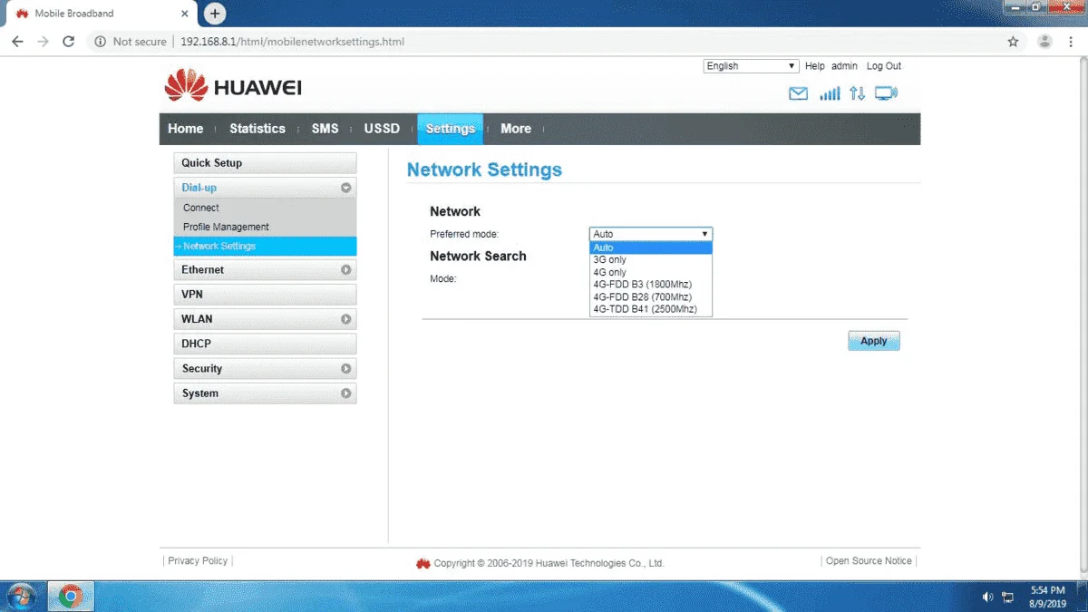

Frequency and Band locking

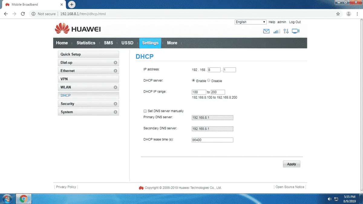

Enable DNS changer

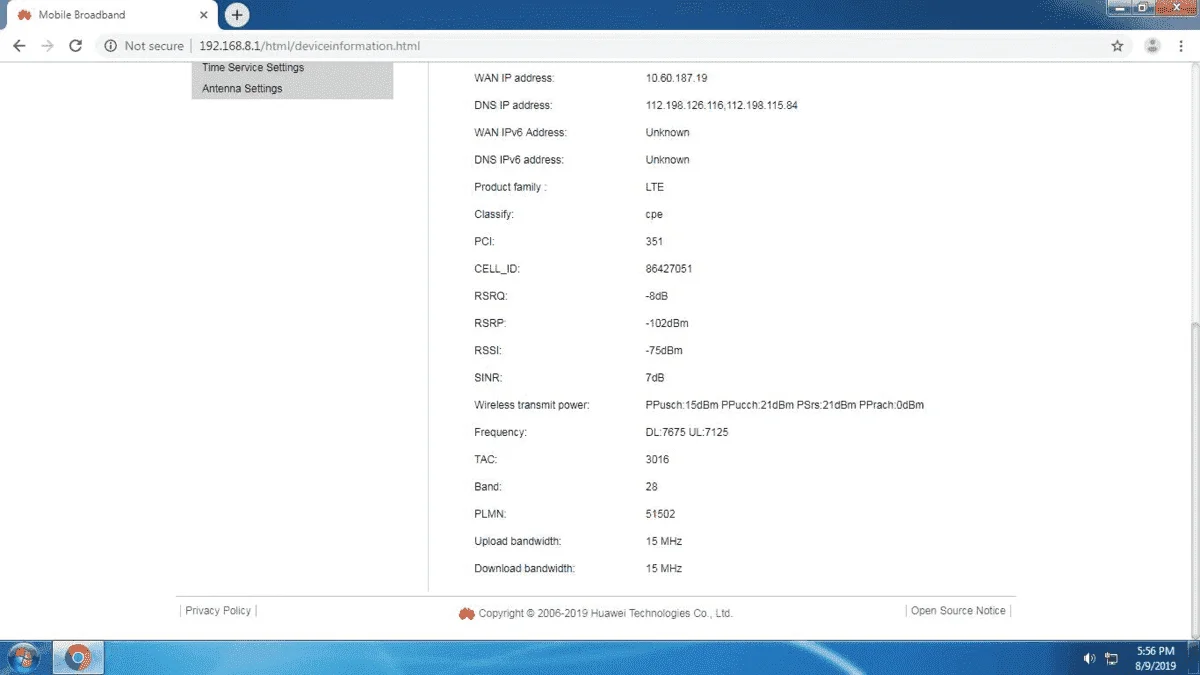

Add parameters in device information

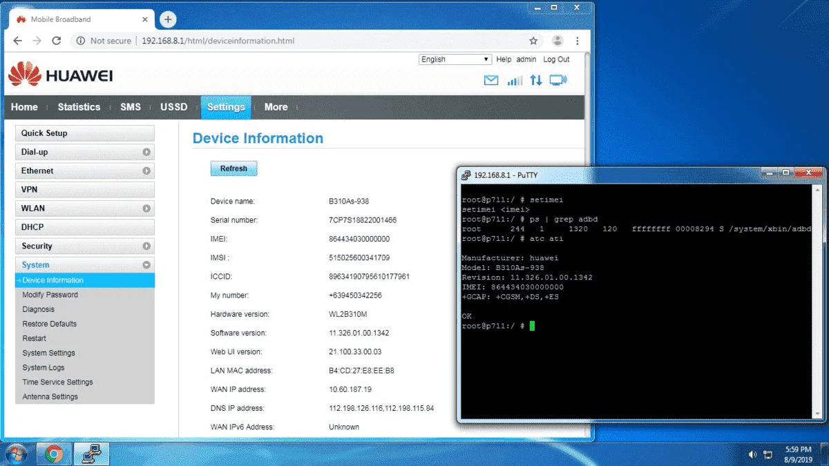

Enable telnet
Enable adb
Enable atc for AT command in telnet
Add setimei commands for changing imei using telnet
Add unlock commands for unlock/openline using telnet

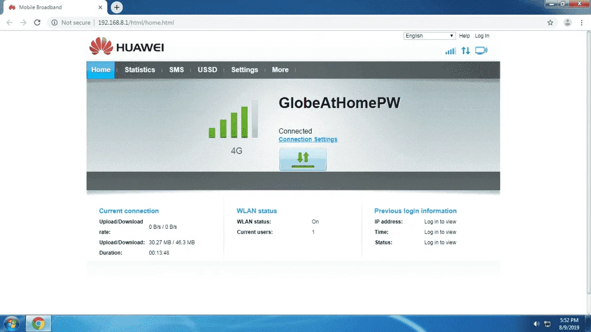

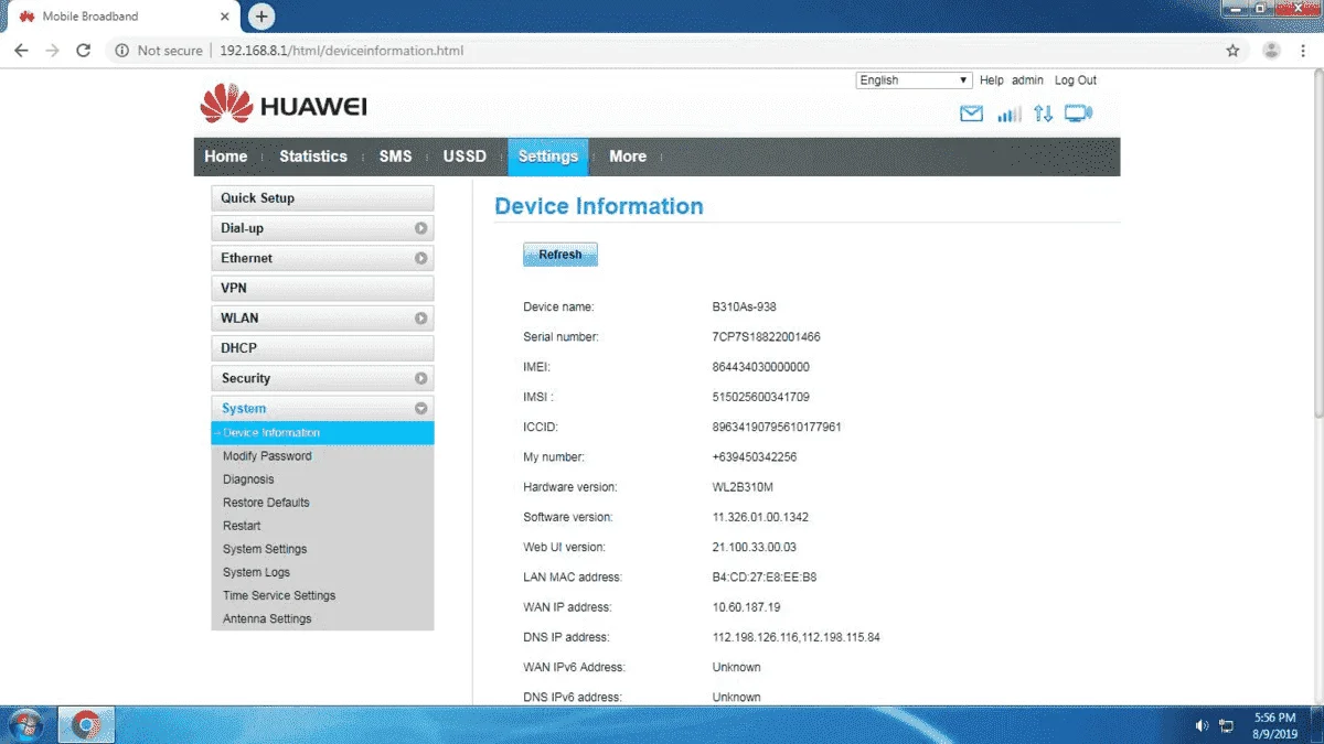

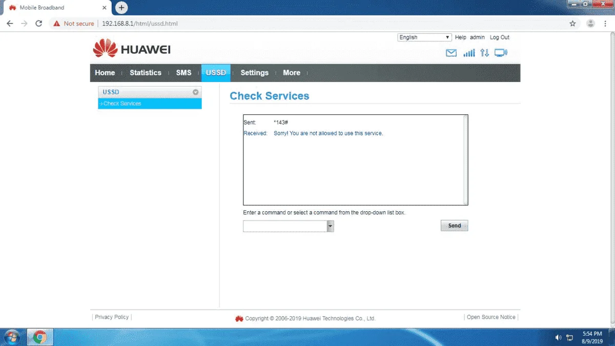

View attachment 662550 View attachment 662551 View attachment 662552
View attachment 662554 View attachment 662556 View attachment 662558

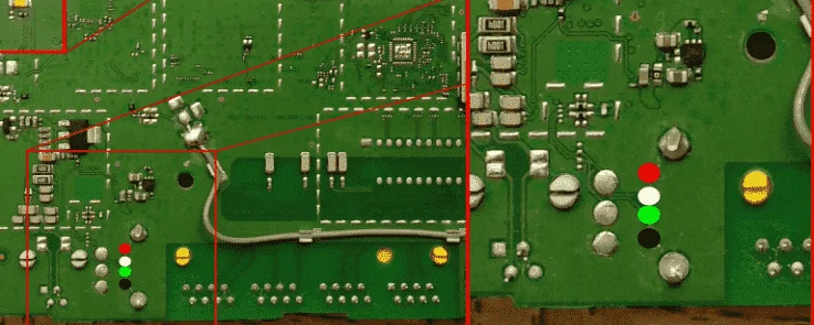

  • * Requirements

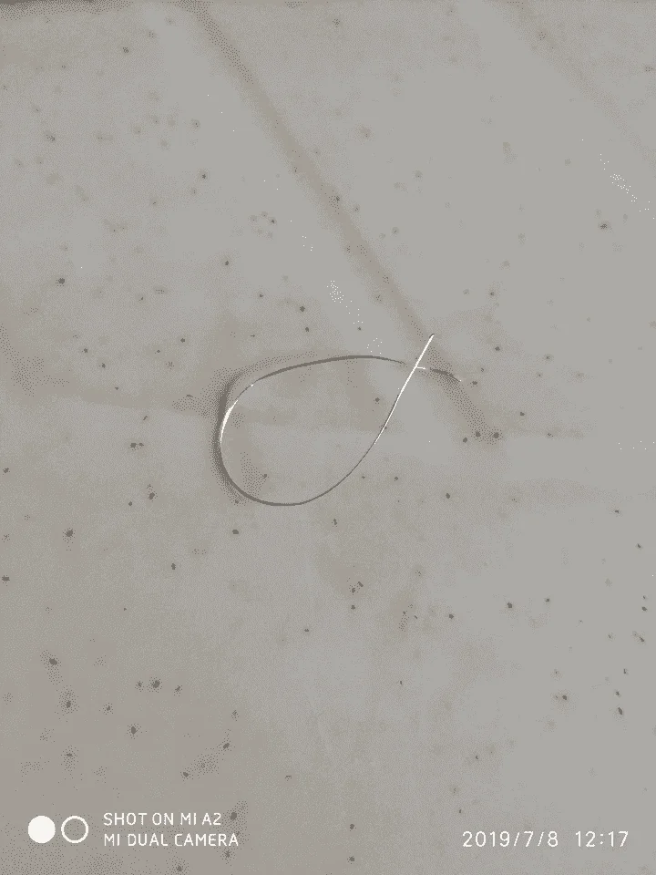

    1. Conductor metal [Wire, Paper Clip na walang cover or any metal na conductor, example yung wire.jpg]
    2. Desktop / Laptop / Computer [Basta naka windows ang operating system]
    3. Modem na nakabukas na, or tingnan nyo nalang yung nasa B310.jpg.
    4. USB Male cable na putol at may color wire na red, white, green at black. [Mas maganda na ganyan ang kulay para alam nyo ang pag didikitin sa board, may iba kasing connector na iba ang kulay.]
    5. Kung kumpleto na, proceed na kayo sa install ng drivers.

  • * Connecting USB in device

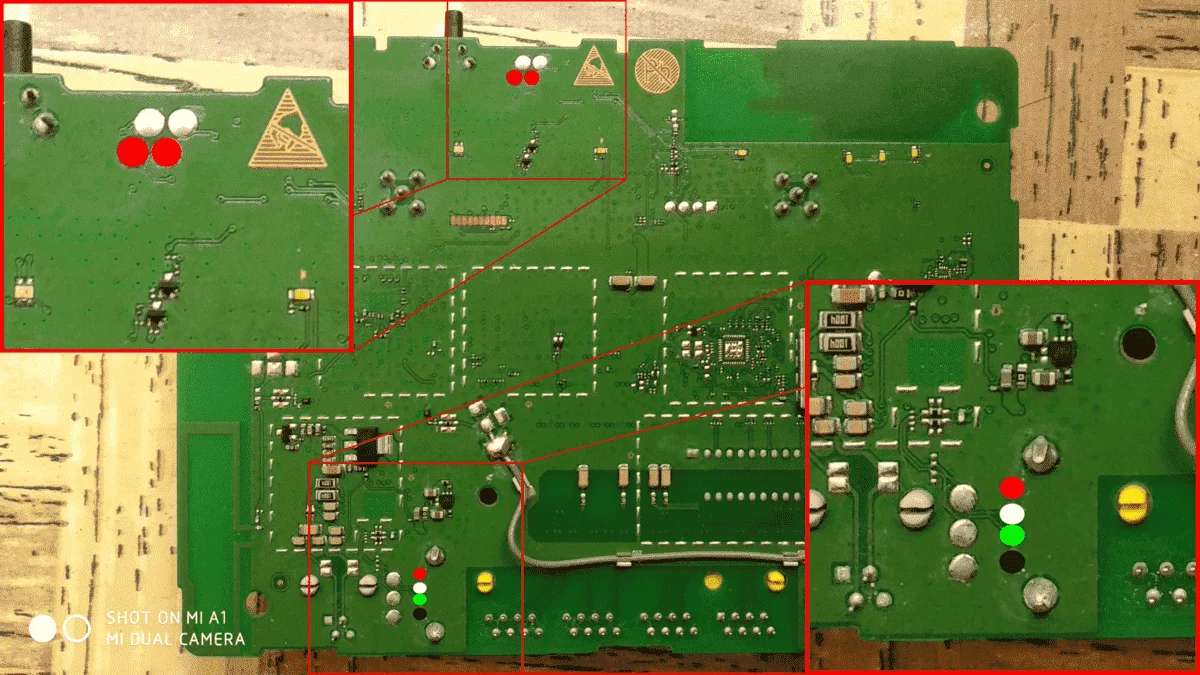

    1. Buksan ang B310.jpg.
    2. Makikita nyo sa picture na merong color coding na red, white, green at black.
    3. Don nyo ididikit ang usb wire na icoconnect nyo sa modem.
    4. Kapag connected na, proceed to booting device in download mode.
A

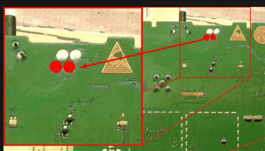

  • * Booting device in download mode
    2. Makikita nyo sa picture na merong 2 red dots, pag didikitin mo yon gamit ang conductor metal.
    3. Habang nakadikit ang conductor metal dun sa 2 red dots, isasaksak nyo ang power supply.
    3.1. Dapat hindi iilaw ang modem kapag sinaksak nyo ang power supply.
    3.2. Kapag umilaw ito nung sinaksak nyo ang power supply, iunplug nyo ang adaptor at ulitin ang step 1-3.
    3.3. Kapag hindi umilaw, isaksak ang usb cable at iremove na ang jumper.
    4. Success na ang download mode, proceed to flashing firmware.

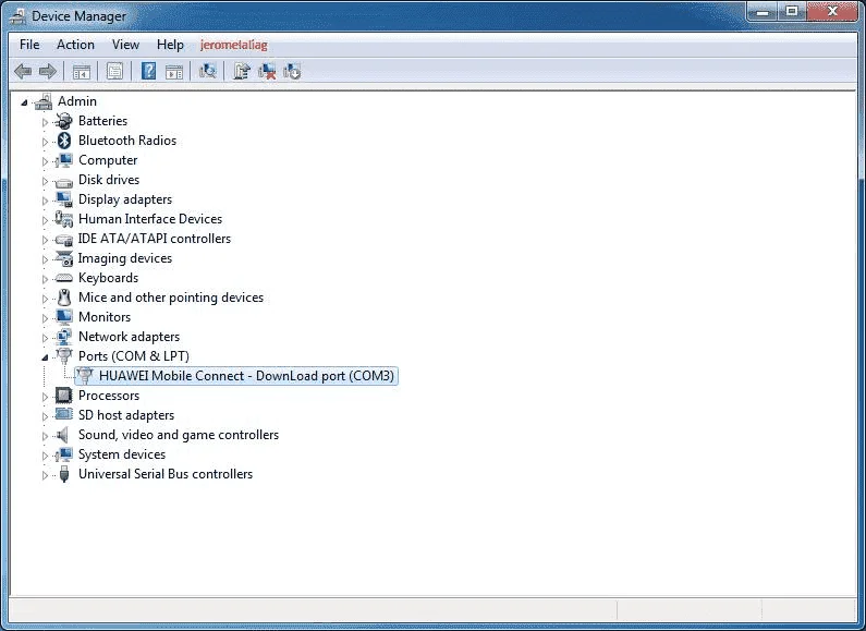

  • * Flashing firmware in device
    1. Bago mo simulan ang process na ito, make sure na detected na ang device nyo as port sa device manager.
    1.1. Eto dapat pangalan ng port sa device manager HUAWEI Mobile Connect - DownLoad port.
    1.2. Kung hindi pa nadetect or walang lumabas na ganyan sa device manager, ulitin nyo ang Booting device in download mode na process.
    1.3. Kung detected na, proceed to step 2.

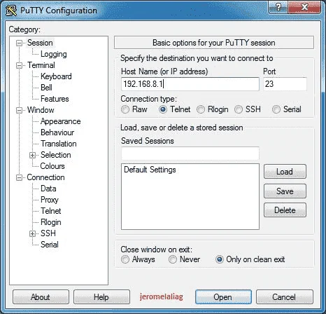

* Unlocking / Openline to all networks
1. Make sure connected ang modem nyo via wifi or via lan cable.
2. Iopen ang putty.exe.
Host Name (or IP address): 192.168.8.1
Port: 23
Connection type: Telnet
Then click Open.
3. Kapag may lumabas na root@p711:/ #, itype lang ang word na
unlock
then ipress ang enter key.
4. Kapag may lumabas na
Unlock success!
Rebooting...
5. Success na ang pag openline ng modem nyo.
* Changing IMEI [NOTE: OPTIONAL LANG ITO KASI SUPPORTED NA TALAGA SA DEVICE NA ITO ANG ATHOME NA SIMCARD]
Port: 23
Then click Open.
3. Kapag may lumabas na root@711:/ #, itype lang ito
Note: Replace <imei> sa imei na gusto mong ilagay.
setimei <imei>
Example: Ang gusto kong imei ay 864434032366318 [May IMEI.txt ako na file na sinama, pwede kayo kumuha dyan sa 1,000 list.]
setimei 864434032366318
Changing IMEI to 864434032366318
Success!
Rebooting...
5. Success na ang pag change ng imei sa modem nyo.
  • * Installing OpenVPN
    1. Make sure connected ang modem nyo via wifi or via lan cable. [Recommend ko is wifi, para mabilis ang transfer speed]
    2. Iopen ang B310As-938 OpenVPN.exe [Use run as administrator]
    2.1. Hintayin mag 100%
    Installing please wait...
    [ 0%] /tmp/vpn.tgz
    3. Kapag 100% na, hintayin matapos ang install process, at hintayin lumabas ang install finish.
    4. Kapag nag reboot na ang device nyo, success na ang install ng openvpn.
