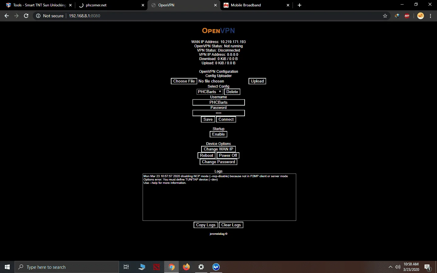

sir baka may pang B310As-938 Ver.A "OPENVPN" ayaw kasi gumana ng openvpn na kasama sa post mo success pero hindi maopen ang site 192.168.8.1:8080 ko

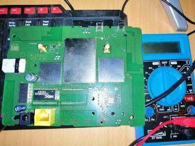

Idol Master Jerome and Johannus, thank you so much for sharing. I had to offer my backup internet to my wife's colleague who's struggling WFH due to covid 19. We don't know kase which provider ung may mabuting signal sa kanila so I had to open line the device. I also got frustrated looking for a Huawei calculator that would calculate the Imei and mac address to get the admin password. Mahirap guys mas mabuti pa to admin agad once done. I learned soldering when I was in high-school and never thought this guide would be that easy. Follow nyo lang ung guide guys. I used this on B310As-938 na walang B so I don't know if this will work on other models paki confirm mga papi. This took me 20 minutes kase nung una indi ma recognize sa USB connection, un pala may isang wire ndi naka solder ng maaus. Disable nyo lang ung antivirus nyo permanently than the option to enable after restart, enable nyo lang manually later on. Daming false positives ung flashing nya so I would suggest you disable this first and if ur using strict mode sa zonealarm free, enable nyo lang ung game mode automatic allow anyways ndi naman kayo naka connect sa internet. All in all great guide, nag start ako sa youtube and then searched for an updated version or modded version of the firmware before starting flashing. Ingatz guys stay strong amid Covid 19 crisis. More power to this site and sa mga bossings that still supports it and contributes for the benefit of everyone.

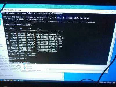

mukhang tatlo na tayong ganito boss. detected naman. pagtappos lng ng ???????? tapos matagal tapos biglang finish lng din pero hindi nya napailaw during process. bricked na kaya? ngayon deads na wala power pero kapag iflash ko detected naman. mga master help

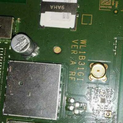

Ganto den nagyari sakin pre no lights dko na check hardware version WL1B310I VER A RF pala
parang hard bricked na ata pero detected paden sa device manager and nagtutuloy tuloy yung flashing process hanggang sa matapos pero no lights , so nag try ako na mag clear nvram same sa 936 ko dati, no luck pa den. Sana may maka tulong sayang naman tong modem.

sir try mo yong all in one flasher nila.. tpos flash mo version A kasi yong akin kagabi kaya nabrick Version B pala naflash ko ng A

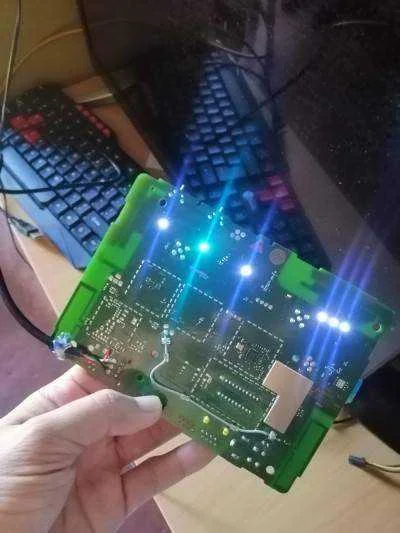

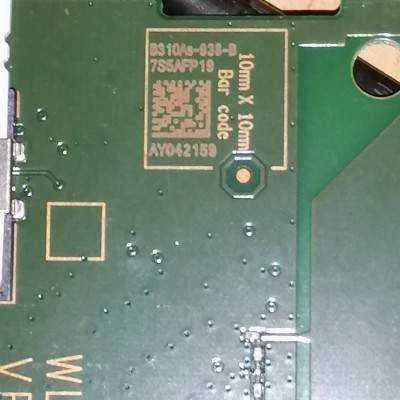

Update update update!
Oks na sir nakuha ko na.
Para sa lahat ng mga na brick ang b310as no lights
Erase nyo muna nvram same procedure dun sa b315
Then check nyo yung barcode! Dun nyo makikita yung version ng firmware kung ano dapat i flash sa board. Hindi yung may malaking nakasulat na VER. A
DUN AKO NAGKAMALI ang right firmware pala sakin ay B310AS-938-B yun yung nakalagay sa barcode. 👏👏🤟
