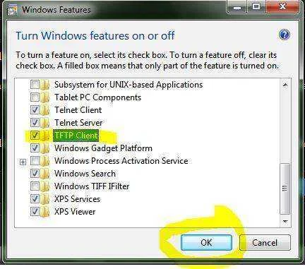

How to enable TFTP Service?
Go to start menu and type "Turn Windows Features on or off" in the Search bar and select the 1st result and press Enter
a window will popped-up. After the window loads, look for TFTP Client, tick the checkbox and click OK
The window will automatically close, please wait a moment.View attachment 17541​

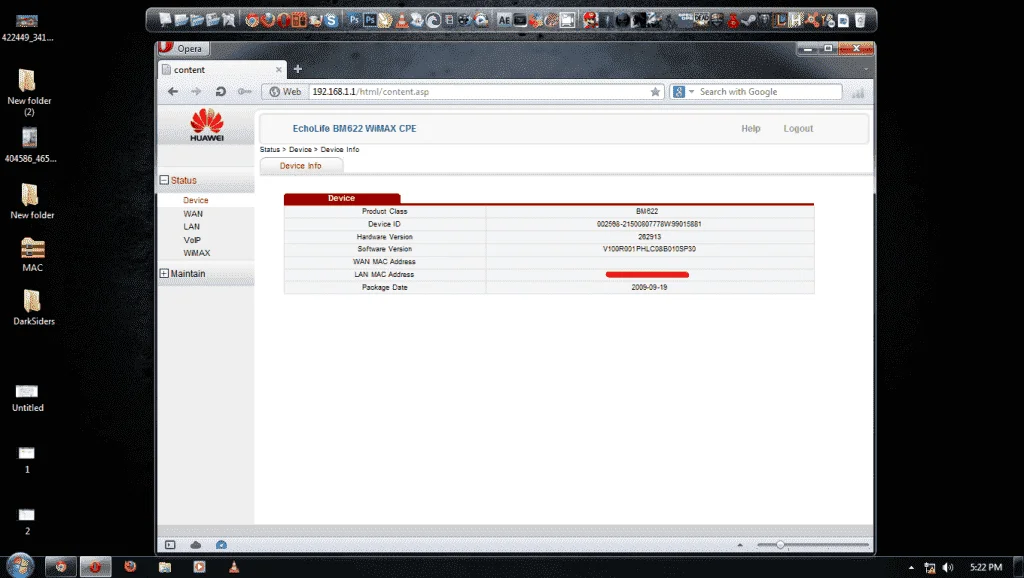

follow this
telnet 192.168.1.1
Login: wimax
PASS: wimax820
ATP> display allmacaddr
ATP> setallmacaddr "enter your Mac"
ATP> save
ATP> exit
Upload ng Fresh ADVANCE config file (SEE IN THE ATTACHMENT)
Run the bm622 2011 (Upgrader Tool)
Upgrade to 2011 firmware.
After Successful Upgrade
telnet 192.168.1.1
Login:Firefly
PASS: $P4mb1h1r4N4m4nT0!!
ATP> "set sêrïâl number command"
ATP> xiugai macdizhi "Your Mac"
ATP> diag restore default
Done! {Blank Wan Solve}
For Manual Upgrade via CMD
1. Copy the bm622firmware.bin to c:\(your firmware file location)
2. RUN cmd
3. cd "c:/" then press Enter
4. tftp –i 192.168.1.1 put bm622firmware.bin
5. wait till finish
6. done!
