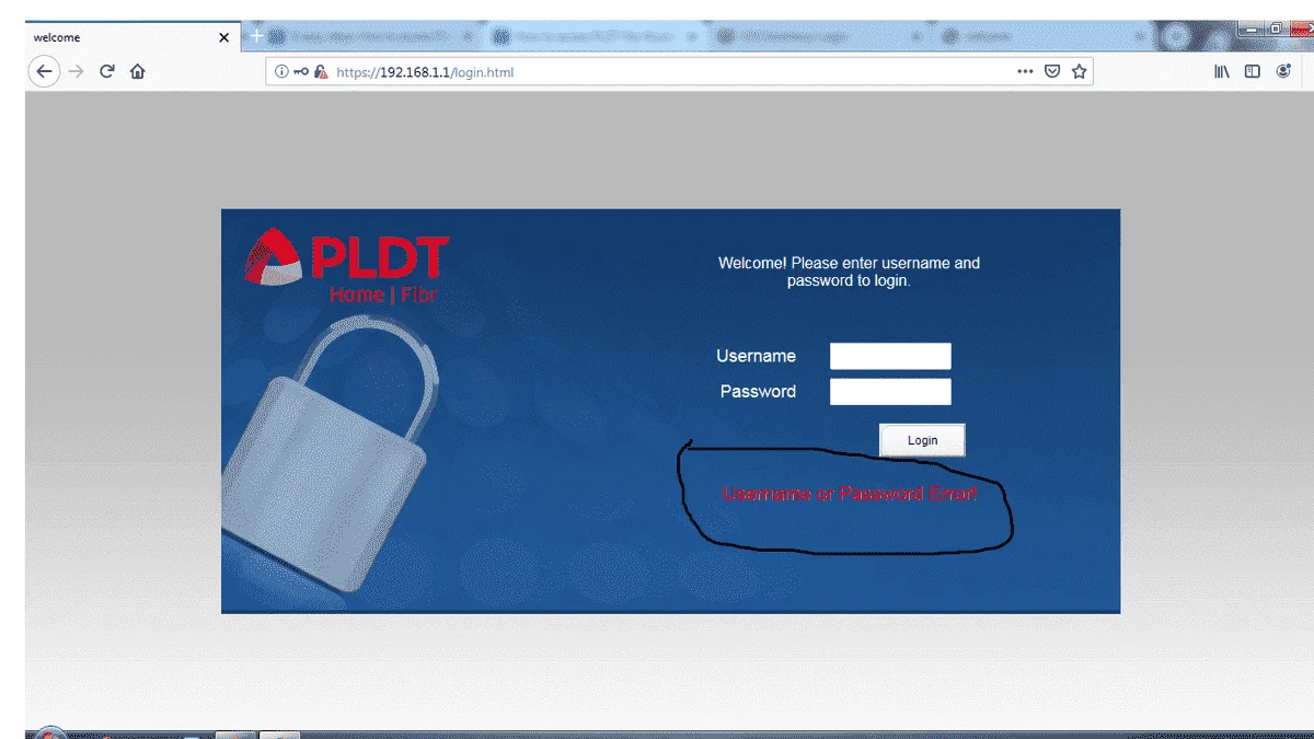

bat error mga paps?

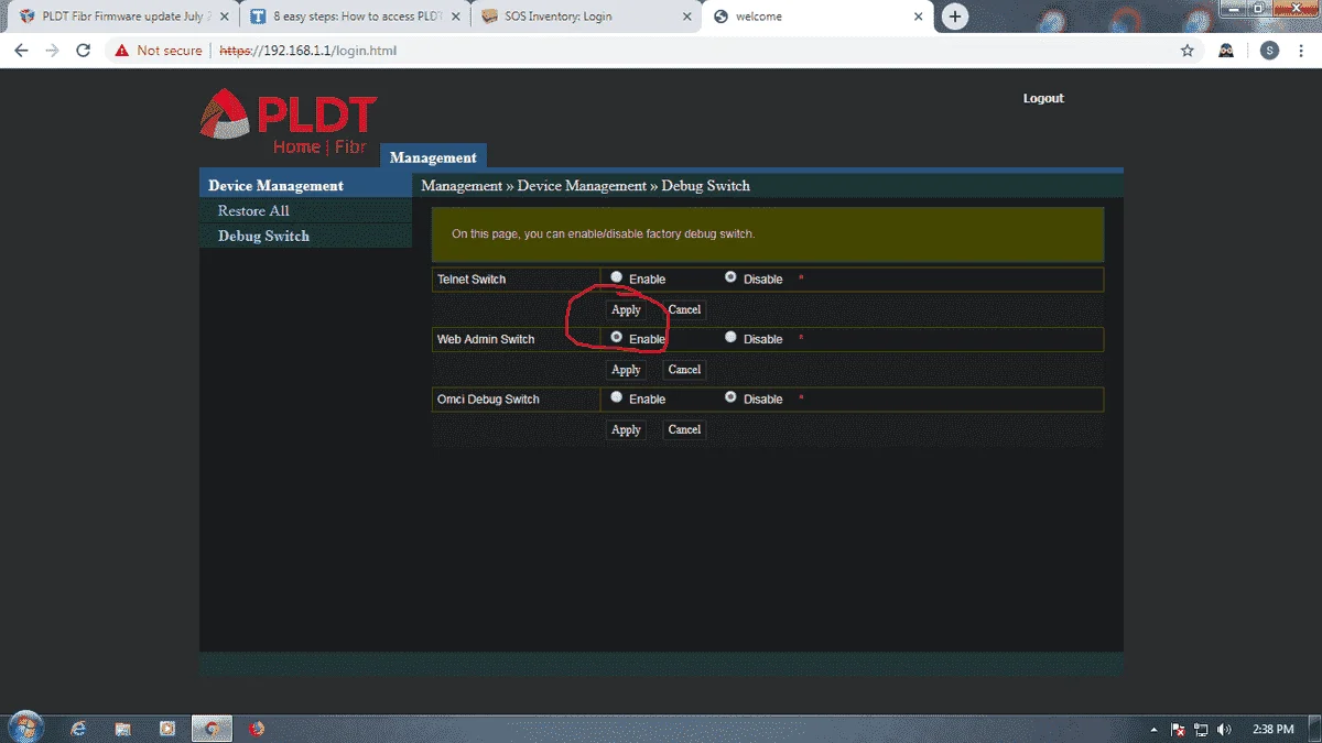

Ok clarification kung first time mo mag log in follow this
1. go to You do not have permission to view the full content of this post. Log in or register now.
2. login as fiberhomesuperadmin
3. password is sfuhgu
4. click debug switch
5. enable web admin switch
6. logout
that's done
just login in again using You do not have permission to view the full content of this post. Log in or register now.using adminpldt and 6GFJdY4aAuUKJjdtSn7dC2x as the password

Nirestore all ko muna. Then gumana yung default na binigay dito. Yung nagsstart sa z.
Kung ikaw ang may-ari ng router, there is no reason na hindi ka maka access.
May problem pag napalitan mo ung password before mag upgrade. Kasi yung sakin. Sure ako sa password na ninominate ko. Pero hindi gumana. Instead. I logged in don sa superadmin. Then clicked on restore all. Then waited around 10 mins. Tapos. Ginawa ko ulit yung web admin switch enable. Then log out. Then log in sa adminpldt. Gumana na yung adminpldt then z6dUABtl270qRxt7a2uGTiw
