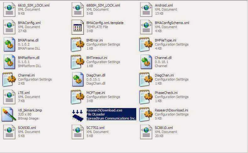

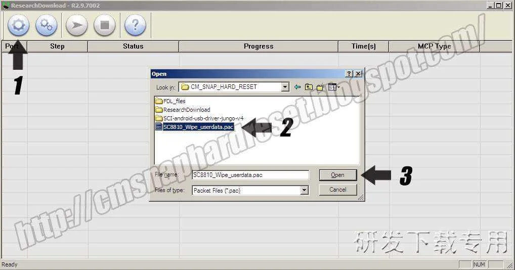

STEP 4: open ninyo yun folder na inextract nyo
Open:
(click the image to enlarge)
ResearchDownload\bin\ResearchDowload.exe
open the load pocket
sundan nyo nalang ^_^

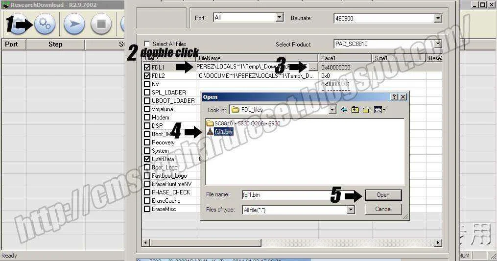

tapos open the FDL 1
Sundan nyo nalng ^_^

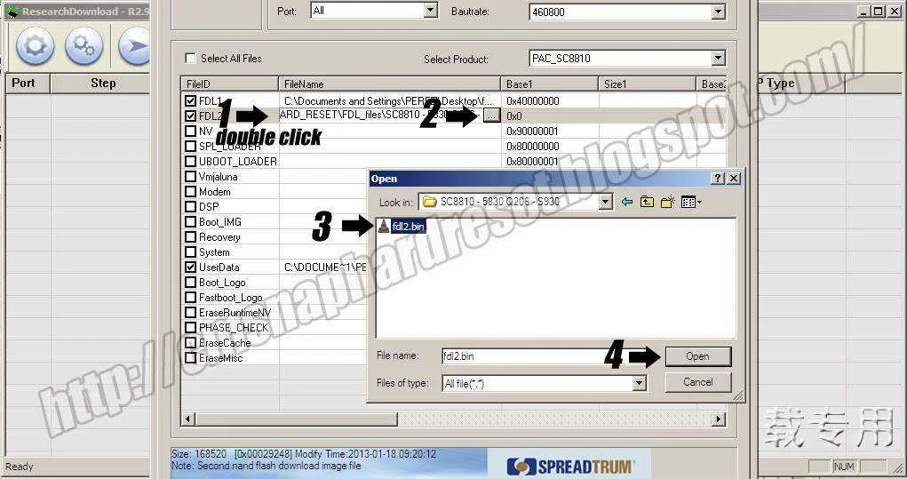

tapos FDL 2
make sure naka check lahat ng nasa picture aa ^_^
CLICK "OK"

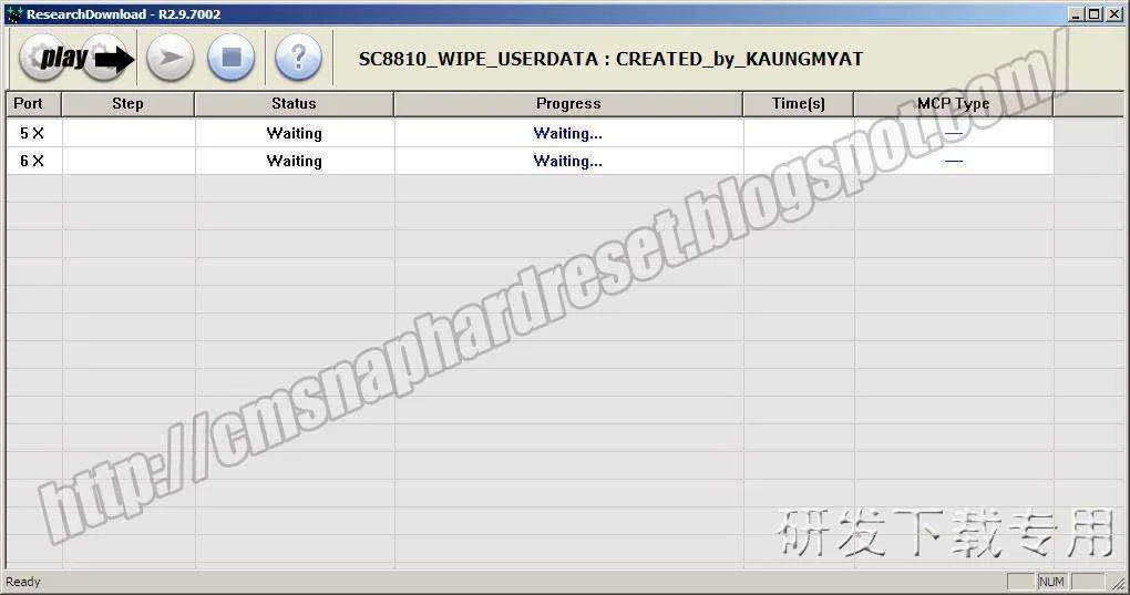

then hit
PLAY

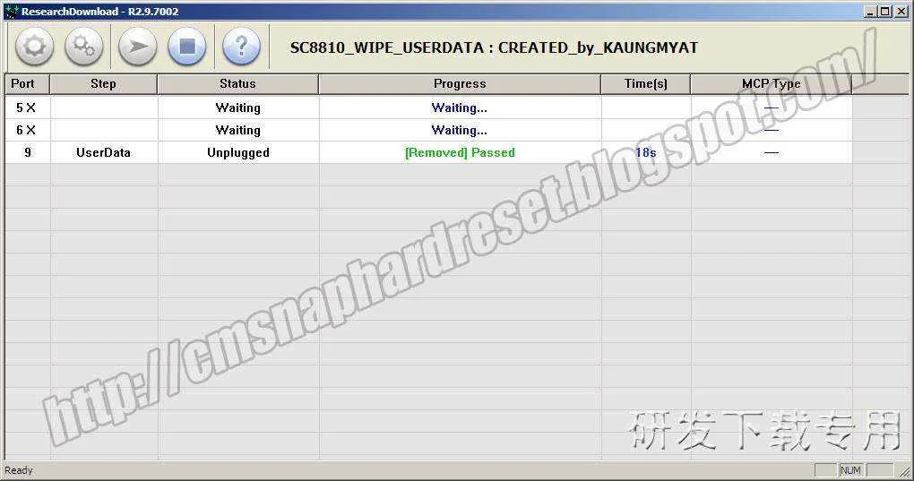

Ganito lalabas
NEXT

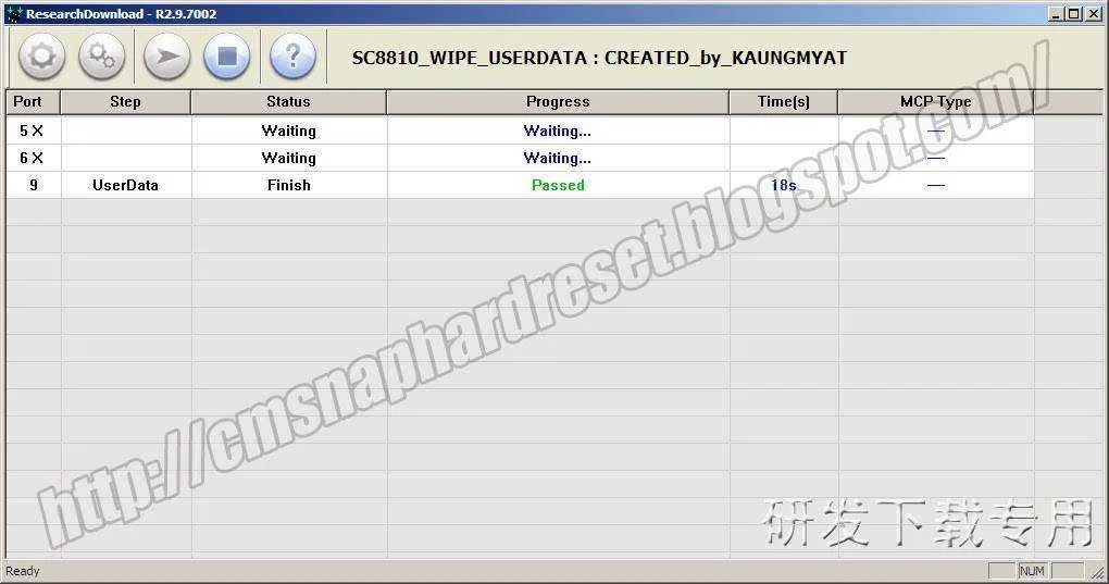

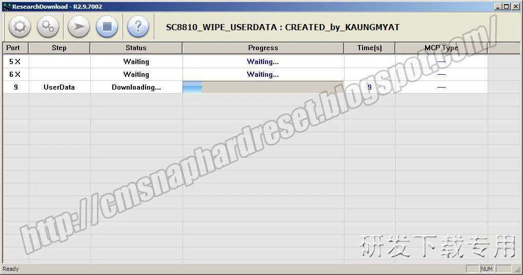

HOLD NYO YUN POWER BUTTON NG CM SNAP
while holding plug nyu ang USB CABLE
then hindi tayin nyo lumabas yun "PASSED"
Tapos pwede na ninyo i unpluged yung usb cable
then alisin nyo ang battery then balik nyo then open ok na yan RESET na ang CM SNAP NYO :)
