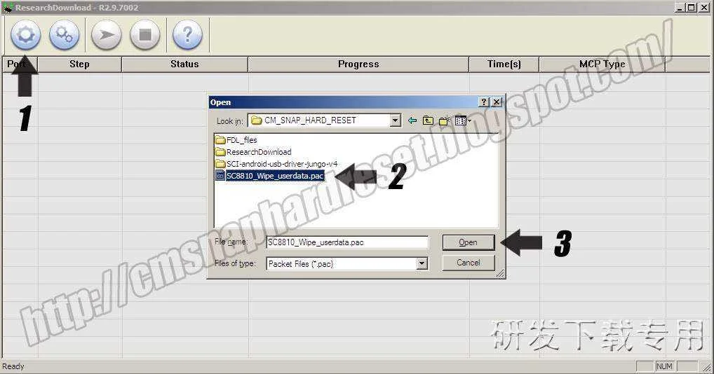

after downloading,

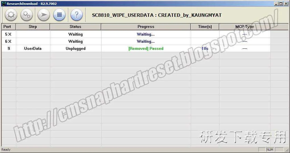

open Research Download and open the SC8810_Wipe_userdata .pac after that

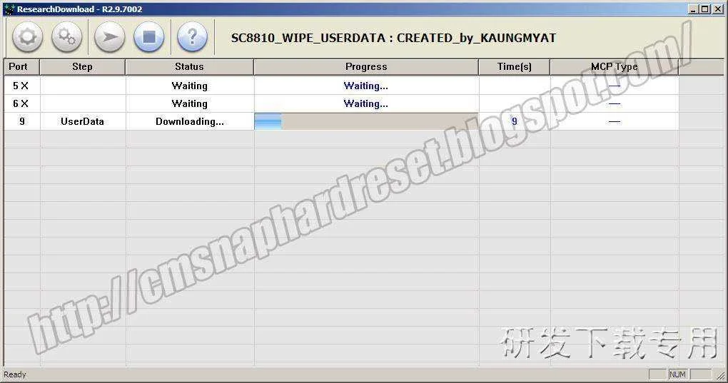

off your phone and press Volume Down or Up Button in your celphone and plug your USB port to your computer,

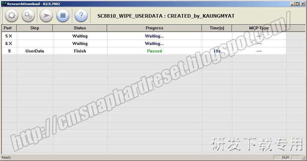

in the Research Download click the icon start downloadind after that you can see the wipe data PASSED! and now you can unplug your celphone to the computer,,and open your celphone,,
honestly, it works for me!!!!!!!!!!!!

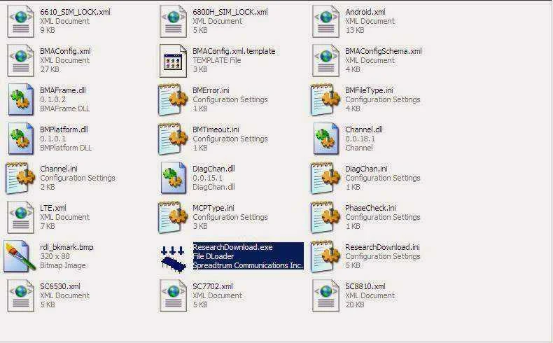

STEP 1: Extract ninyo sa desktop
STEP 2: Install the Driver
STEP 3: Turn off your cm snap unpluged the usb cable (make sure na nainstall nyo n yun driver)
STEP 4: open ninyo yun folder na inextract nyo
Open:
(click the image to enlarge)
Researchdôwnlôad\bin\ResearchDowload.exe

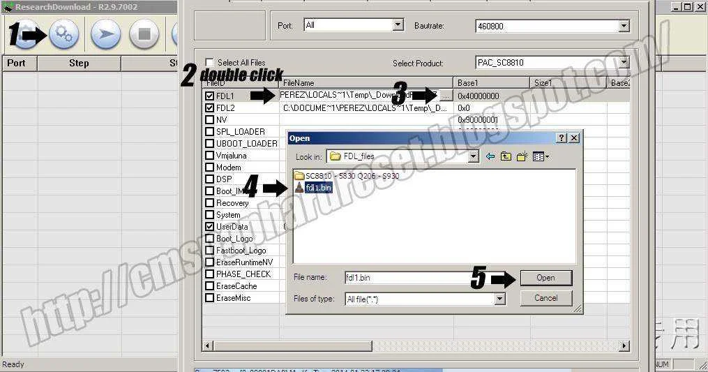

open the load pocket
sundan nyo nalang ^_^
tapos open the FDL 1
Sundan nyo nalng ^_^

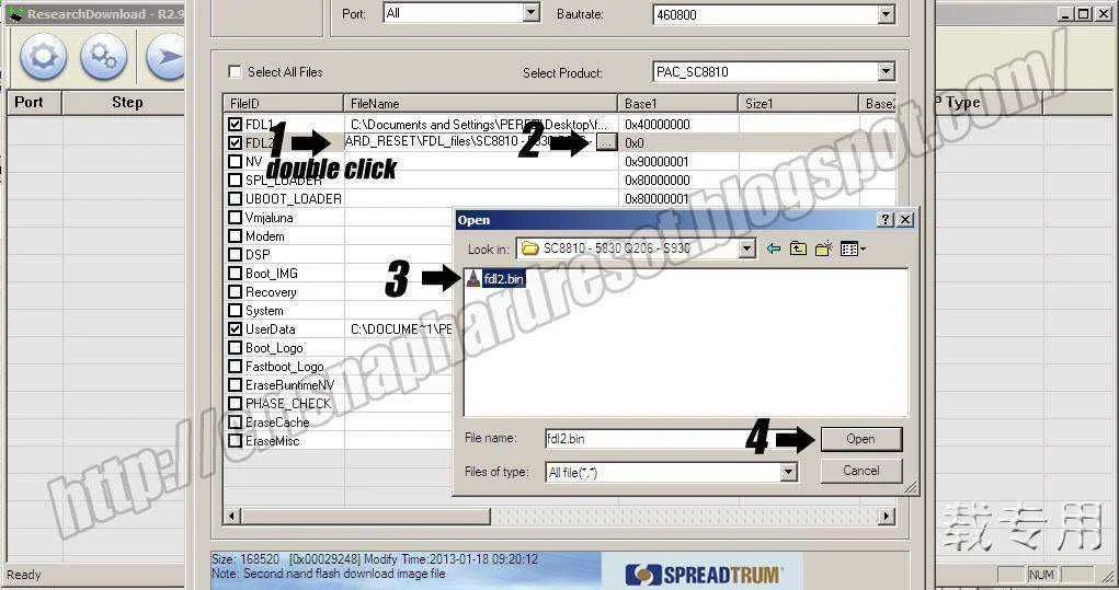

tapos FDL 2
make sure naka check lahat ng nasa picture aa ^_^
CLICK "OK"

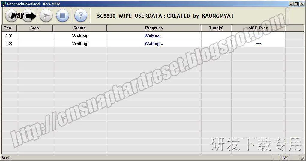

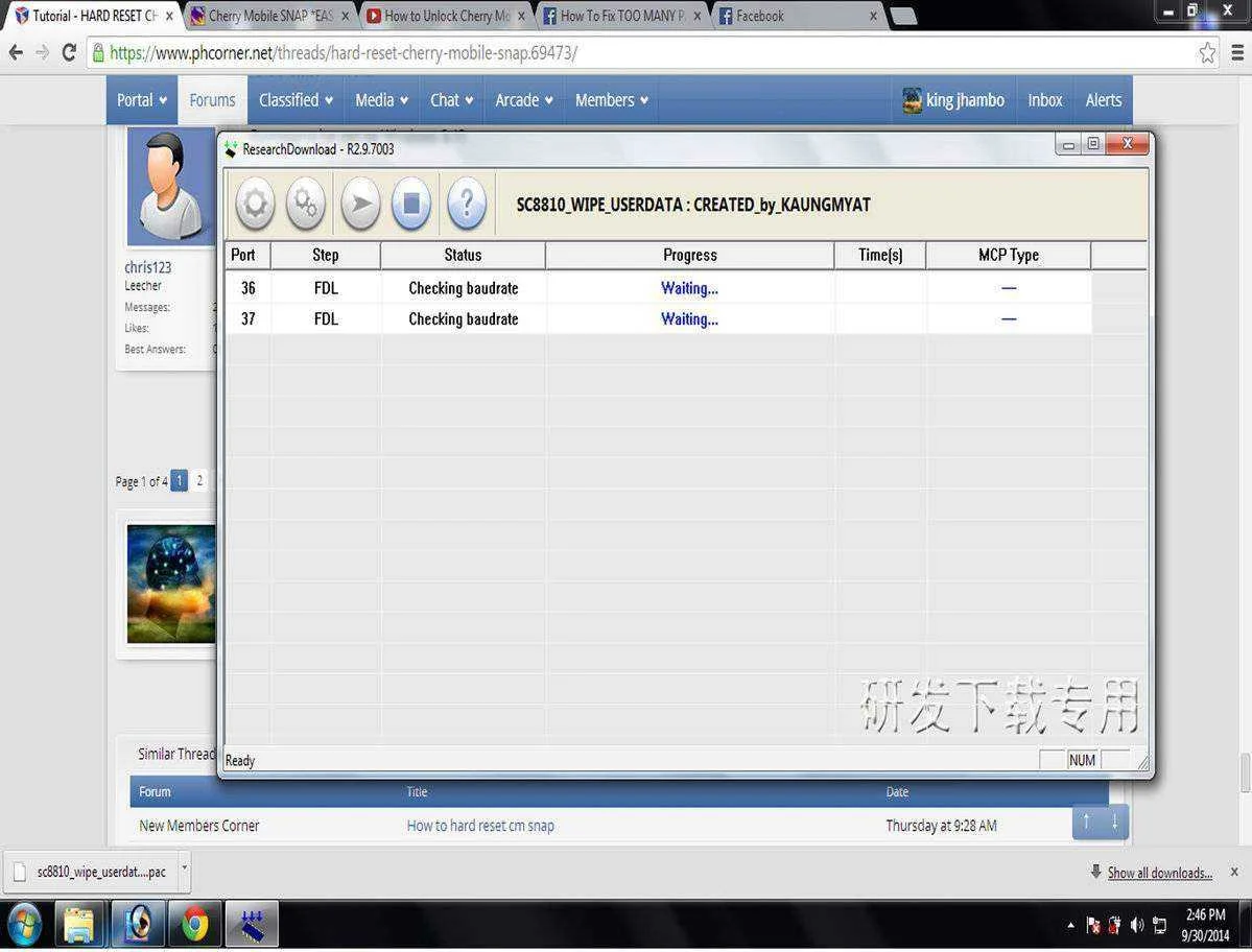

then hit
PLAY
Ganito lalabas
NEXT

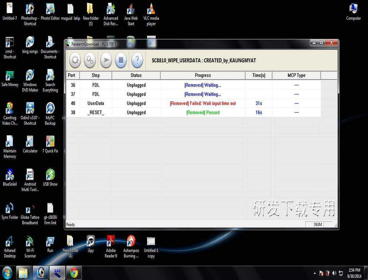

HOLD NYO YUN POWER BUTTON NG CM SNAP
while holding plug nyu ang USB CABLE
then hindi tayin nyo lumabas yun "PASSED"
Tapos pwede na ninyo i unpluged yung usb cable
then alisin nyo ang battery then balik nyo then open ok na yan RESET na ang CM SNAP NYO :)

sir bat ganun may pnpgwa din kasi dito v2 naman may driver issues ba ito sa mga pc sir? kasi nirun ko na yung researchdownload then sinunod instructions nyu after nung play wala nalabas na waiting kaya di ako makapunta sa susunod na procedure
sir bat ganun may pnpgwa din kasi dito v2 naman may driver issues ba ito sa mga pc sir? kasi nirun ko na yung researchdôwnlôad then sinunod instructions nyu after nung play wala nalabas na waiting kaya di ako makapunta sa susunod na procedure
