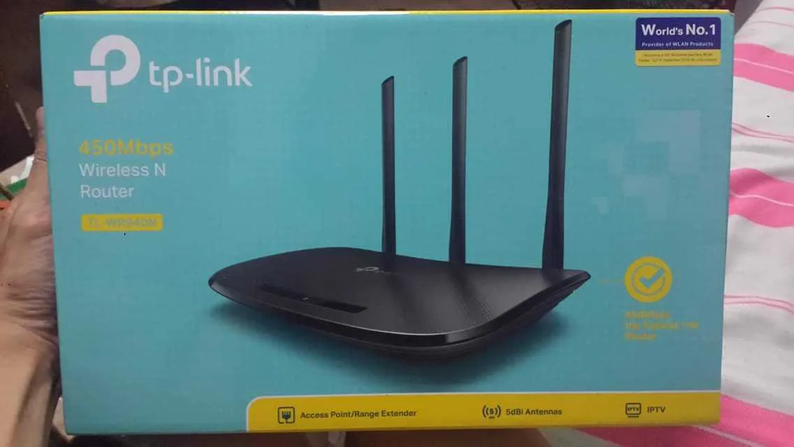

to all TP TL-WR940n eto na pag kakataon hinahanap nyo
walang basagan ng trip
trip ko mag share maski diko napagana
( hehe ang gulo 🤣😂😅 )
install OPENWRT to tour TP-WR940n
flashing firmware to your TL-WR940n OPENWRT
go to 192.168.0.1
search update firmware then chose ( first_openwrt-18.06.1-ar71xx-tiny-tl-wr940n-v6-squashfs-factory-eu )
click update
wait until restart it self
after that finish
go now to 192.168.1.1
user: root
pass: root
then system tab see firmware upgrade / restore
drag down to firmware sysupgarde apply ( tl-wr940n-v6-squashfs-sysupgrade )
then proceed now
and thats it FINISH
over all diko na alam i set ovpn .
kasi nung ma set ko config ..
parang me kulang ,, diko sure need i apply yung CA certificate ng vpn
SHARE nyo nalang sakin kung panu paganahin iyun hehe
___
Nakupo nasira hindi maka log in sa WEB INTERFACE
unbrick trick
TP TL-WR940N unbricked trick
power on router
set ipv4 192.168.0.6
255.255.255.0
save
run admin TFTP
Current directory of your file ( wr940nv6_tp_recovery )
server interface chose 192.168.0.66
off router / then hold reset then on router ,, wait until TFTP respond to fash
it will restart it self
then back to tcp/ip4 ,, choose obtain an ip ,, save
then there you Go ,, your TPlink tl-wr940 is back
Credit : Ronnie Valdez
