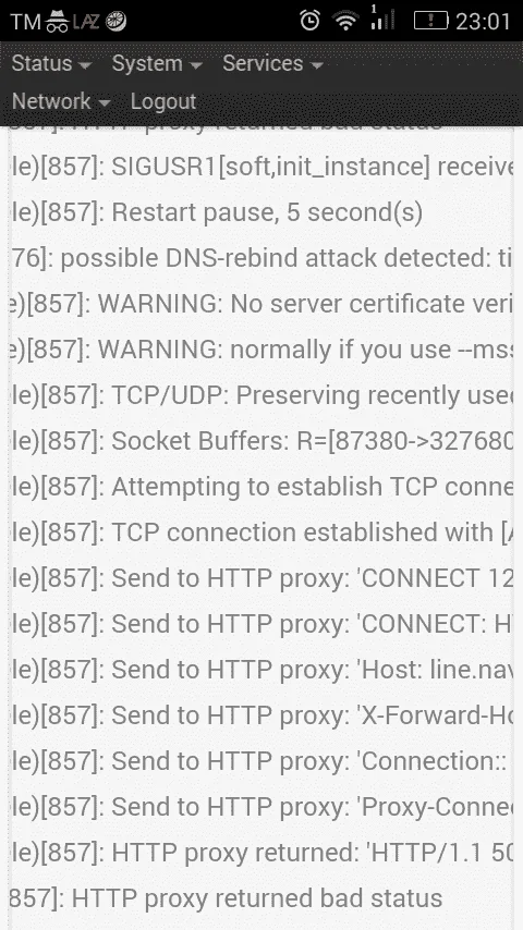

Info lang sir. Mali ka po. Sensya na. Ano pala.gamit mong router? Model at version?
sure ka? alam mo ba kung gaano kalaki filesize ng openvpn app at ng mga dependencies nito?
sa 4mb router kaya ko mag-install ng vpn (pptp/l2tp) on flash storage pwede yun pero yung mismong openvpn i doubt it. please correct me if im wrong. i just want to be clear that we are talking on 4mb flash routers here para malinaw.
im using mr3420 v2, may usb port to.
naka -extroot ako. i can install any package i want kasi yung usb disk ko ay nag-aact as expandable flash storage

4mb/64mb. Yes sir may openvpn.
i dont know how do you manage to squeze this 4mb flash storage to have openvpn installed in it. sa official firmware ng iba kong router like wr741nd 300-500kb na lang free space on newly fresh installed firmware. i will do further research on it perhaps i can use your method to installed permanently openvpn on flash storage.
may usb port ba yang router mo? di ka gumamit ng extroot dyan?
