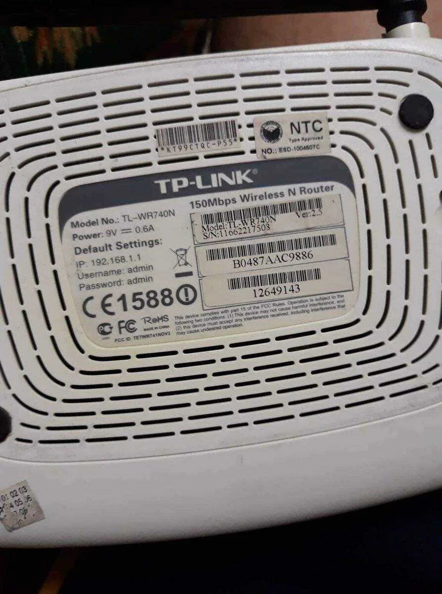

upon checking on openwrt page, i found out there is no specific firmware openwrt 18.06.1 for your router. we need to install openwrt latest version so that we can also install Openvpn v2.4. Openvpn 2.4 is needed so that you can use any ovpn file that has custom header to bypass/access free net on certain network like SunTu etc. i only found 741nd v2 firmware. openwrt page says that 740N and 741ND are almost identical on specs.
Reference here : You do not have permission to view the full content of this post. Log in or register now.
if you are a risk taker, flash this wr741ND v1 firmware to your 740N v2.5.
if this 741nd v1 works/flash with no problem on your router then i will build you a cfw. you have the possibility of having a brick router if it is not compatible. some brick router can be revive only using serial port flashing.
You've been warned!!! DO IT ON YOUR OWN RISK!!!

Sir pano malalaman kapag hindi nag flash ng maayos?
router automatically reboot after flashing firmware. if you still open 192.168.1.1. on your web browser (openwrt web gui) then it flashing procedure is a success. otherwise when your router dont boot/stuck on bootup, cant connect on your router via wifi or lan. then you have a semi brick router
