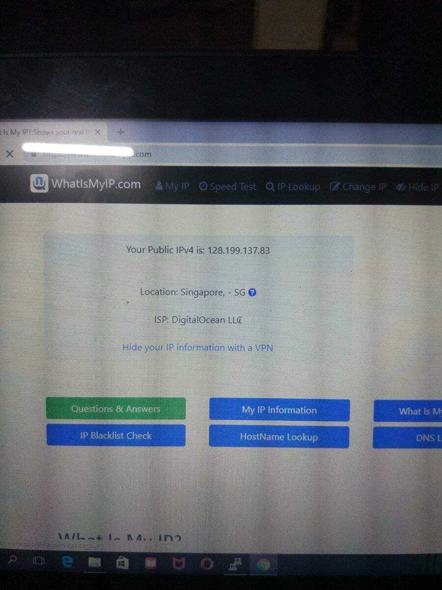

ALRIGHT! Successful yung first firmware na binuild ko sa ASUS Router! Tapang mo pre talagang tinake mo yung risk. :-) You're welcome. CHEERS
the ovpn files of 3 default monthlyssh server is stored at /root/ basta may isa pang folder na may name na default_openvpn_server yata yun. inside that folder there are 3 files named 1.ovpn (for sg server1) 2.ovpn (server 2) and 3.ovpn (server3). you can edit or modify these files to any ovpn settings that you want to connect.
the ovpn files of 3 default monthlyssh server is stored at /root/ basta may isa pang folder na may name na default_openvpn_server. inside that folder there are 3 files named 1.ovpn (for sg server1) 2.ovpn (server 2) and 3.ovpn (server3). you can edit or modify these files to any ovpn settings that you want to connect.

Ito solusyon ko sa partial wifi working ng device ko
Last na boss last na talga po ito sinubukan ko po ung auto connect na select ko na din ung server na gusto ko pero pag nag rereboot ako ayaw pumasok

aling server yung sinet mo for auto conect, server 1 2 or 3 ba? kung for example sinet mo yung server 1 (monthlyssh sg1 server) dapat may naka-set ka na rin na account username at password na para sa server na yun kasi kung mag-eeror siya AUTH_FAILED kung wala nilagay na user account! user account for server 1 2 and 3 are stored too at default_openvpn_server folder ( 1.txt 2.txt 3.txt respectively)
check mo pre system log, tingnan mo kung nag-try bang kumonek yung openvpn client upon restart/reboot.
autoconnect is just for default monthlyssh sg 1 2 & 3 server. if you want to autoconnect sa custom server settings na gustong mong ilagay. you just need to modify the default ovpn files na nilagay ko sa may /root folder
if everything is set properly, autoconnect start after 2mins after reboot. YES 2minutes po nilagay ko sa script na waiting time to start openvpn connection. You just need to wait 2minutes for openvpn client to autoconnect, you can check any running background processes running on your router by typing

Yes po kasi ung wifi ng router ko pag nag openwrt super hina . sakop lang buonh router kaya bumili ako ng mi wifi repeater para sya ung magiging wifi nung router heheh. Oks na boss na gawa ko na po maraming salamat ulit dito . na try ko na din sa modem pasok ung mga custom header .
