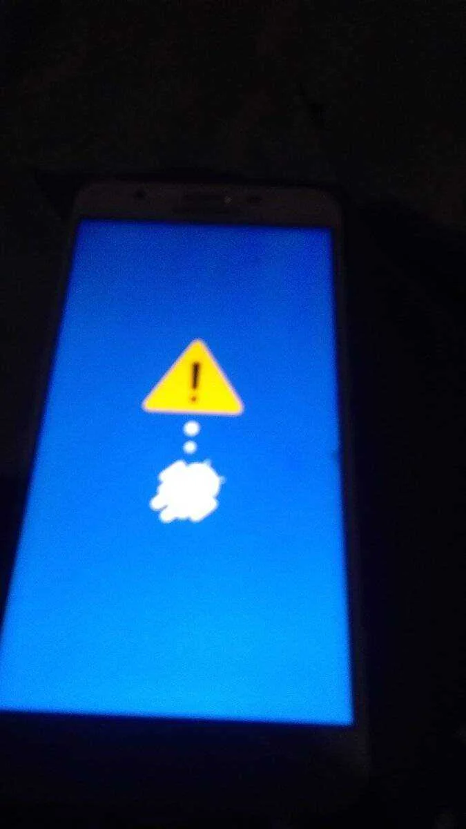

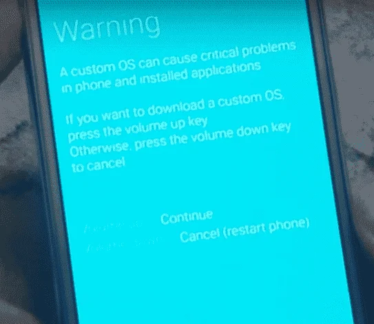

  5. Then Press and hold the Power + Volume Down + Home button simultaneously until its screen off and boot into a blue screen showing WarningScreenshot-31.webp

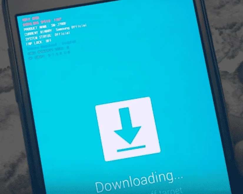

  6. Now press Volume UP button to Continue…It will show like thisScreenshot-34.webp

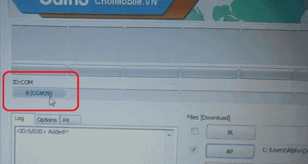

  7. Now connect your Phone to PC via USB Cable
  8. You will see that first box under ID:COM in odin is shaded mean driver properly installedScreenshot-35.webp

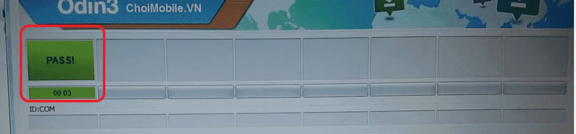

  9. Now click on the Start button on Odin
  10. It will few seconds, once its done, you will see green Pass like thisScreenshot-38.webp

  13. Again Press and hold the Power + Volume Down + Home button simultaneously until its screen off and boot into a blue screen showing Warning
  14. Now press Volume UP button to Continue…It will show like thisScreenshot-34.webp

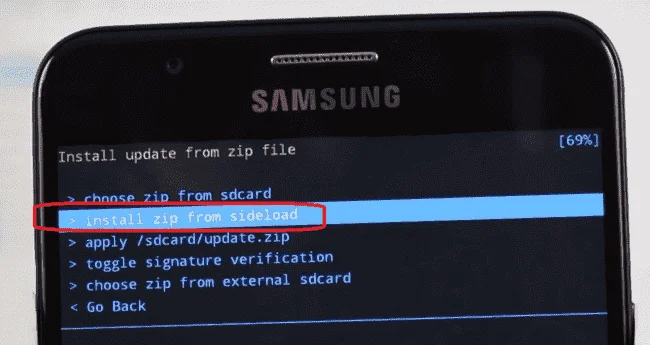

  23. Move down to “Install zip update package” and then to “Install zip from sideload“.Screenshot-71-e1484191339506.webp
