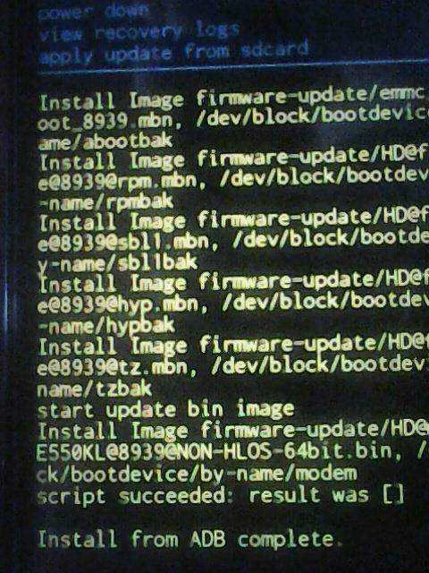

11. Simply wait as it complete the installation and you should see the progress from 0%-100%
sample on adb sideload progress only to give you an idea:
Install from ADB complete
Congrats!

Sample update firmware installed via adb sideload (complete)
