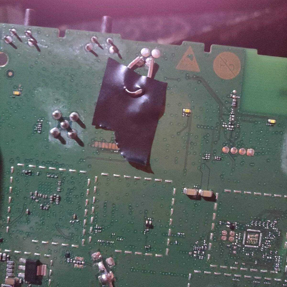

Kanina ko packinakalikot..
Napansin ko..na dedetect ng PDANET si modem pag hindi sya naka Jumper..
Pero pag naka jumper sya hindi sya madetect
dpat naka jumper yan, no power led dpat pag ka jumper tas connected sa device manager yung modem. tas nvrameraser then balong na tas flash firmware
