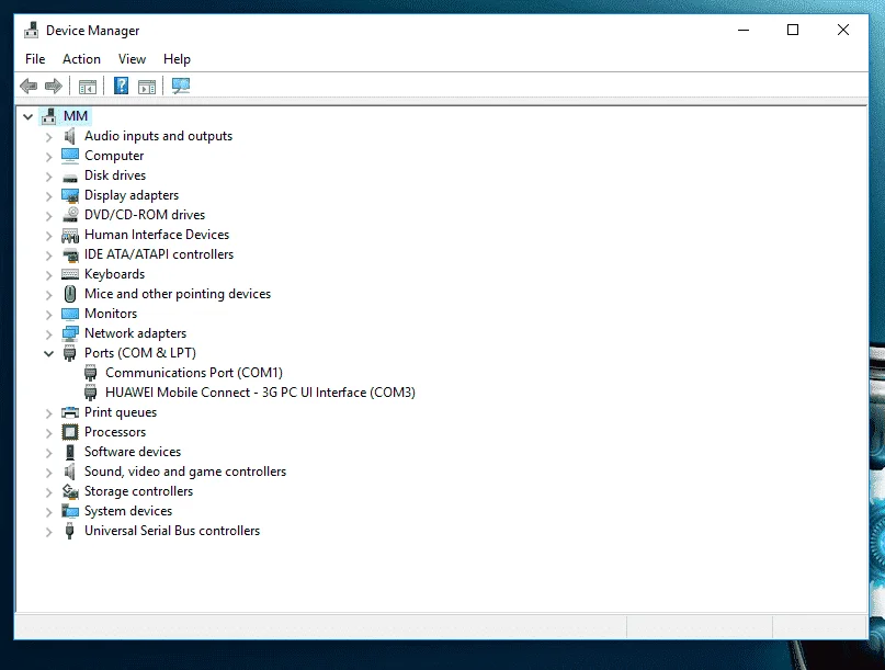

dpat detected ni pdanet app yung modem mo, at palaging checked mo dpat device manager na dpat nandun c Huawei PC GUI modem (Port #)
nasa device manager sya boss..yung pdanet not connected palagi..win 10 1803 gamit ko

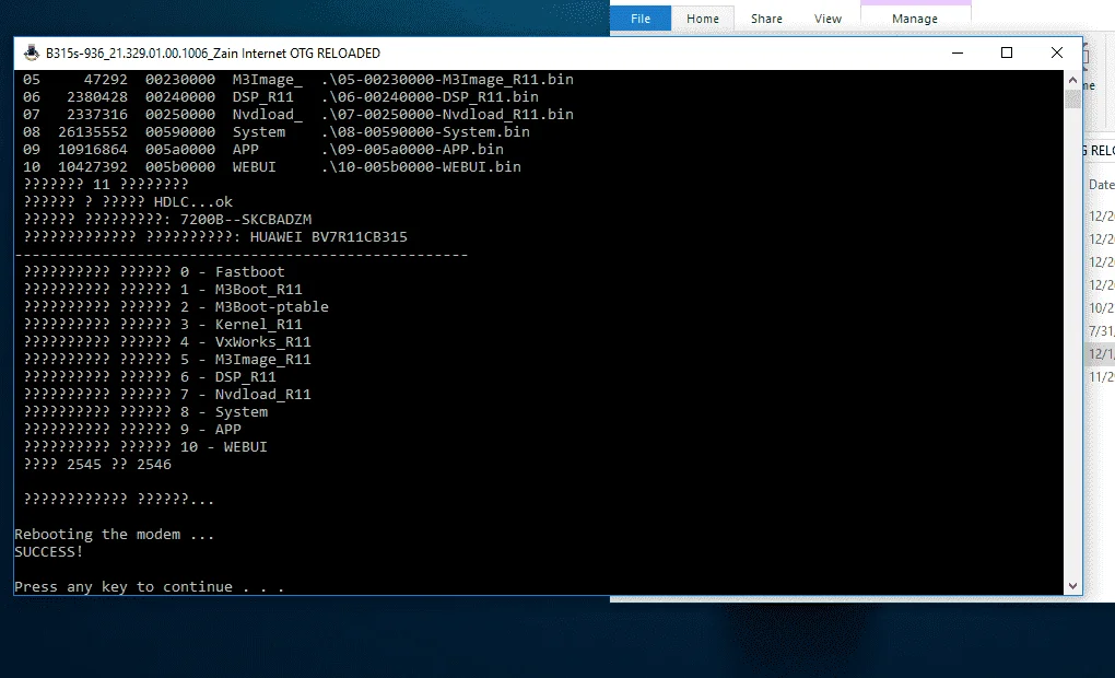

na try ko nman sya ma upgrade fw problema lang walang stable..minuto lang tinatagal patay sindi na ulit ilaw..power led lang naka steady.

1803 din win 10 ko, install mo rin yung registry file ni boss watch tower. Back read mo lng, mahahanap mo yun. Dpat detected ni pda.net app at naka open dpat c pda.net tas all drivers installed including the Registry fix
di ko napakonekt si pdanet pero naipapasok ko pa rin palagi yung fw..di ko alam kung pang ilang beses na at success nman..kaya lang nagpapatay sindi pa rin mga led lights tipong connect disconnect..poweled lang naka steady
Ibang driver gamit ko dyan bro bago ko nirun mga loader
naload mo ba sir ng ayos yung firmware??

mawawala yung huawei mobile connect sa device manager..
at lalabas yung android adb interface error sa device manager na ini update ko nman ng online at manual..

pag connected c modem kay pdanet app. sure na madedetect yan ni nvrameraser. D ko rin noon mapagana c nvrameraser at nag skip na lng ako, diretso flash firmware, ok nman, pero mas ok pa rin yung malinis ang system bago mag flash ng new firmware. Ngayun ko lng napagana c nvrameraser dahil sa new drivers ni boss jhowel including na din c pdanet app
natry ko na rin maraming beses skip si eraser..usb loader agad,success..firmware success ulit..kayalang ayaw pa rin mag stable na parang rereset sya maya't maya..magcoconect ng ilang minuto magbblink magcoconect ulit.,baka sira na tlga modem.

Ok na stable na sya umpisa knina hapon skip nvram eraser pa rin + flash fw paulit ulit,sana magtuloy tuloy..salamat mga brader.
