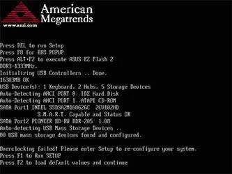

1 | BIOS Error - Failed to Overclock
The Failed to Overclock error screen shows up whenever your BIOS settings have been cleared, and usually has nothing to do with actually overclocking your system, unless you just tried to overclock your system. Some common occurrences which cause this error to arise are:
  • Your system has been physically moved
  • Your CMOS battery is failing
  • Your system is having power issues
  • Overclocking your RAM or CPU (we do not overclock our parts)
  • Adding a new device which is defective
We do not recommend overclocking any part in your Quiet PC. Overclocking the RAM or CPU is not something we support, because you are basically telling your PC to send more power to the CPU or RAM than the component was designed for in order to increase speed and performance. Overclocking diminishes the life expectancy of your PC, and can damage PC components (when done incorrectly). When using a silent PC, generally speaking, you are already dealing with higher temperatures than you would with a standard build. Overclocking exponentially increases those heat levels in your PC, putting more wear and tear on your components.

How To Restore BIOS to Factory (SilentPC.com) Settings
If your BIOS settings have been reset, or if you’ve attempted to overclock your PC and your PC failed, you may need to set the BIOS back to its optimized default settings. Setting your BIOS back to orginal settings is also referred to as restoring your BIOS settings. SilentPC.com (Cool Tech PC) saves all of our BIOS settings under the BIOS profiles tab, which most modern motherboards support. Simply load any of the pre-saved profiles under the profiles tab (unless you have altered one of those profiles) to reset everything back to the way it was when we sent the PC out.
Load BIOS defaults
Below is a quick guide on how to load your bios profiles:
  • Login into the BIOS by hitting the Delete or F2 key (depending on your motherboard) during your computer's boot process (when you see the BIOS screen pop up).
  • Navigate to the Tools Tab.
  • You should see an item called Profile. Simply use one of the profiles to load the settings your machine initially had when you first received it.
  • Hit the F10 key or select the "Save and Reset" option. Your Bios Settings should now revert back to how it was originally setup by us.

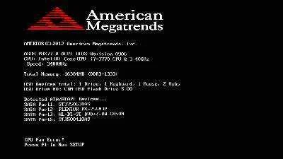

3 | BIOS Error - CPU Fan Error
Many customers run into an error that tells them that the CPU fan has an error. This is usually just because our silent fans spin slower than normal fans. We’ve designed our machines to be as quiet as possible, and some of our designs have no moving parts in them at all.
This error most often occurs when the settings in the BIOS have been reset, often due to an improper shut down or a power outage. By default we disable the CPU fan speed sensors because the motherboard will think that the fans are dying (even though we are just using slower fans than a standard build). We recommend checking in the BIOS under the Hardware Monitor section to verify that the CPU fan is actually spinning if you receive this error. Yet, we still recommend turning the fan sensor off in the BIOS because all of our quiet CPU coolers.
Because there are so many different types of BIOS versions, we cannot provide step-by-step instructions on how to do this. Almost all of the fan settings in the BIOS are going to be located in the hardware/monitor section of the BIOS. Please consult your motherboard manual for detailed instructions on how to navigate your BIOS. If you have purchased your PC from us, and are not sure how to proceed when you receive this error, please contact us at support@silentpc.com, so we can further assist you.
BIOS Solutions | CPU Fan Error Solution
Seeing this CPU Fan Error should prompt you to push the F1 key which in turn will load the BIOS screen. You should make sure that all of the fans sensors are turned off in the hardware monitor section by manually turning the fan speed sensors off. The easiest way to reset everything is to load from one of the profiles which we’ve preset in the BIOS. This should set everything back to where we originally had it. Please note: this feature is only available on motherboards that support UEFI, and that you should still consult a technician if the problem persists or if you need help.

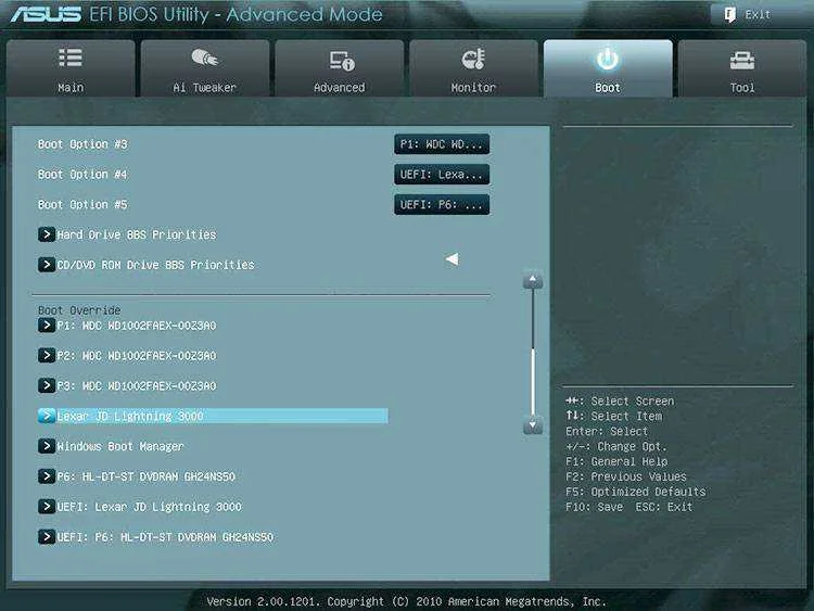

4 | BIOS Error - Boot Device Error
A Boot Device Error is a common occurrence among modern motherboards (which support UEFI). The DVD drive or hard drive may be set to boot as a UEFI (Unified Extensible Firmware Interface) and may not always work. UEFI utilizes the GPT partition scheme (globally unique identifiers partition table), and is far superior to that of the older MBR (master boot record). UEFI is almost always the default on modern motherboards, but this setting has been known to change when new devices are connected to the PC. Bottom line: booting off a DVD or hard drive may not always work when set to UEFI, and it is suggested to make sure that the primary boot device is either the DVD or hard drive, and not the UEFI DVD variant if you are having issues.
BIOS Solutions | Boot Device Error Solution
There are quite a few more options in the boot menu of a modern motherboard, than that of an old generation motherboard. Scrolling down on the boot page will list the primary DVD and hard drive boot options. Scrolling down even further will list the DVD boot options and the hard drive boot options. Simply select the DVD boot option, if you’re trying to boot off of the DVD drive, and make sure that UEFI is not at the top of the list. The same setting should be applied to the hard drive boot options. Once these setting are saved, you should be able to boot off of the DVD drive or hard drive, with no issues. You can almost always use the Quick Boot option (Typically the F8 key) which will allow you to quickly choose which device you would like to boot off of.
  • Login into the BIOS by hitting the Delete key or F2 key (depending on your motherboard).
  • Hit the F7 key to access the advanced view mode, if applicable.
  • Navigate to the boot menu and scroll down until you see the boot options, as well as the primary hard drive and DVD drive options
  • Make sure that the primary boot options are not the UEFI variants, as they will list twice
  • Hit the F10 key or select the save and reset optio
