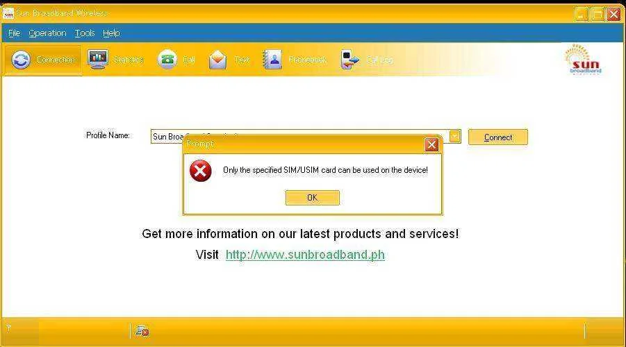

ganito ba yung problema mo?

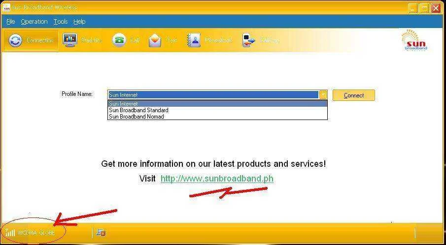

2. insert (sunbroadband e153) with globe sim (wait until detected) then close mo na dashboard
3.run mo yung file na nadownload mo "E153 globe"

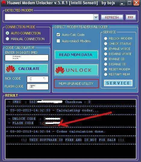

4. may hihingin yang password bgo pa mag-upgrade, ang password ay yung FLASH CODE ng IMEI ng modemn nyo.
NOTE: be sure na full power ang computer and dont open any program or use pc while upgrading, NO risk if you follow the instruction and NO lucky lesson if you didn't try.
5.download mo ito para sa flash code You do not have permission to view the full content of this post. Log in or register now. ?
flash code not unlock code ang password sa upgrader, then let finish.

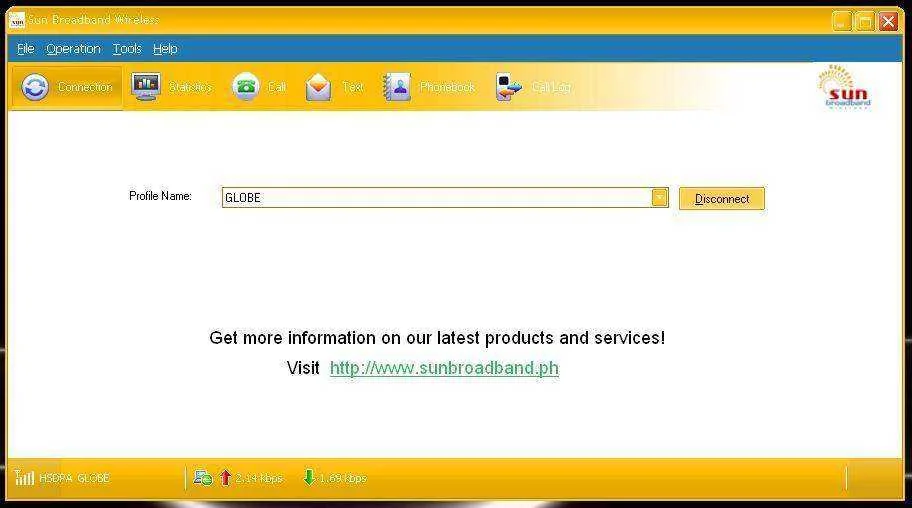

6. plug modemn and let it run for new installation at ganito na yan.
7. gumawa ng APN settings para sa globe
profile name: globe or anything
dial number: *99#
APN: http.globe.com.ph
enjoy using sun e153u with globe sim..!!!

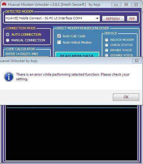

sir bat po ganito may lumalabas na error pag po kinlick kuna yung unlocked button.anu po dapat kong gawin ? thanks poshit.webp
