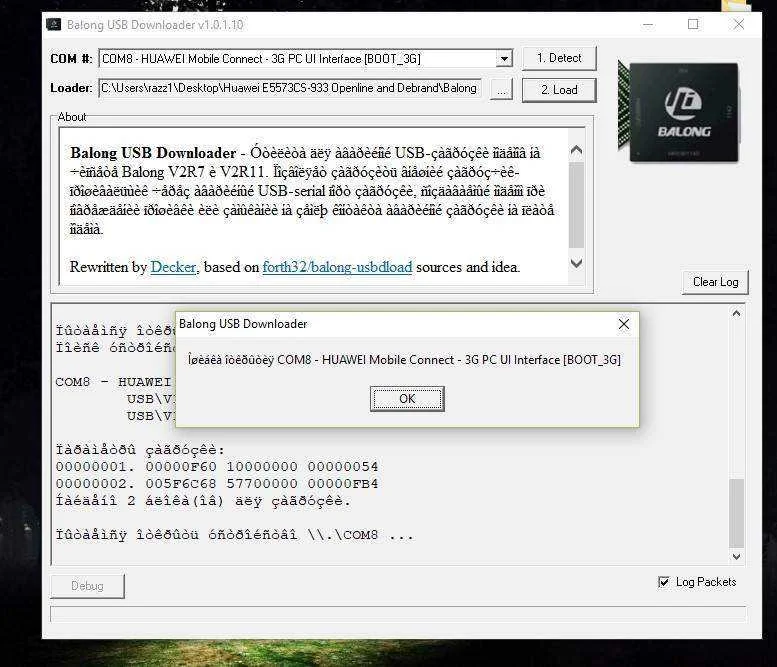

👨‍🏫 Tutorial How to openline (unlock) and debrand huawei e5573cs-933 (globe)
Hindi mo nagawa ng tama. Ishort mo mabuti para lumabas yun sir.
Lumipat ako ng ibang pc sir. another problem is, stuck ako sa last part! Nag eerror. tama nman lahat ng steps ko. :(
Sorry for the double post. After third fails. inassemble ko nlng ulit ung device. nakikita ko nman sa wifi ang HUAWEI-4050 (default:HUAWEI-6FF5). kaso di ko alam ang password. :):)
EDIT: Replugged device to another pc, merong nadetect na device sa This PC (My Computer). Ran the Autorun file at nag pop-up na ang home page. Now stuck sa Modify Password, ano default password nito?
19. Run HxD and type out the serial number on the right side.
20. Now type in this command: AT^NVWR=6,16,** ** ** ** ** ** ** ** ** ** ** ** ** ** ** **
Replace ** with the hex code you got from HxD (copy paste the values in the middle (between the zeros and the serial number you just typed. Press enter. It should say OK.
21. Now type in this command: AT^CIMEI="*****". For example if your imei is 1234567890123456, then you would type: AT^CIMEI="123456789123456"
Replace * with your IMEI. Press enter. It should say O Nahirapan ako d2 wala ba? video tutorial

Make sure sa Step 21. isali mo ang quotation marks in between the IMEI.
