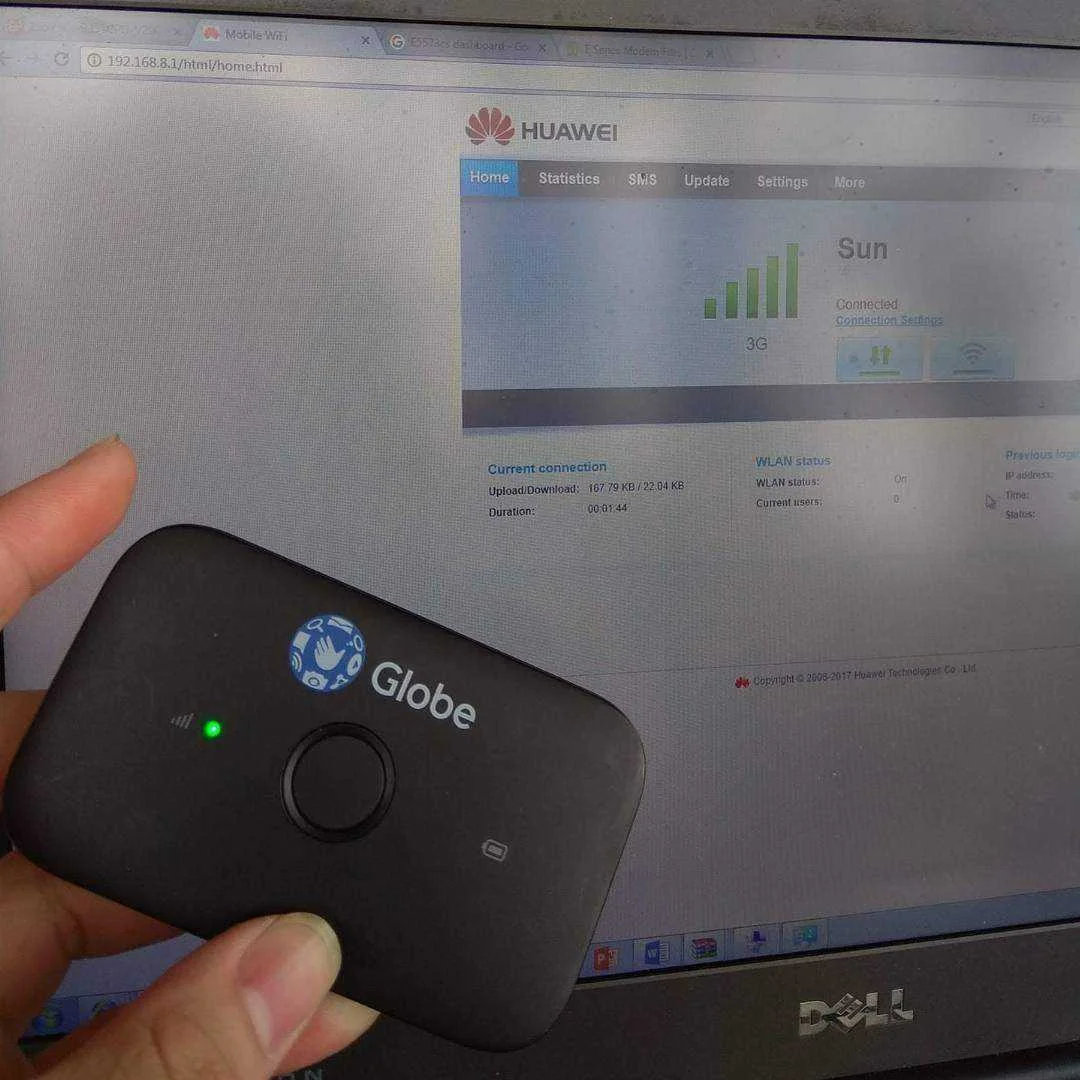

I finally unlocked my Huawei E5773CS-933 modem from Globe.

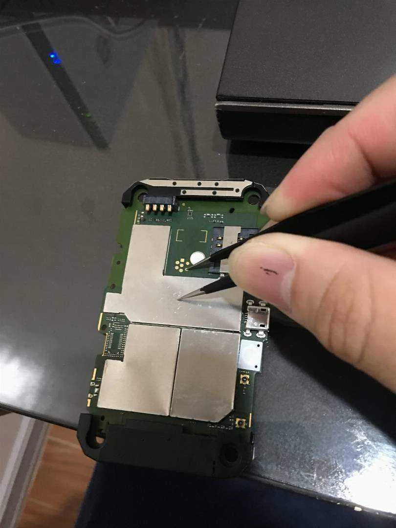

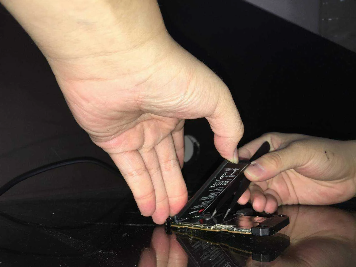

3. Take out the board and flip it over.
4. Connect the board to the computer, and open Device Manager
5. Grab tweezers or similar device that's conductive. Then short out one of the pin/metal part (shown in the pic) near the SIM card slot.
6. While keeping the pin/metal part shorted out. Go ahead and put the battery approximately 45-degree angle while keeping it in contacct witn the gold terminals. As shown in the pic.

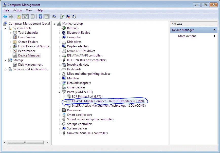

7. If you did it right. You should see "HUAWEI Mobile Connect - 3G PC UI Interface", "FC - PC UI Interface" or something similar under Ports (COM & LPT) on Device Manager. You don't need the tweezers anymore but leave the battery alone.
If you're getting a message saying that the last USB device you have inserted can't be recognized, then try connecting using a different cable, port, or even a different computer.

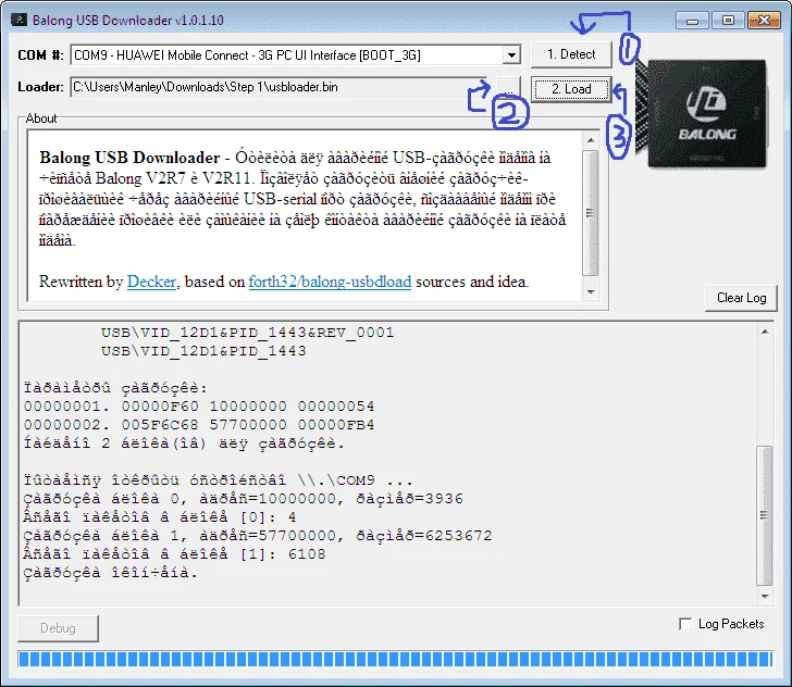

8. Launch Balong USB Loader at "Balong USB Downloader" directory.
9. Click "Detect". Then Press the three dots. Then "Load"
10. It should take about 5-20 seconds for USB Downloader to do its thing. It's normal for the program to freeze, however, when its done. It should return with a full progress bar.

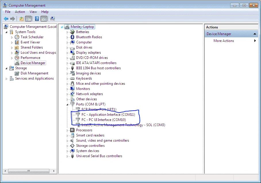

11. Check Device Manager and if you see both "FC - Application Interface" and "FC - PC UI Interface" or something similar, proceed to the next step.

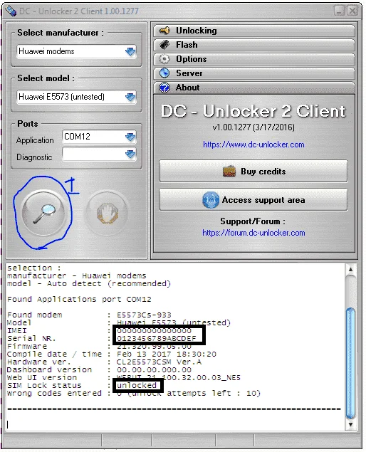

16. Connect the modem to the computer. Then run "dc-unlocker2client_1277.exe" at the "DC Unlocker" directory.
17. Click on the magnifying glass/search.
18. When the modem is found, you'll see that it's already unlocked but we can't use it yet due to not having the correct serial and IMEI.

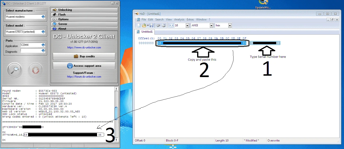

19. Run HxD and type out the serial number on the right side.
20. Now type in this command: AT^NVWR=6,16,** ** ** ** ** ** ** ** ** ** ** ** ** ** ** **
Replace ** with the hex code you got from HxD (copy paste the values in the middle (between the zeros and the serial number you just typed. Press enter. It should say OK.
21. Now type in this command: AT^CIMEI="*****". For example if your imei is 1234567890123456, then you would type: AT^CIMEI="123456789123456"
Replace * with your IMEI. Press enter. It should say OK.
22. Click on the magnifying glass (again) and see if the correct serial number and IMEI shows up. Once done, close out of DC Unlocker.

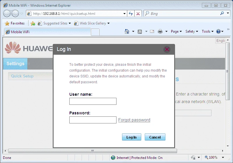

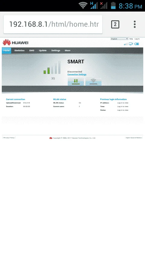

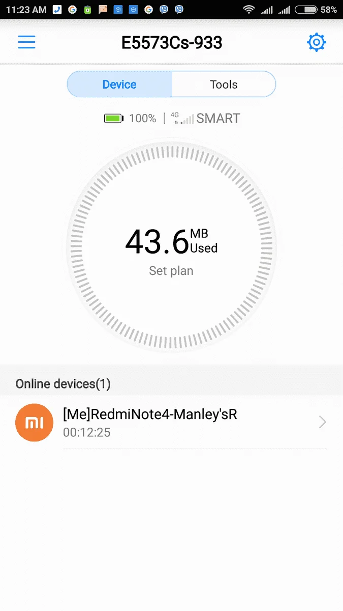

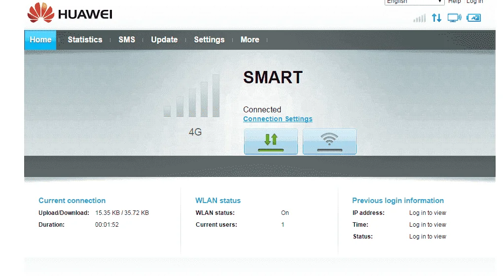

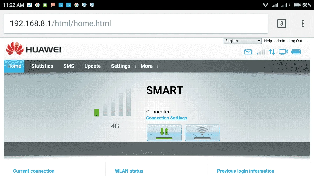

One done. The modem should reboot and should automatically open a web browser, which goes to the Huawei page. If not, open your web browser and go to 192.168.8.1. If it asks you for a username and password. It's "admin" for both. From here, you'll need to setup the network name, password, etc. Just like you would when you first bought the modem.
Take note that we don't have the Globe branding anymore.
