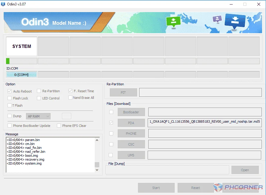

2. First maununa muna si Combination so extract natin siya sa download folder and after that open odin.

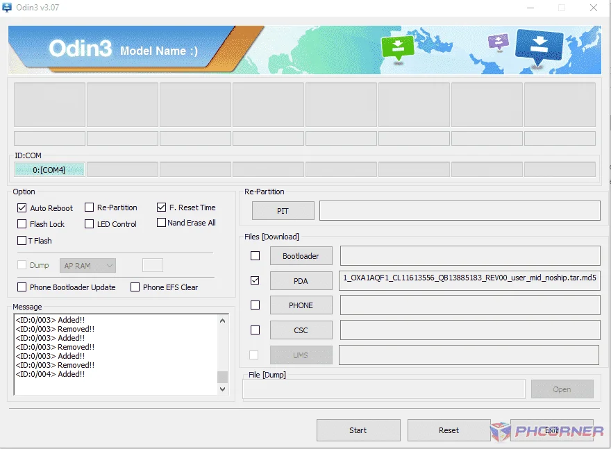

3. Click lang ng PDA or AP then load ng na extract mong file.

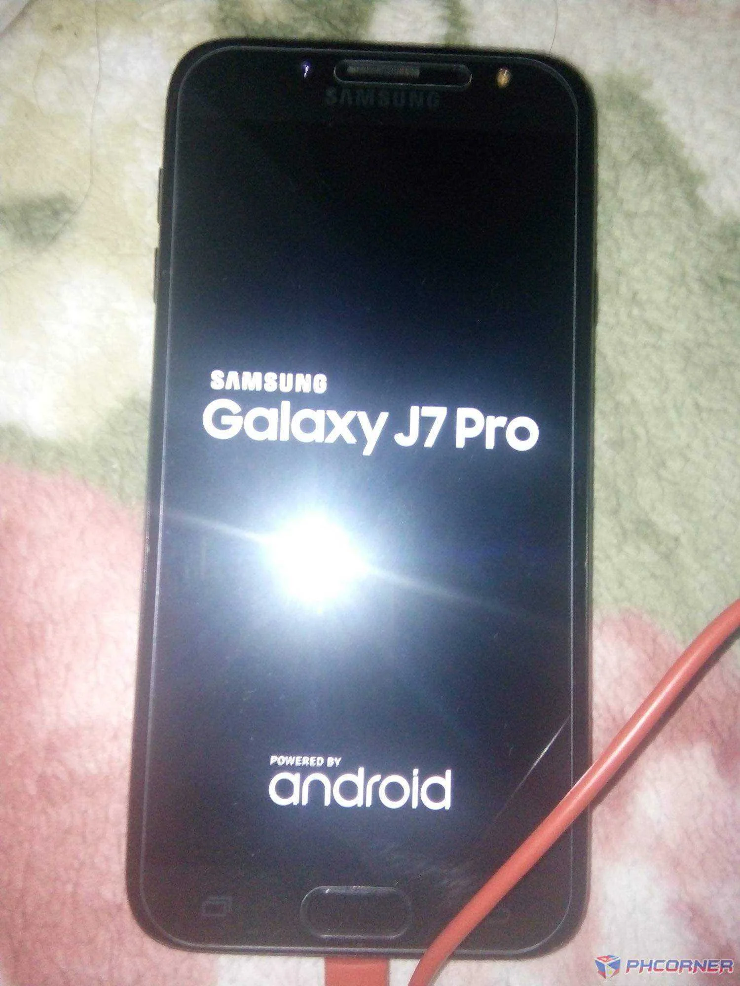

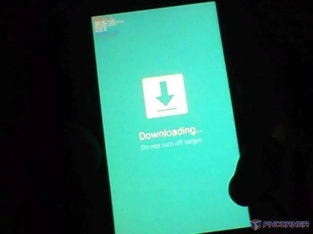

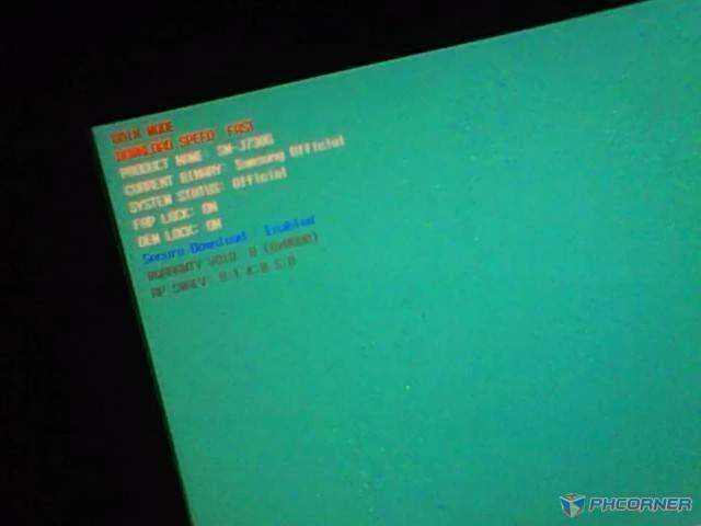

4. Now boot your device into download mode. By pressing volume down + home + power.

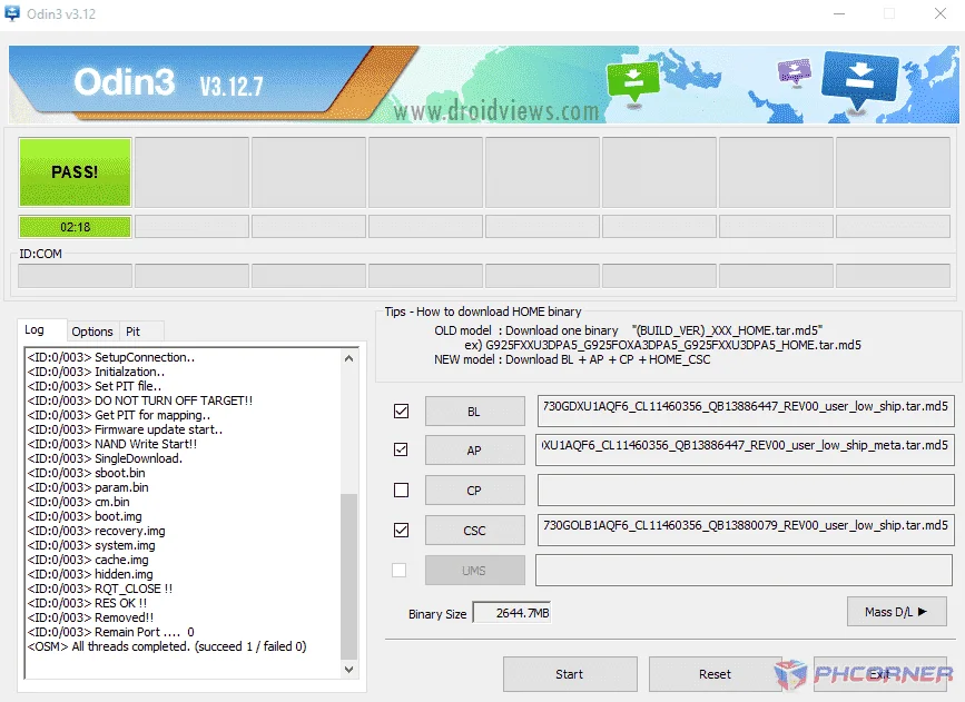

5. Click start sa odin then wait after flashing complete.

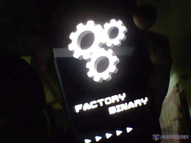

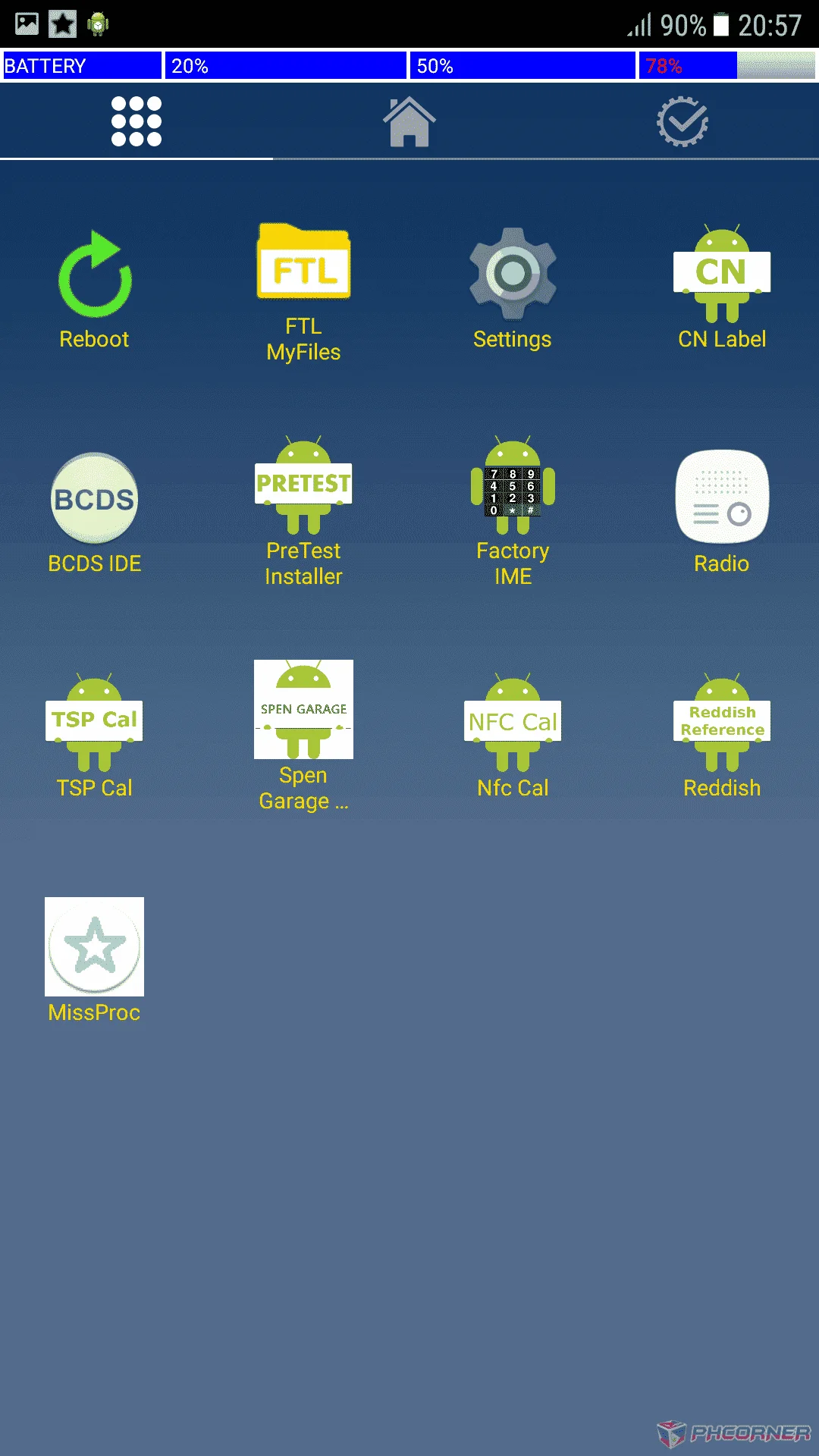

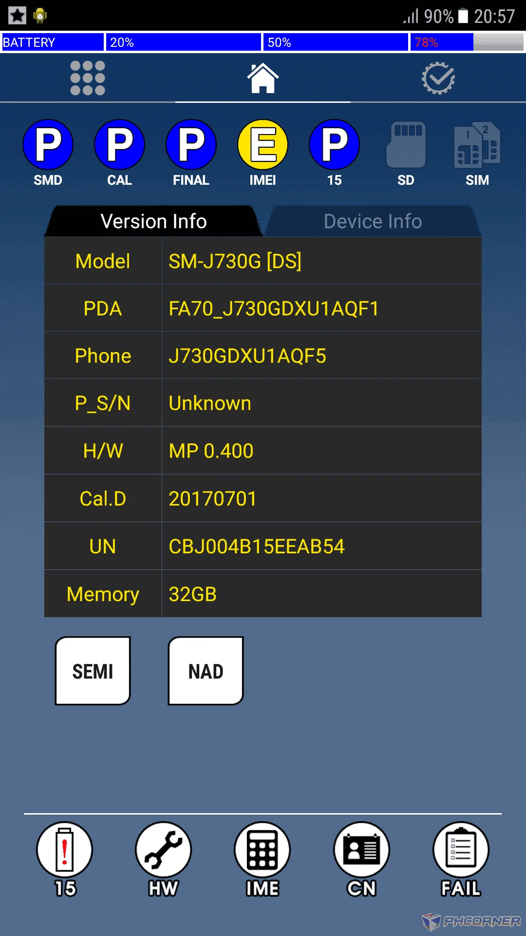

BREAK! Once nasa Factory Binary Firmware ka na. Ok! You did well pero meron pang isa pang process. So let's continue.

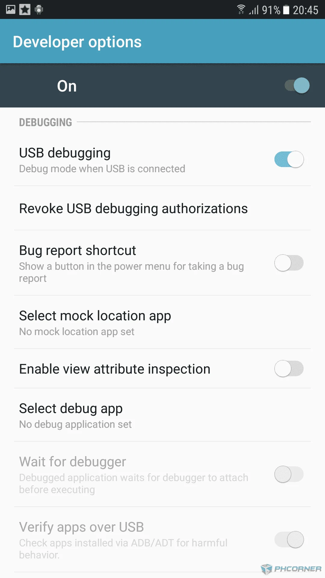

6. Go to Settings - Then developer options. Then enable USB Debugging.

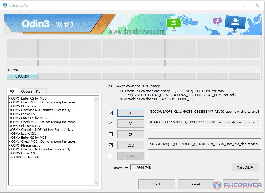

8. Open ODIN again. Then click the following files.
BL - BL_J730GDXU1AQF6_CL11460356_QB13886447_REV00_user_low_ship.tar.md5
AP - AP_J730GDXU1AQF6_CL11460356_QB13886447_REV00_user_low_ship_meta.tar.md5
CP - LEAVE AS BLANK.
CSC -HOME_CSC_OLB_J730GOLB1AQF6_CL11460356_QB13880079_REV00_user_low_ship.tar.md5

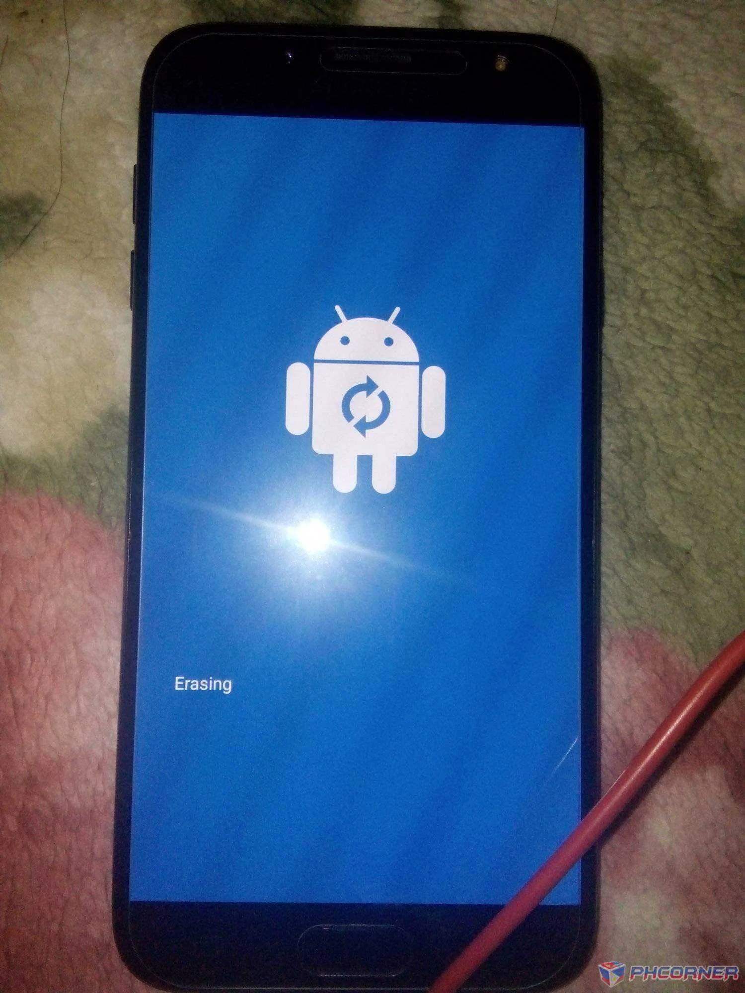

IMPORTANT NOTE: Don't flash CP file otherwise ang openline mo mawawala.

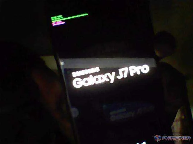

9. Click start. Then wait after the process finish.

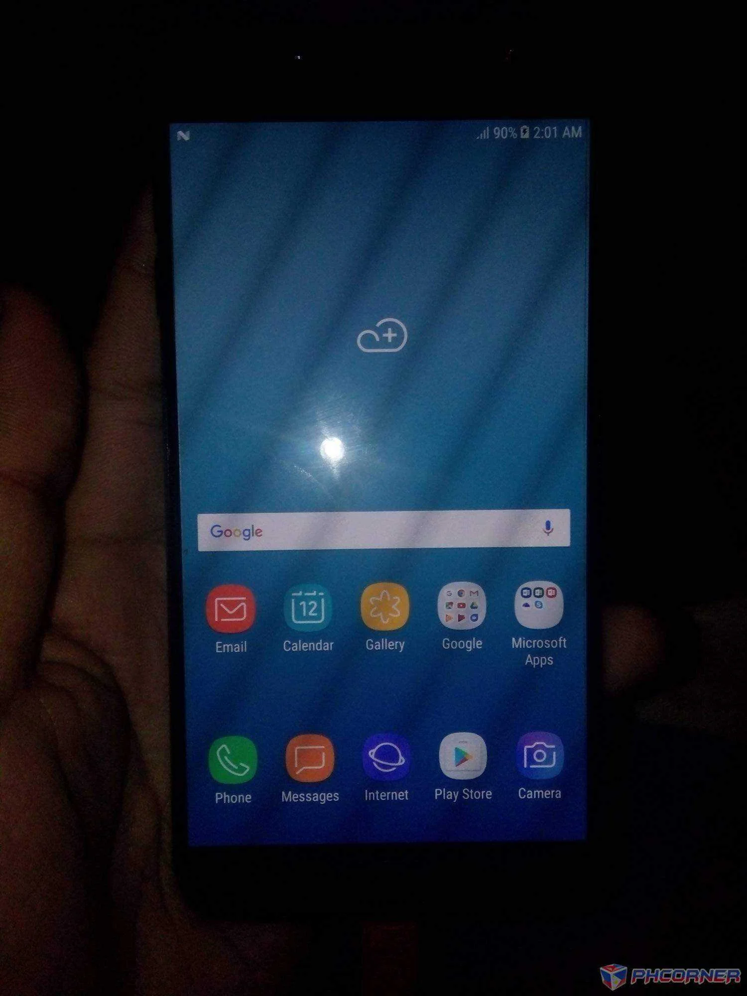

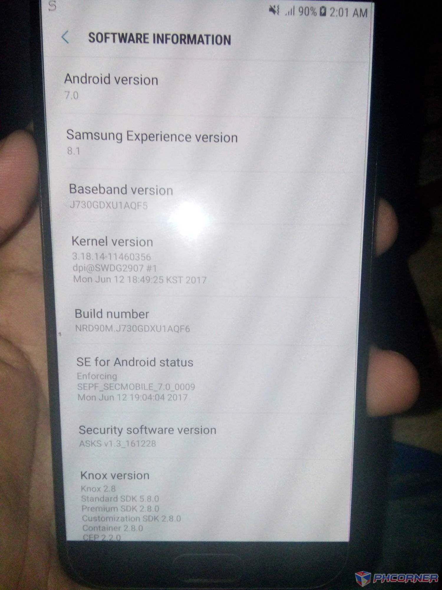

10. Finish the setup process. And you're done!
