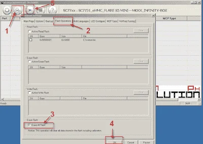

How to Bypass FRP in Cherry Mobile Flare S5 mini
  1. In ResearchDownload Click on Settings,Select Flash Operations tab.
  2. In Erase Flash, Check Erase All Flash then click ok.
  3. Now click Start Downloading.
  4. Turn off your phone and press Volume Upthe Insert USB Cable to PC.
  5. Now wait till finish downloading and you will see Passed.
