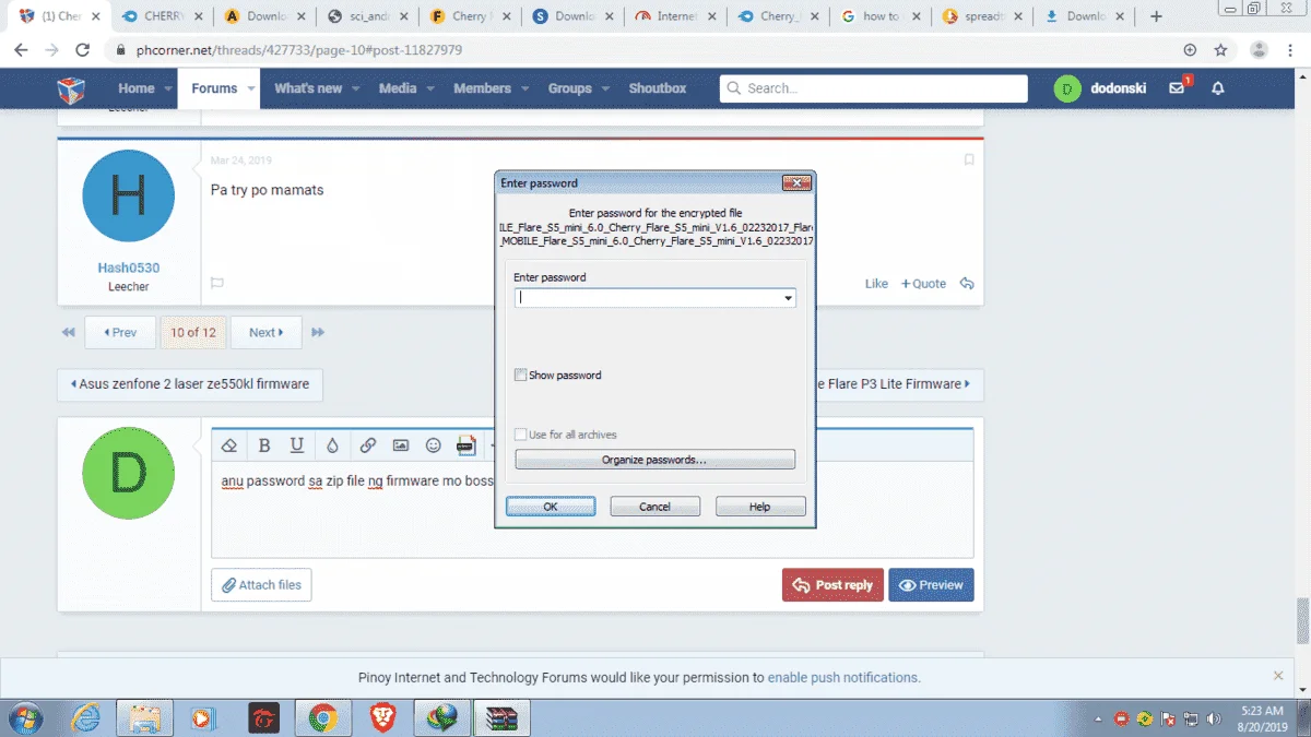

anung password mga boss
Corrupt header is found
Main archive header is corrupt
Checksum error in the encrypted file CHERRY_MOBILE_Flare_S5_mini_6.0_Cherry_Flare_S5_mini_V1.6_02232017_Flare_S5_mini.pac. Corrupt file or wrong password.
boss nag try aq mag extract pero ganito lumalabas.. hndi ko sya ma extract..
