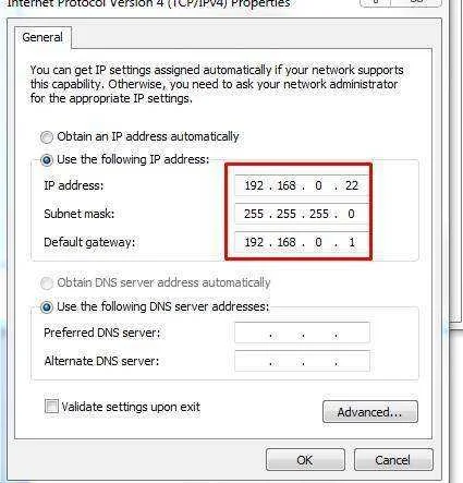

  2. Set static ip sa ganito

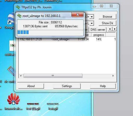

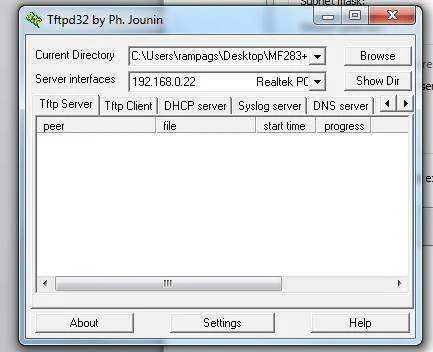

3) Open tftpd32.exe, follow mo lang pic.
  1. Kapag ok na hold mo reset+WPS then turn on mo yung modem.
  2. Kapag nagload na yung TFTPD32, pwede mo nang bitawan yung reset+WPS

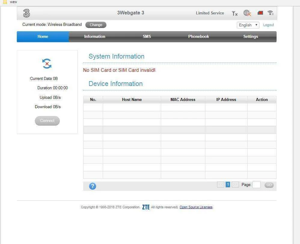

  1. Wait mo lang mag reboot ang modem, hintayin mo rin umilaw ulit yung wifi at 4G/LTE (within 5-10 minutes)
  2. Kapag umilaw na ang wifi at 4G/LTE, subukan mong i-access 192.168.0.1.

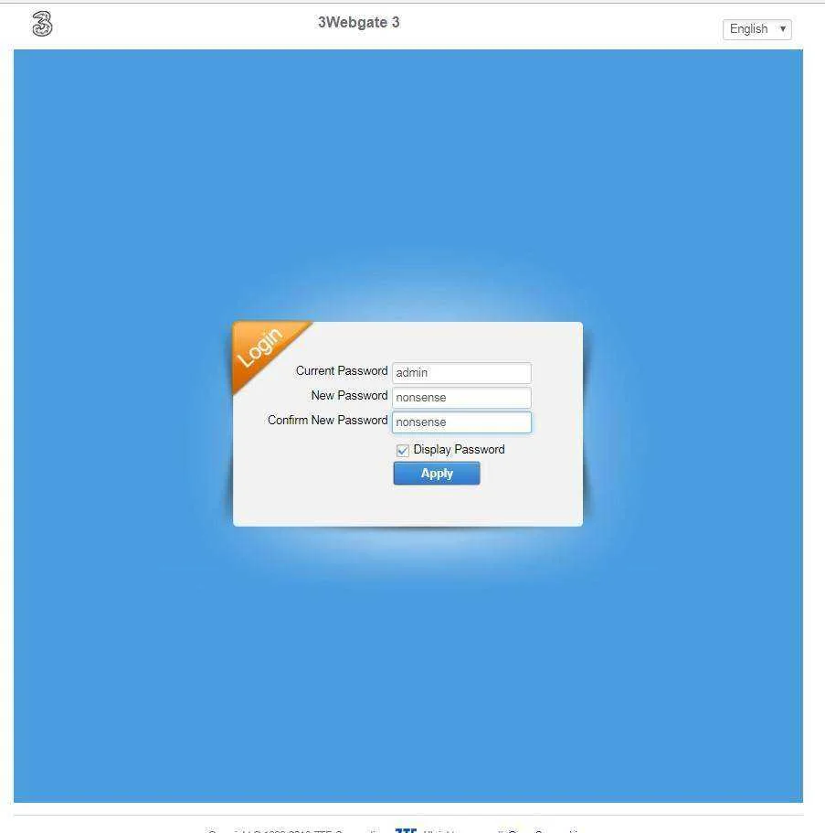

  5. Acess mo ulit 192.168.0.1, then maglogin ka. Lagay mo lang admin.
11) Lagay mo yung current at mag-set ka nang panibagong password.
