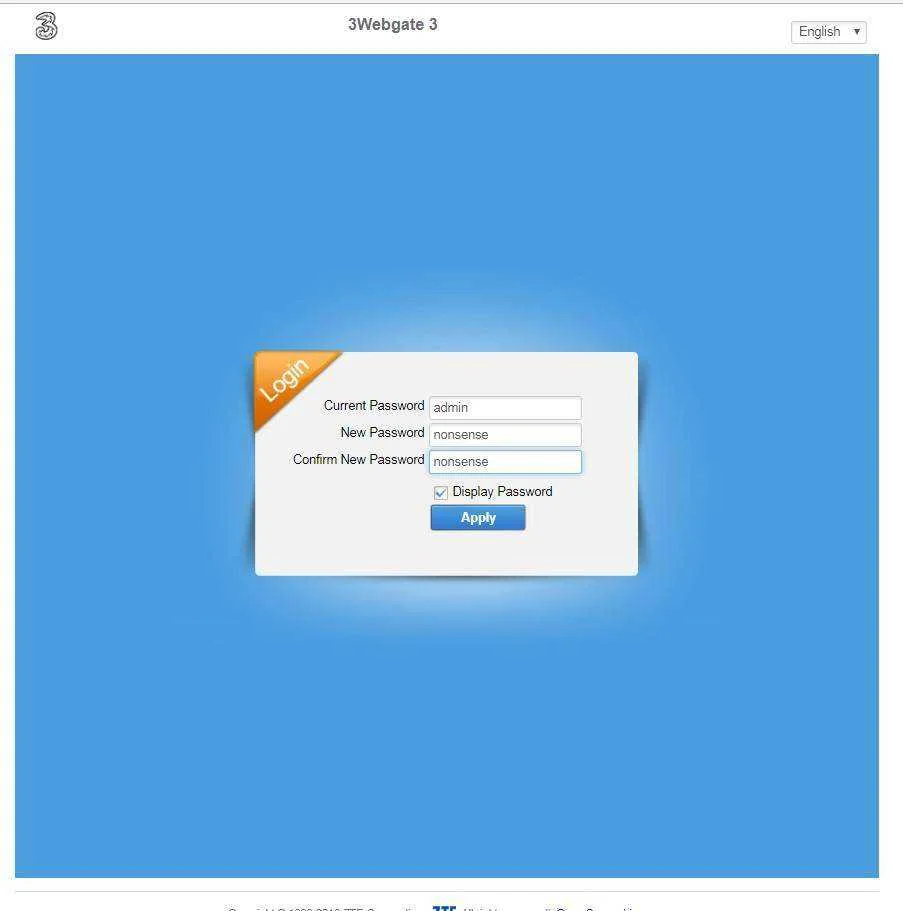

INSTRUCTIONS:
1) Turn off Modem.
2) Set static ip sa ganito
3) Open tftpd32.exe, follow mo lang pic.
4) Kapag ok na hold mo reset+WPS then turn on mo yung modem.
5) Kapag nagload na yung TFTPD32, pwede mo nang bitawan yung reset+WPS
6) Wait mo lang mag reboot ang modem, hintayin mo rin umilaw ulit yung wifi at 4G/LTE (within 5-10 minutes)
7) Kapag umilaw na ang wifi at 4G/LTE, subukan mong i-access 192.168.0.1.
8) Kung ayaw ma-access, reset mo.
9) Kapag na-reset mo na, power led na lang ang iilaw. Turn off and On mo lang yung modem then debrand na yan.
10) Acess mo ulit 192.168.0.1, then maglogin ka. Lagay mo lang admin.
11) Lagay mo yung current at mag-set ka nang panibagong password.
12) Good to go na yung modem mo. (Walang sim yan)
NOTE: Hindi na nagbabago yung kulay nang signal sa modem, always GREEN na sya. Kapag nagreset o reboot ka thru GUI, need mong i-manual On and Off yung Modem.
CREDITS: Sir Freddy3k, Revlon0007, SYMBI ANIZE, BundokTeams, PHCorner
