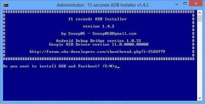

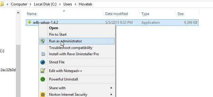

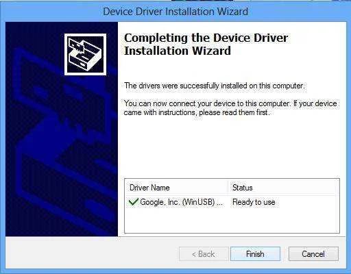

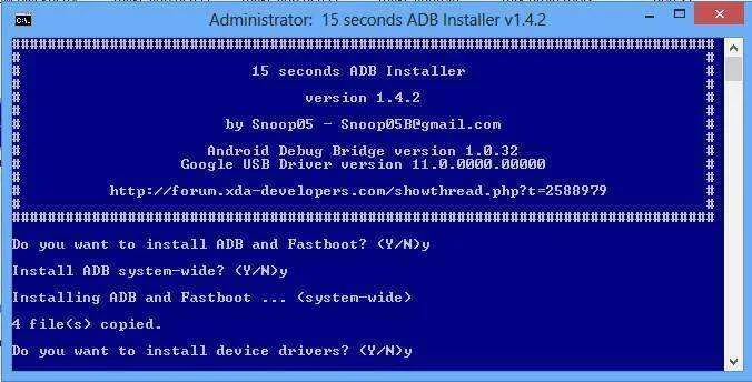

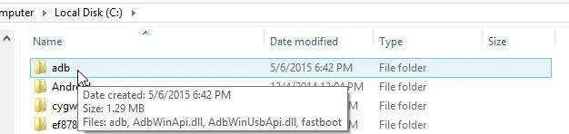

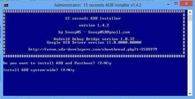

1.Run And Install adb-setup
how-to-install-adb-fastboot-and-drivers-5.webphow-to-install-adb-fastboot-and-drivers-6.webphow-to-install-adb-fastboot-and-drivers-7.webp

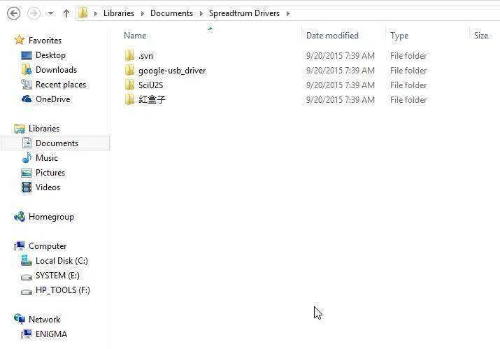

2.Unzip Nyo Yung Nadownload Nyong Spreadtrum Driver .how-to-install-spreadtrum-spd-usb-drivers-1.webp

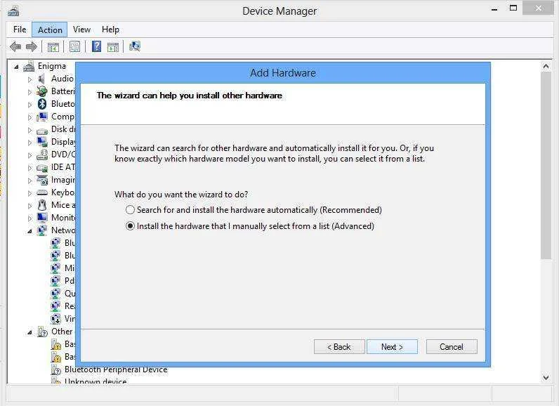

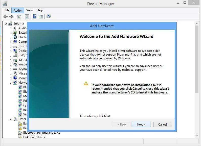

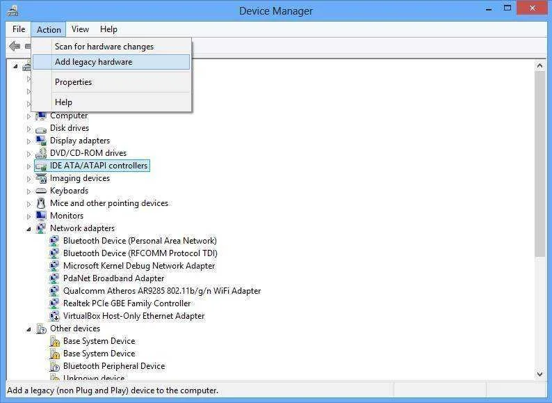

Tapos Pumunta Kayo Sa Control Panel>Device Manager Tapos Pindot Kayo Kahit Na Isang Device Tapos Click Action Sa Taas Last Click "Add Legacy Hardware"how-to-install-spreadtrum-spd-usb-drivers-3.webp

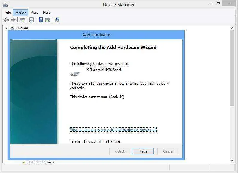

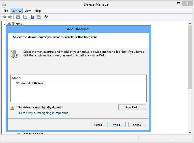

Tapos Ganto Yung Lalabas Tapos Sundin Nyo Na Lang Yung Mga Pictures Sa Baba . Click Nexthow-to-install-spreadtrum-spd-usb-drivers-4.webphow-to-install-spreadtrum-spd-usb-drivers-5.webp
Click Nyo Yung Install The Hardware Chuchu HAHA . Tapos May Lalabas Jan Sunod Basta Next Nyo Lang Trust Me :)

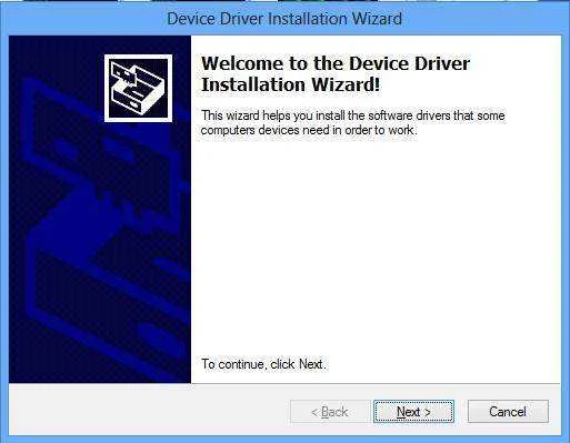

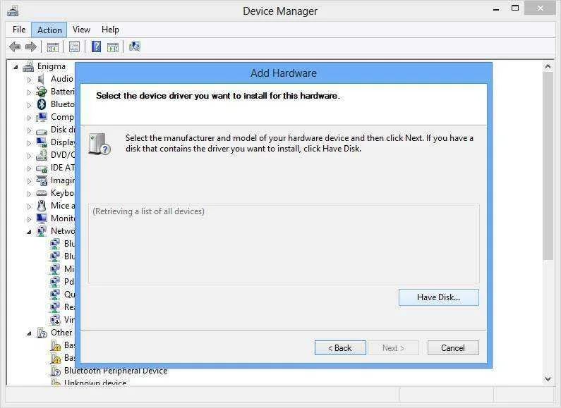

Pag Next Nyo Dun Ganto Yung Lalabas . Tapos Click Have Disk .

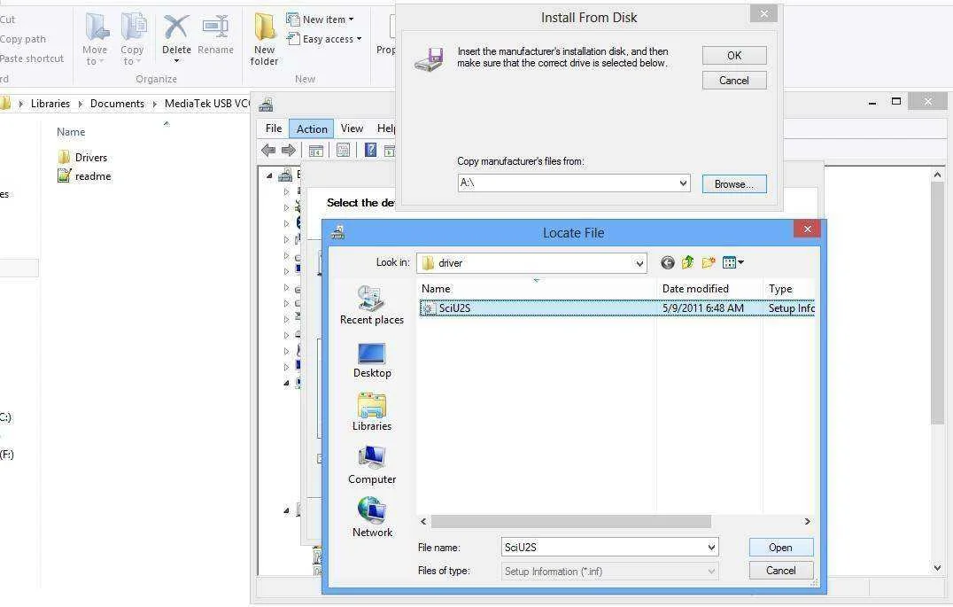

Tapos Hanapin Nyo Na Yung Spreadtrum Folder>Driver>Tapos Tong File Na To .how-to-install-spreadtrum-spd-usb-drivers-7.webp
Tapos Ito Lalabas
Just Next,Next,Next Tapos Ito Na .

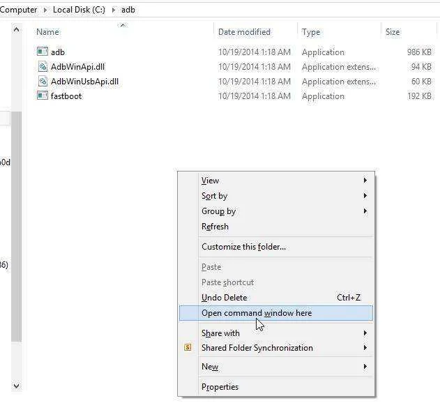

Launch Mo Na Yung Adb.exe Nandun Yun Sa Adb Folder .
Para Malaunch Ang Adb . Hold Shift Tapos Right Click Mo And Click Open Command Window Here .

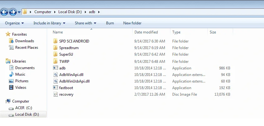

Note Yung Nadownload Nyong Recovery.img Ilagay Nyo Dun Sa Loob Kasama Ng Adb And Fastboot .
Ganito .

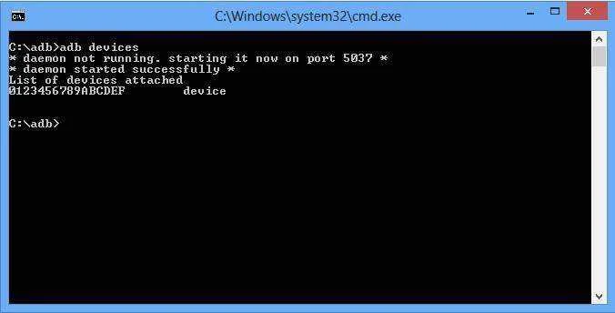

Okay Balik Tayo Dun Sa ADB . Ganto Dapat Ang Lalabas how-to-install-adb-fastboot-and-drivers-11.webp
Tapos Ilagay Tong Mga Code Na Ito :
Note : Isa Isa Lang Po Ang Paglagay Wag Sabayin .
1.adb devices
2.adb reboot-bootloader
3.fastboot flash recovery recovery.img
Pag Tapos Nyong Gawin Yan . May TWRP Recovery Mode Ka na :)

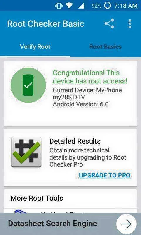

Reboot Your Phone And Check It With Root Checker .
Credits To : You do not have permission to view the full content of this post. Log in or register now.
PROOF ?
Kanina Ko Lang Po Naroot . Nadesperado Na Ko HAHAHAHA
