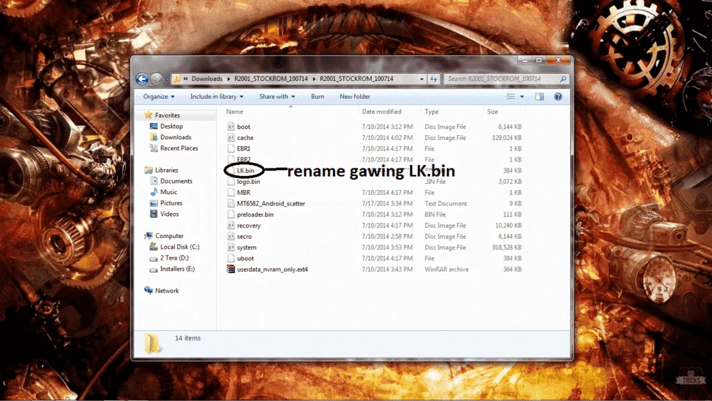

Oppo R2001 Hang /Dead/Vibrate DONE
Flash Ko Sa Flash Tool Dead Vibrate Na Lang
Kaya Pala Nag Vibrate Na Lang Dahil Wala Uboot Ang File...
Here's The SOLUTION Open Folder Kung Nasaan Ang File Ninyo At Gawin Ito

Sa File Kasi Na Yan LK Lang Po Ang Naka Lagay Dahil Ang Lk po Ay = Ng UBOOT
Proceed Na Po Ako Sa Flashing
Pasensya At Diko Nakuhaan Ng Screen Shot Nung Flashing Ako Na Close Ko Po Kasi
After Flashing Hang On Logo Off Ang Phone At Punta Sa Recovery Holding Power Button And Volume Down Wipe Lang Po...
Medyo Matagal Mag Boot Hintayin Lang Po... kung may invalid imei , download nyo na lang chamelephone
