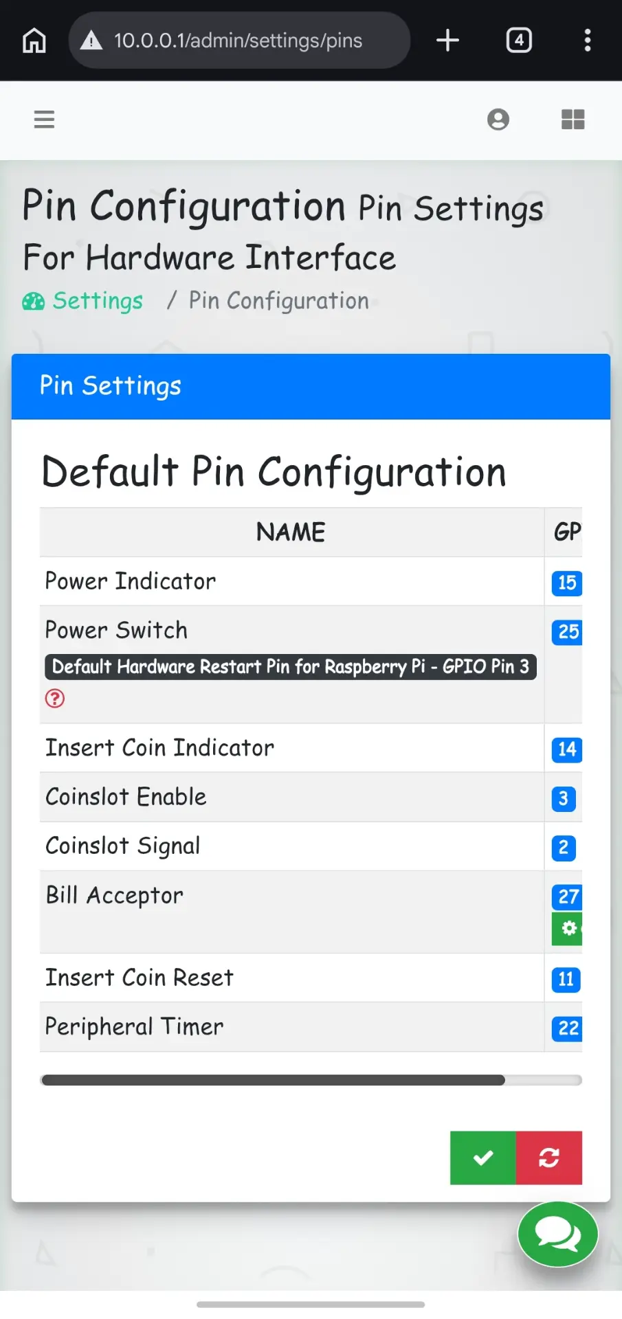

E Exclamatory Fanatic Oct 5, 2026 #1 COINSLOT CONCERN ano po possible problem ayaw ma detect ng inihulog? BOARD: OPI ONE GPIO PIN - PIN 2 WHITE WIRE FROM COINSLOT PTPA, thank you!
H Hit_and_Runner18 Honorary Poster Oct 6, 2026 #2 Exclamatory said: COINSLOT CONCERN ano po possible problem ayaw ma detect ng inihulog? BOARD: OPI ONE GPIO PIN - PIN 2 WHITE WIRE FROM COINSLOT PTPA, thank you! Click to expand... check mo muna kung shared ang gnd ng 12v power supply papunta sa gnd ng opi lods. pag walang common ground di babasahin yung pulse ng white wire sa gpio, tsaka tingnan mo rin switch sa coinslot kung naka fast pulse at NO. Upvote 0 Downvote
