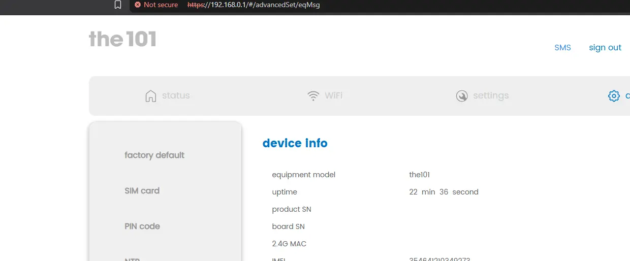

TS Thank you sa MTK tool mo na recover kuna router :danceFrog:. May signal narin and band lock works fine.
Ang nawawala nalang ay yung Board SN, Product SN at Hardware version. If ever my suggestion po yung marurunong sa ganito paturo kung kaya pa mablik haha kung hindi na kaya okey lang working naman na. :RareDoge:
