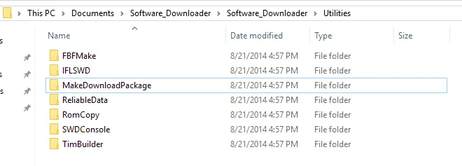

Hi guys, I am addressing to those who have advanced knowledge on L02C and L02B Mifi, if you don't want to post here even inbox a person just gives us the method to perform firmware backup only with this I can find the solution for *WTPTP Error: FBF_VersionNotMatch*
Thank in advance !!! :):):)
there some tools included in this file
maybe it can help read backup.
i have worked on it several days trying to run some cmds but nothing happened.
try yourself and lets see what you will get.
