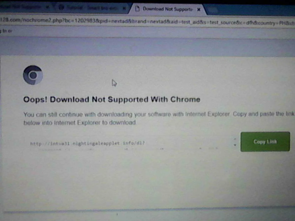

sir bat nd ko ma download lahat ng files na enupload mo.?
ganito poh sya palagi O :(
Oops! Download Not Supported With Chrome
help poh sir. FX pr2 rin poh yung pocket wifi ko ...gusto ko talaga ma openline yun kaso may error na ganyan O... Thanks Poh sir

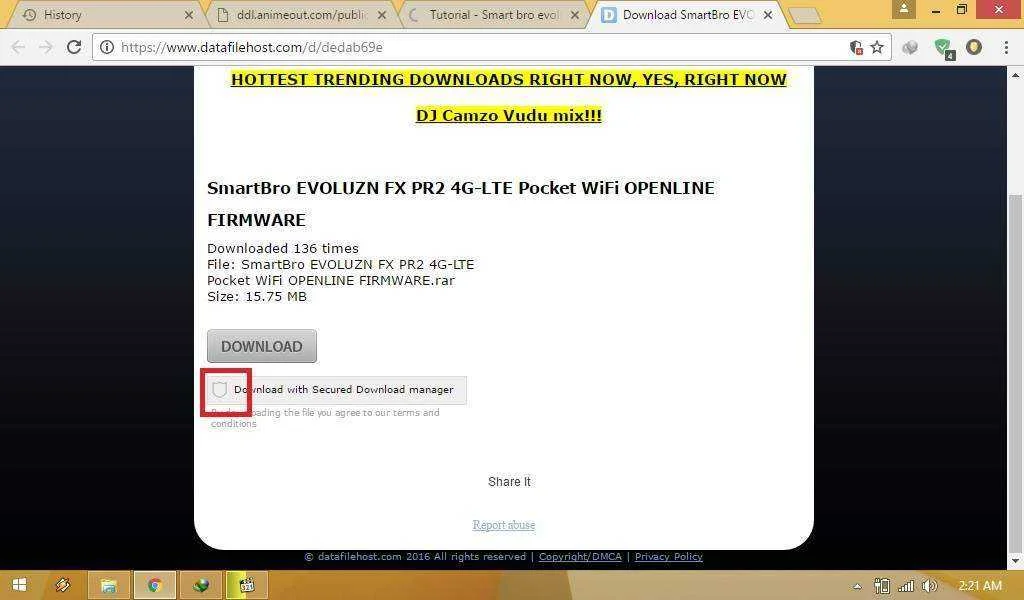

help poh sir .. fx pr2 rin poh yung pocket ko ...gusto ko talaga ma openline yung ... Thanks Poh
I un-check mo ung naka highlight
