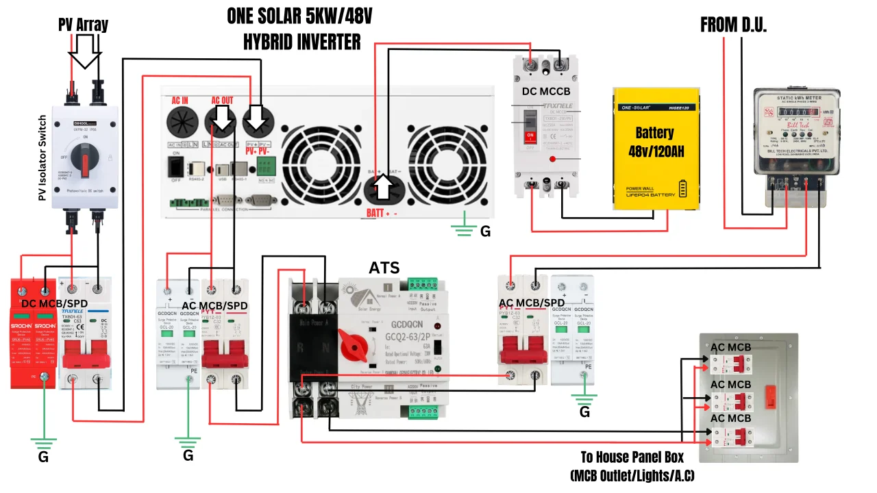

Hello mga ka-PH,
Baka my mga member tayo dito na expert sa pg sosolar, baka ma tulungan nyo po akong mga check ng binabalak kung bubuohin na solar panel system. Diagram posted image po. Your suggested, correction are fully accepted and appreciated .

good naman ang diagram mo, palag nayan, mahal nga lang ng battery mo aabutin ng P40,000 kapag naka series yang battery mo 4pcs na 12V battery para maging 48V P40,000 then panel mo 500W 4pcs Series nasa 2kW...nasa P18,000 tapos yung hybrid mo nasa P35,000
PV 18,000
Inverter Hybrid P35,000 -P45,000 5.8kW
Battery 120Ah 48V 40,000 or 37,000 defend on Shop
7pcs Breaker 30A around P800 (not Include house panel Breaker, its was given)
ATS P1,200
Wire 14AWG or 12AWG red and black around 300 6 Meter
Battery wire 6AWG (recommended) or maybe 8AWG red and black around P400 3 Meter
Panel Wire 8AWG 10 meter defended of you're roof to how high it is. P1,000

Maraming salamat boss sa input nyo po... Big thanks talaga ... I will save this sizing you give po.. 🎉🎉🫡🫡🫡
