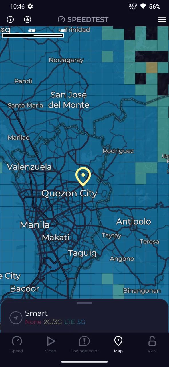

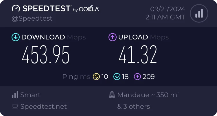

hindi pa naman kc fully utilized ung chipset nya, kaya neto both H153/H155 mag 5G 2CC, pero ung tower ni smart 5G 1CC lang kaya, at biggest contributor ng heat is ung 5G radios so normal lng tlga para sa kin na di nag on ung fan..

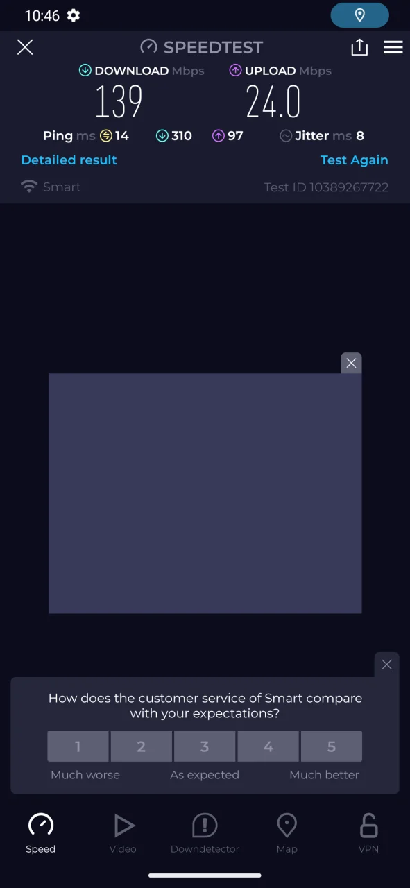

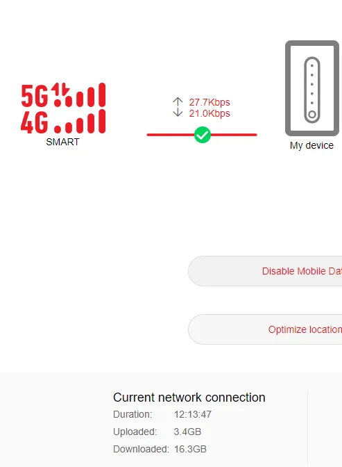

Also nag stablized na tlga ung speed nya after ng smart outage, getting 350-500mbps in my area kay H155, at di na nag lalag sa ML kahit 10users.. B1 + B3 + N41 (4G 2CC + 5G 1CC)
hindi pa naman kc fully utilized ung chipset nya, kaya neto both H153/H155 mag 5G 2CC, pero ung tower ni smart 5G 1CC lang kaya, at biggest contributor ng heat is ung 5G radios..

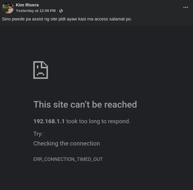

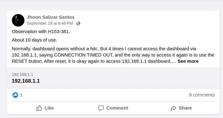

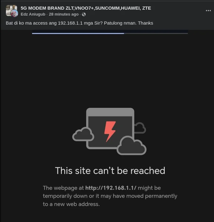

Can anyone confirm the Web GUI crash / Connection refused issue sa H153-381? Tatlong separate accounts na nag reklamo dito, ewan ko config issue, pero puro H153 lng nakikita ko, usually nang yayari pag naka bukas ang modem for 8-10days straight walang patayan.. parang hindi ata enough ung RAM kay H153 kaya namamatay bigla ung Web server nya para sa UI... pero ewan if Web UI lang ang issue or kasali na rin na nawawala ang connection..
