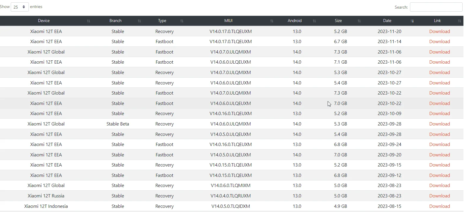

Firmware Download
Please find the model of your phone here
make sure you select the Global fast boot
Example
Archieve so you can see the old firmware ver.
Select the stable FASTBOOT , I suggest to find the right firmware use the stable and between the latest firmware and old firmware
