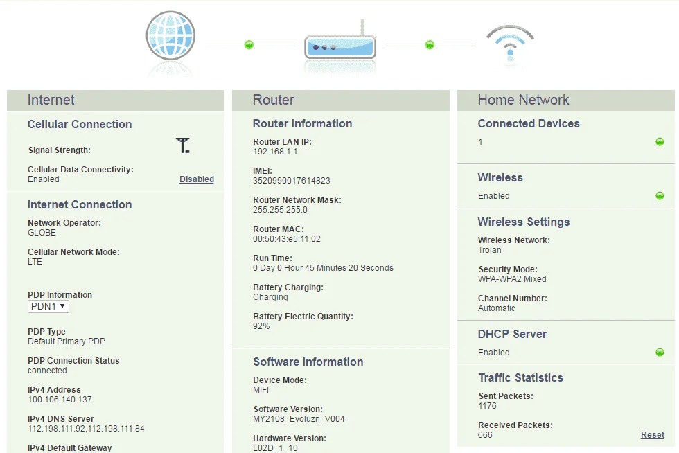

working na po kaso di n makaconnect via wifi tong pocket wifi ko... nakaconnect sya tru USB bakit po ganun? any help nman po jan oh.... naka attach pala d2 ang dashboard at bakit po walang PNPIN? maraming salamat po

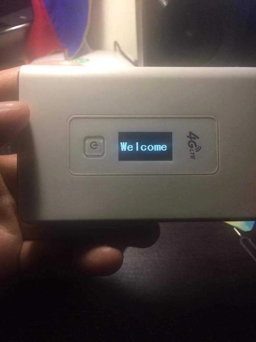

sir patulong po, naopen n sya kaso may prob... nawala wifi nya... di ako makaconnect sa mobile device makakaconnect ka using USB n lng pano po ito?

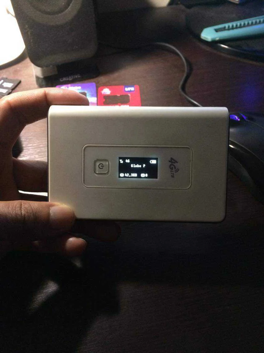

Sa mga may GLOBE M023J with L02C_1_30 boards na nakakakonek na sa 3g but not LTE try this and let me know.
1. Use this You do not have permission to view the full content of this post. Log in or register now.
2. Flash with "Erase all" and tick all checkboxes as in default.
3. Insert Smart LTE sim muna then turn it on

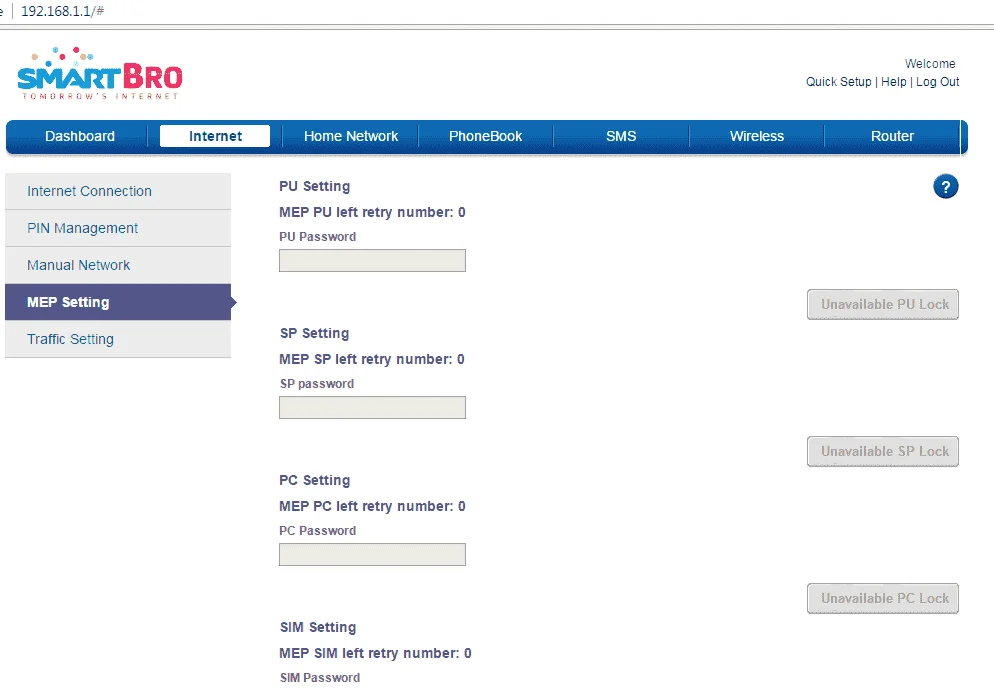

4. Pasok ka sa dashboard para maenter MEP pin 123456. Then let it connect sa 3g.
5. This is optional pero kung may backup ka ng IMEI/MAC/SN ibalik mo na thru MIFITOOL
6. Turn it off.
7. Open ulit SWDownloader and this time icheck lang natin:
TIMH
OBMI
and RFBN
now sa RBFN palitan mo yung file to GLOBE_Youwin_MO23J_4G-LTE_Pocket_WiFi.bin
uncheck mo pala yung "Erase All" kasi di siya magfflash

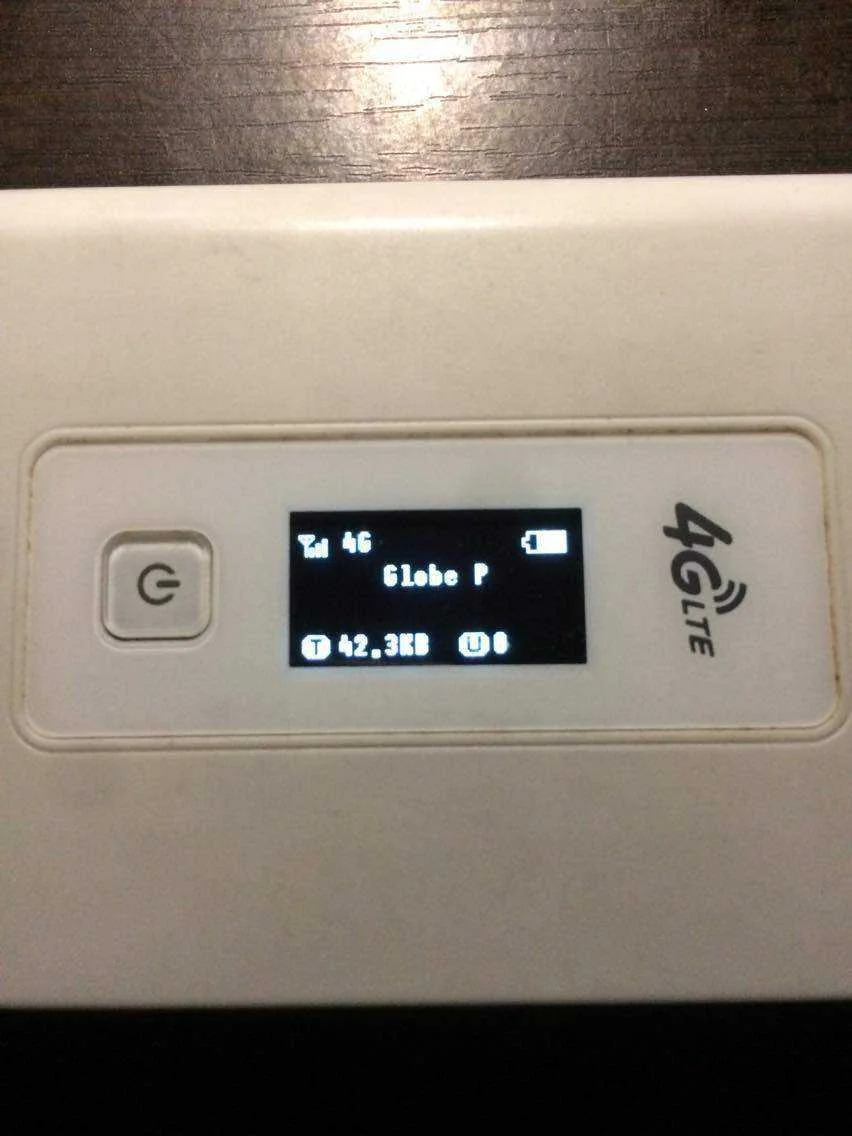

Mabilis lang flashing then turn it on and check kung coconnect nasiya ng 4g :)
Pag 4g na smart turn it off then insert Globe sim then check. Minsan you need to go the dashboard para maforce connect siya sa globe.
Pag di padin repeat step 7 then choose SkylarkL02CLZMA1104.bin as RFBN then check ulit kung 4g na.
Yan yung gumana sakin, parang ang trick is to reflash the RFBN files. Di siya nakukuha sa unang flash. Pinagpapalit palit ko yung GLOBE_Youwin_MO23J_4G-LTE_Pocket_WiFi.bin at SkylarkL02CLZMA1104.bin hanggang sa nakuha kong parehong network LTE na. Note na pang L02C_1_30 board to. Pag sa iba yung mga LED models you can try na palit palitan RFBN using yung mga compatible sa inyo.
Please let me know kung may matutulungan to.
Glad to help Sirgutz. How's your unit since flashing? I don't know kung placebo lang, pero parang i noticed na hindi na masyado umiinit at naging mas makunat batt compared pa sa stock globe firmware.

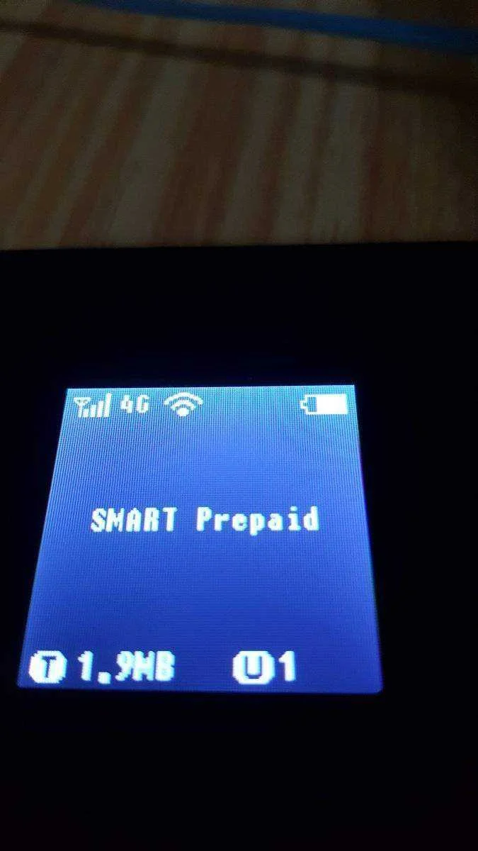

Sir, gumana sakin yung LTE both smart and globe but the icons for batter and signal is still not showing any fix for that po?
