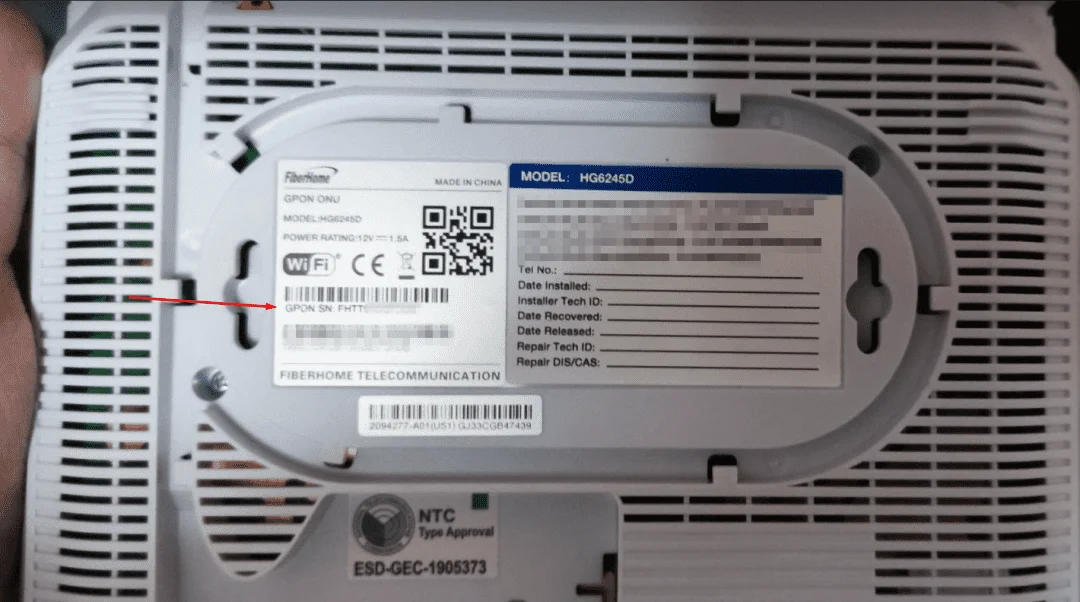

  1. Note the Serial Number of HG6245D. You can find this at the underside of your modem.
    • Don't Disconnect the Fiber Line Yet.
    • FHTTxxxxxxxx, where xxxxxxxx is the serial number.

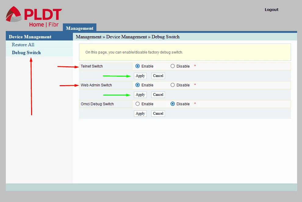

  4. Open any Browser and Enable Telnet Switchvia Debug Switch
    • Access Debug Switch, You do not have permission to view the full content of this post. Log in or register now. and Copy and Paste the Username & Password.
      • User: f9!6b1e1rhO3es~u!p@e#r$a%d^m*i(n
        Pass: s)f_U+h|g{u@5h2o1q0b1l
    • Enable the Telnet Switch and Web admin Switch, DON'T FORGET TO CLICK APPLY !!!

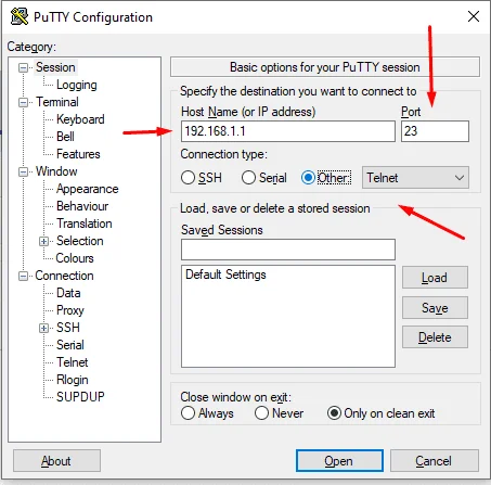

  5. Open PuTTY and Input this in PuTTY: (Copy & Paste only the BOLD Words)
    • Host Name (or I.P Address): 192.168.1.1
    • Port: 23
    • Connection Type: Other: Telnet
    • Click Open

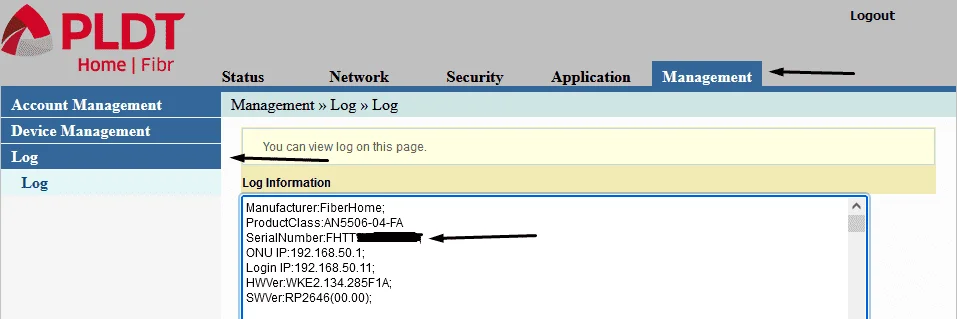

  6. Confirm the changed serial number of your modem.
    • Access Web Admin You do not have permission to view the full content of this post. Log in or register now.
      • User: adminpldt
      • Password: z6dUABtl270qRxt7a2uGTiw
    • Go to the Management tab, then go to the Log panel and check if the serial number has been changed. Restart the modem if necessary.
