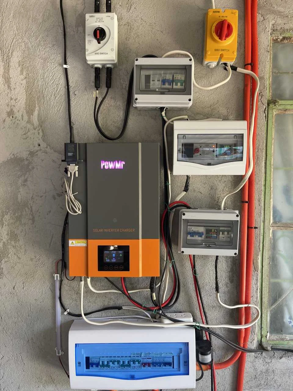

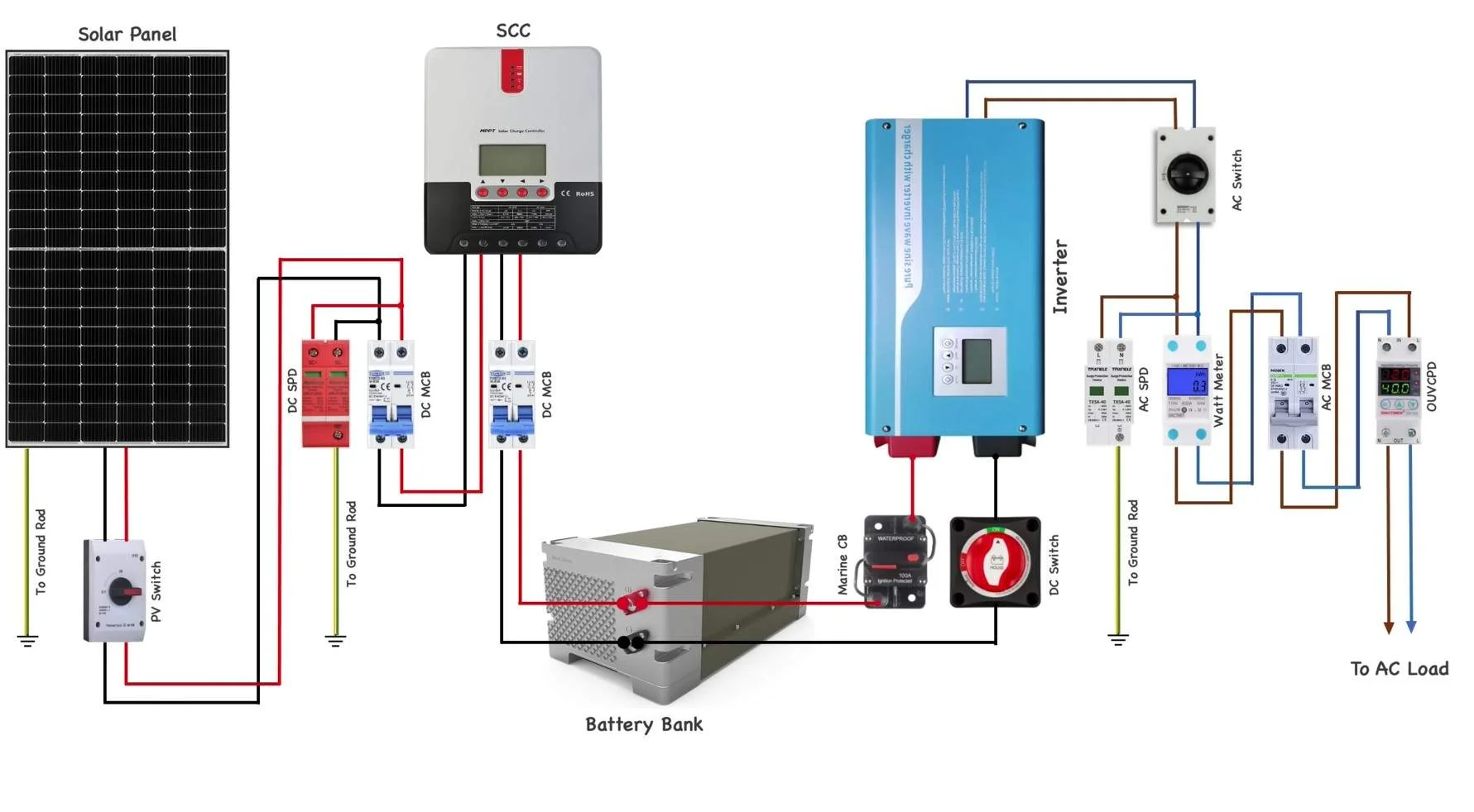

I have a 48v 3kw setup sa bahay. As of now, Lead Acid battery palang setup ko since medyo pricey din pag nag LifePo4 ako.
Medyo messy pa lines ko pero working as intended na yan. Di ko pa kasi nailalagay cable trunking ko.
Load:
1hp split type inverter AC
.75hp non inverter window type AC
2 inverter refrigerator
2 TV
1 Electric Fan
Sabay lahat to during daytime basta galit na galit yung araw like this summer.
Expenses:
Solar panel 500w Trina Panel 6pcs - 55,200 pesos
Powmr 6.2kw Hybrid inverter - 26k
Shoto 150ah battery (12v x 4pcs = 48v) - 21k
Protection Device and Misc. - 8k
Installation - Free, DIY ko kasi to. Inaral ko sa YøùTùbé and FB groups
Prices yan nung december 2022. Mas mura ang panel as of now.

Hi mga boss. Itong mga setup nyo di ba kasama yung "sell back to the grid" yung excess?
Depende yan sa setup boss. If pure off grid di possible mag net metering (sell back). kailangan supported yan ng inverter mo mag export. Meron naman mga hybrid inverter na complete na, may option na off grid or grid tie (with back up mode).
Also ang net metering ay inaapply pa yan sa electric coop niyo and make sure nag ooffer ng ganyan si coop. another expense ulit yun since need mo rin ng electrical plan from licensed Electrical Engineer (in our case dito sa area namin).
If tight ang budget, better go off with net metering route. Mahal kasi talaga battery. Dagdag panel nalang and bawi sa panel para marami rami ang harvest.

madami na ngayon option ng inverter na pwede mag export ng power sa grid.. kaso nga lang yung application mo nalang talaga sa net metering ang magiging problema pag DIYer ka. madami kasing requirements kailangan mo icomply... mahal lang talaga ang battey pag hybrid offgrid ang magiging setup mo...
