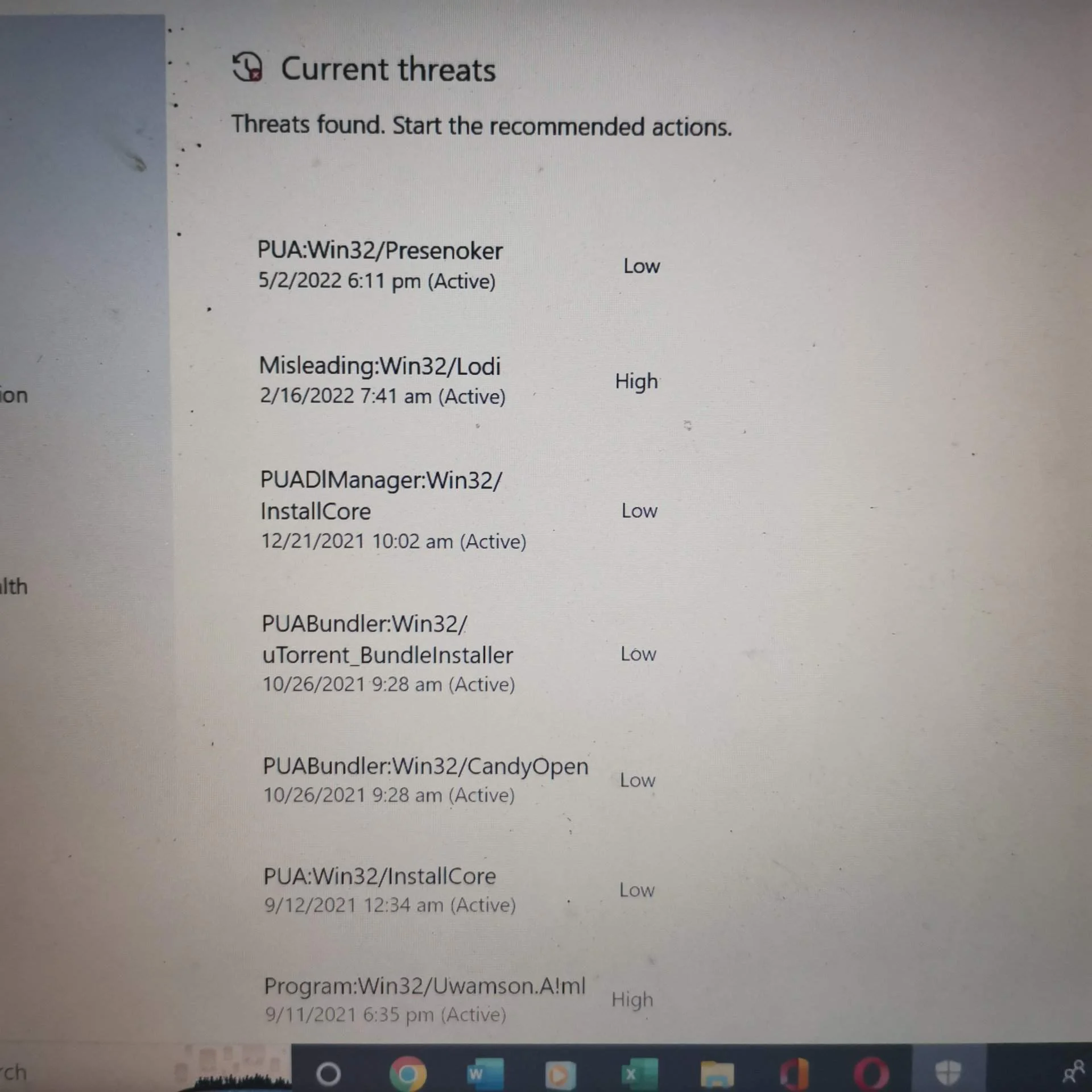

Good PM mga ka TS!
Pahelp po aq sa laptop namin na ginagamit po sa work.. ganyan po nangyayare may sariling buhay. kahit restart at shutdown na. wala po antivirus. ano kaya possible. problem. salamat sa makakatulong po.. 🙏 IMG_20221108_121243.webp
not sure kung software issue
pero possible na hardware gaya ng keyboard
try mo mag punta ng bios kung may ganyan ding issue na naghohover ng kusa ung selector - pag wala - format muna lng
Kung hardware ang issue, magre-reflect pa rin iyan kapag bi-noot mo na sa bootable USB. At any rate, kailangan mo pa ring mag-run ng anti-virus na hindi mo magagawa kung OS ang ibo-boot mo.
6 sa detected na treats is adware form either a toolbar or pirated game or software cr@ck so 100% di yun yung problema
pinaka my threat is yung umawson
kase dalawa ang klase ng umawson isang false positive na nadedetect ng windows defender
galing sa pirated games and software
or yung trojan version which is raratratin ka ng ads in desktop yung operation nya
yung symptom is di pasok sa modus nung umawson so 95% ako sa hardware problem
lalo na since isang direction lang pinupuntahan ng highlight
(operational virus is all direction para di madali ma diagnose)
5% sa umawson + mas mabuti parin na tangalin mo yung umawson
run either malware bytes or any other suggested remover dito
Please do try these troubleshooting steps that may help in solving the issue:
  • Start by uninstalling the keyboard driver from Device Manager.
  • Once uninstalled, reboot your laptop and it should reinstall the driver automatically.
  • After the reboot, test the keyboard again and see if the same problem persists.
  • If it does, connect an external USB keyboard and see if the same problem persists.
  • If it works normal with a USB keyboard, you may need to do a complete factory reset with your laptop to really identify if it's a hardware or software problem.
  • If resetting your laptop back to factory does not solve the problem, then it's the keyboard itself that is faulty.
pulot ko lang po, but this will verify or check if iyung keyboard na (hardware) ang may problema
or possible din na baka iyung touchpad naman ang may problema
