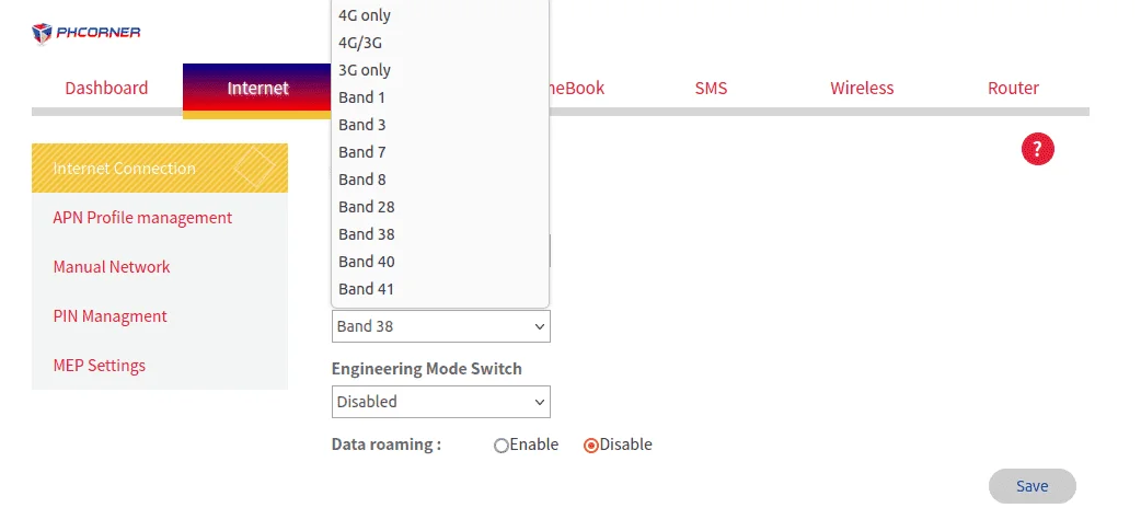

Note: kung hindi kayu na openline Suggest ko mag downgrade kayu ng Baseband
PLDT HOME R051 Firmware Openline Mode. with Simple BandLocking with apps NotionLink for android!!
* Convert Wan mode
*QOS
etc...

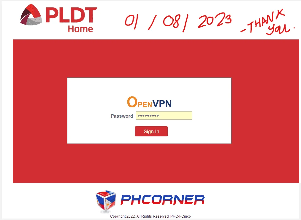

WEBGUI
r051.com or 192.168.1.1
pass
pldthome

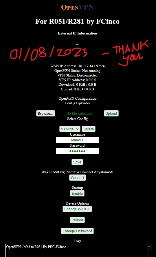

OpenVPN
r051.com:81 or 192.168.1.1:81
default login
admin
admin
Screenshot from 2022-10-18 22-44-32.pngScreenshot from 2022-10-18 22-01-35.pngScreenshot from 2022-10-18 22-02-59.png
pwede naman boss
eto ba hanap mong openvpn boss ^_^ d ko pa tapos tong isang nasakin ha

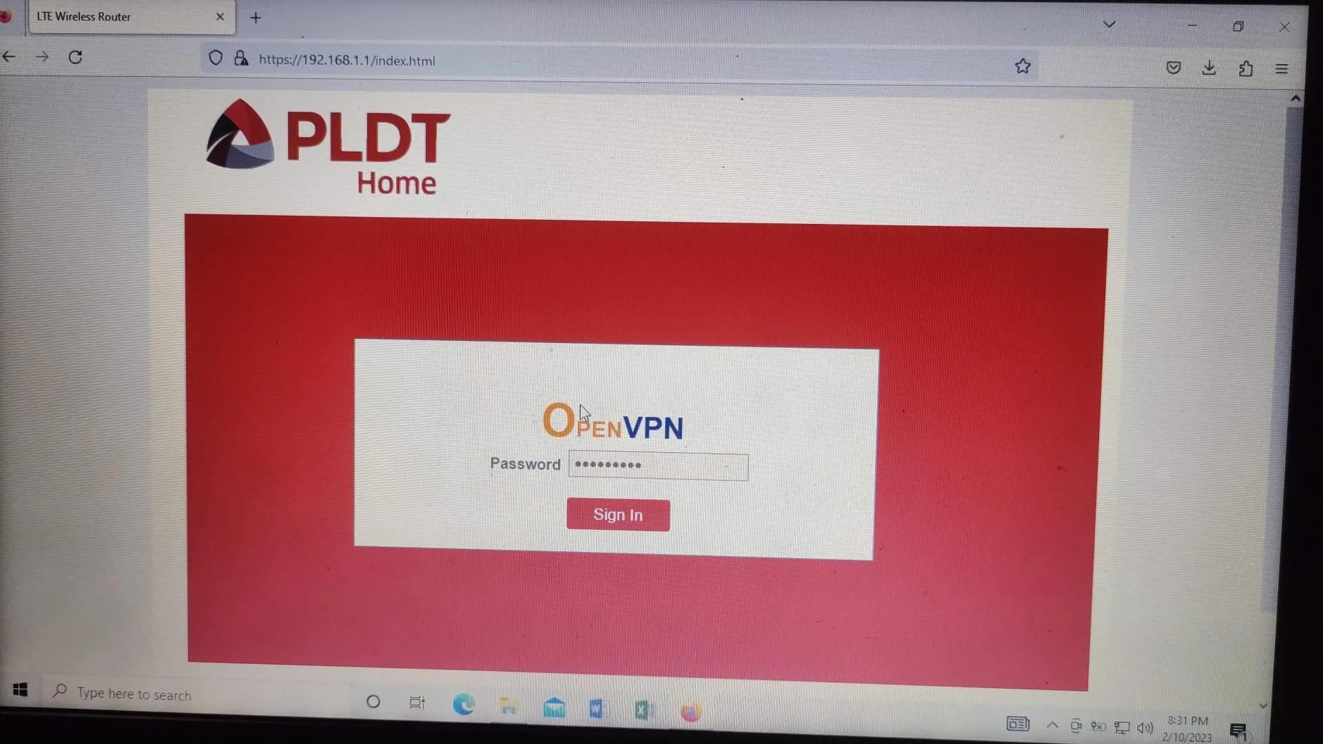

pano ka ba nag flash boss via web upgrade or tftp?
i flash monalang yung firmware boss
download and extract mo yung files na kaylangan.
set ip to manual
10.10.10.3
255.0.0.0
10.10.10.123
open tftp64.exe
salpak mo lan cable
hold reset/wps
power on mo modem while holding reset/wps button sa likod.
bilang ka ng 5 seconds kusang mag uupload ang firmware.bin
release mo na si reset/wps wait mo lang mag restart
video tutorial pls :)
Pasubok nga neto ng matest
download and extract molang yung files i flash mo sya via tftp64.exe pero set mo muna yung ip may mga screenshot jaan sa files ng ip kung pano iset sa pc pag na set mona proceed kana sa pag flash
power off mo unit salpak mo lancable hold mo wps/reset tapos salpak mo yung power cord tapos mag uupload na yung firmware wait mo lang matapos mag rerestart yan ng kusa ganun lang ka simple kusa narin mag oopenline yan.
