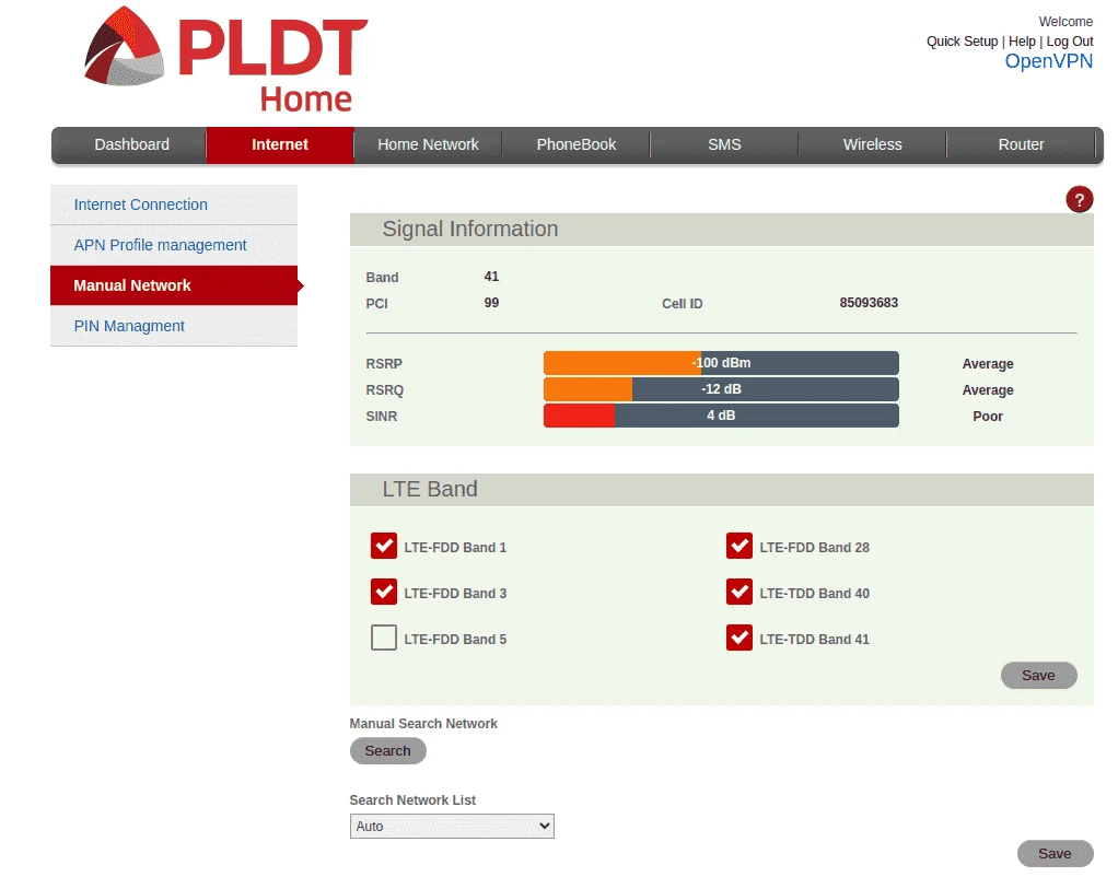

Note: kung hindi kayu na openline Suggest ko mag downgrade kayu ng Baseband

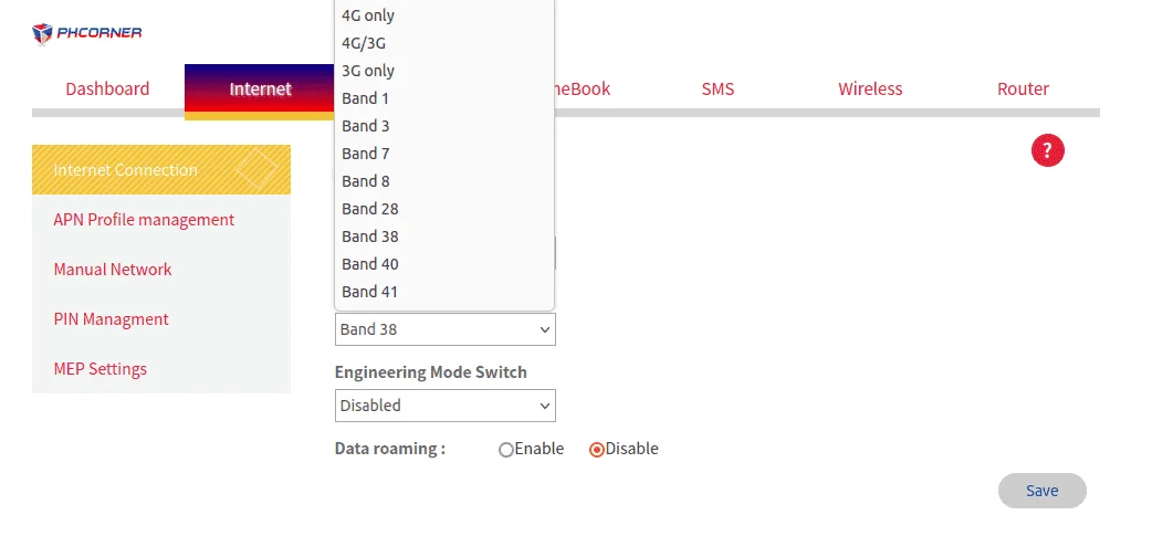

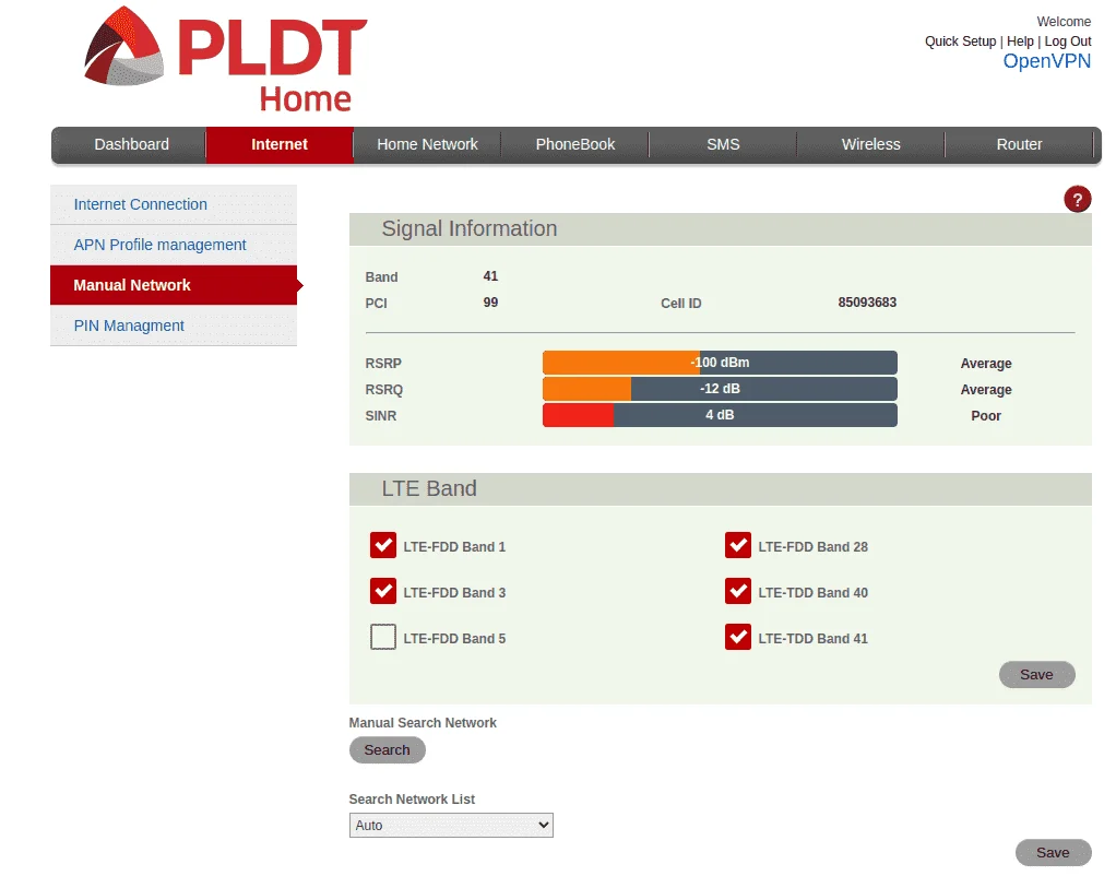

PLDT HOME R051 Firmware Openline Mode. with Simple BandLocking with apps NotionLink for android!!

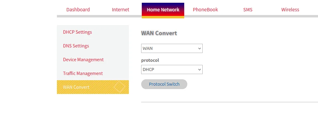

* Convert Wan mode
*QOS
etc...
Flash Tru TFTP
Download
Screenshot_20221004-004632_NOTION Link.jpgScreenshot from 2022-10-04 00-56-20.pngScreenshot from 2022-10-04 00-55-19.png

UPDATE**
PLDT HOME V8 STOCK MODIFIED with bandlocking + OpenVPN
____________________
UPDATE**
ChangeLog * update OpenVPN 2.4 to OpenVPN 2.5_rc3 *update OpenSSL 1.0.1j to OpenSSL 1.0.2
WEBGUI
r051.com or 192.168.1.1
pass
pldthome
OpenVPN
r051.com:81 or 192.168.1.1:81
default login
admin
admin

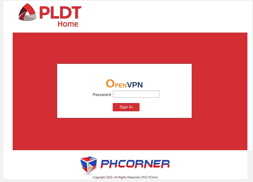

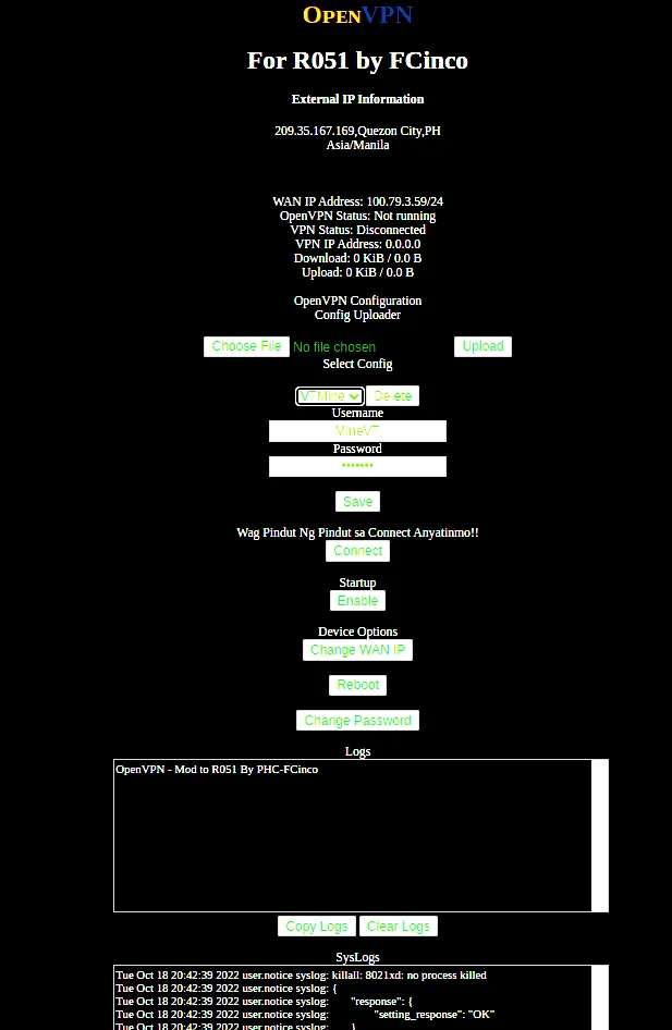

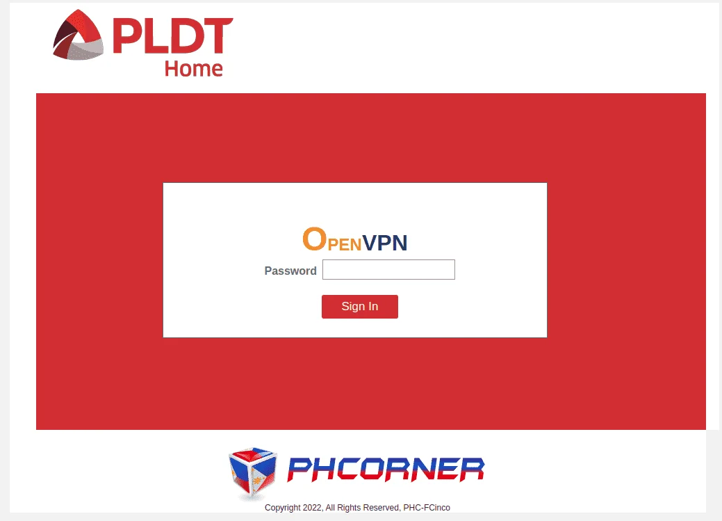

Screenshot from 2022-10-18 22-44-32.pngScreenshot from 2022-10-18 22-01-35.pngScreenshot from 2022-10-18 22-02-59.png

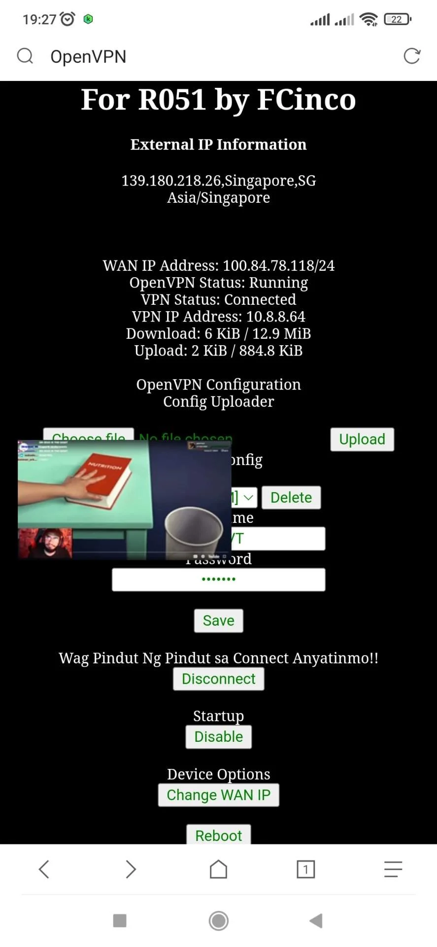

sakto lang hahaha nag build kase ako ng from scratch kmod-tun,busybox,openvpn saka openssl para gumana yung openvpn sa r051

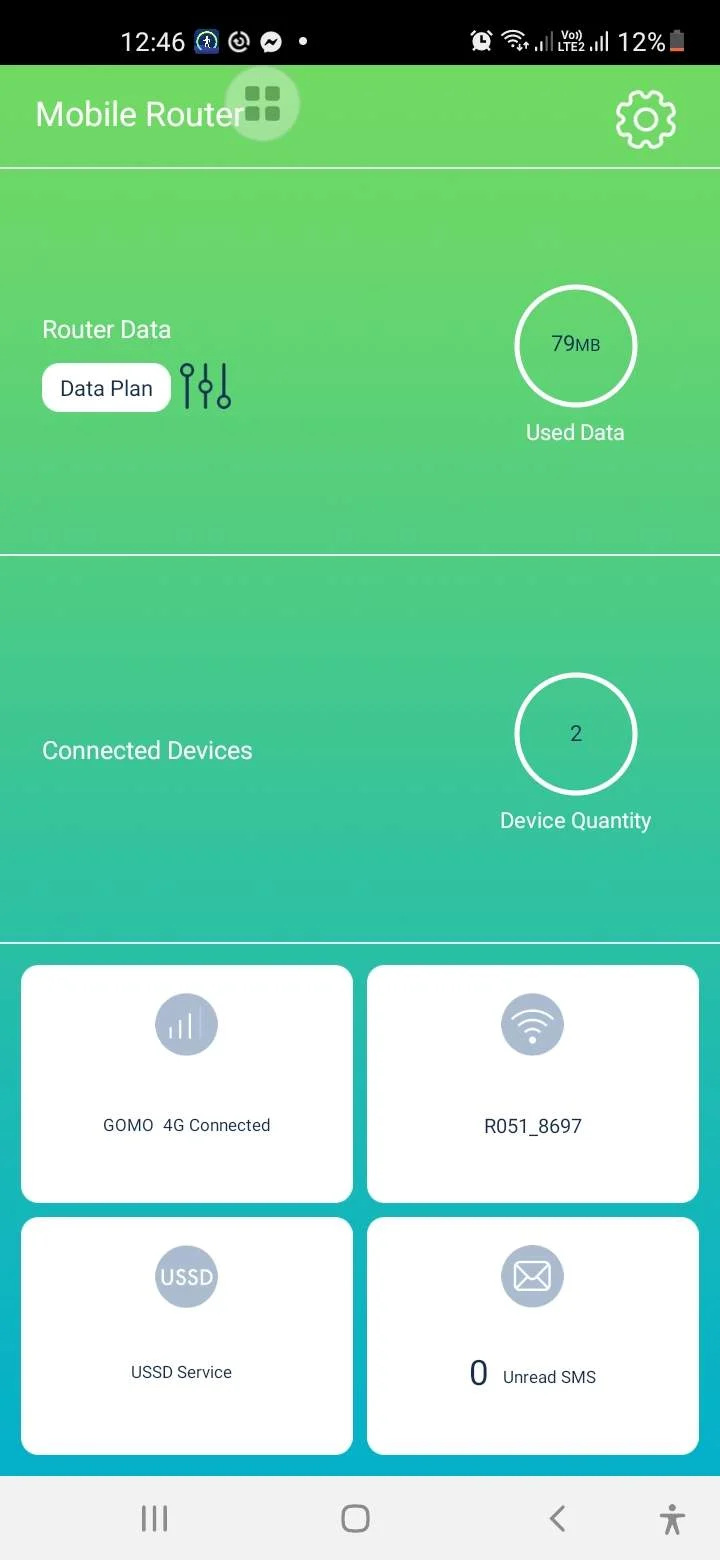

Nice ts, sobrang nakakatulong ito

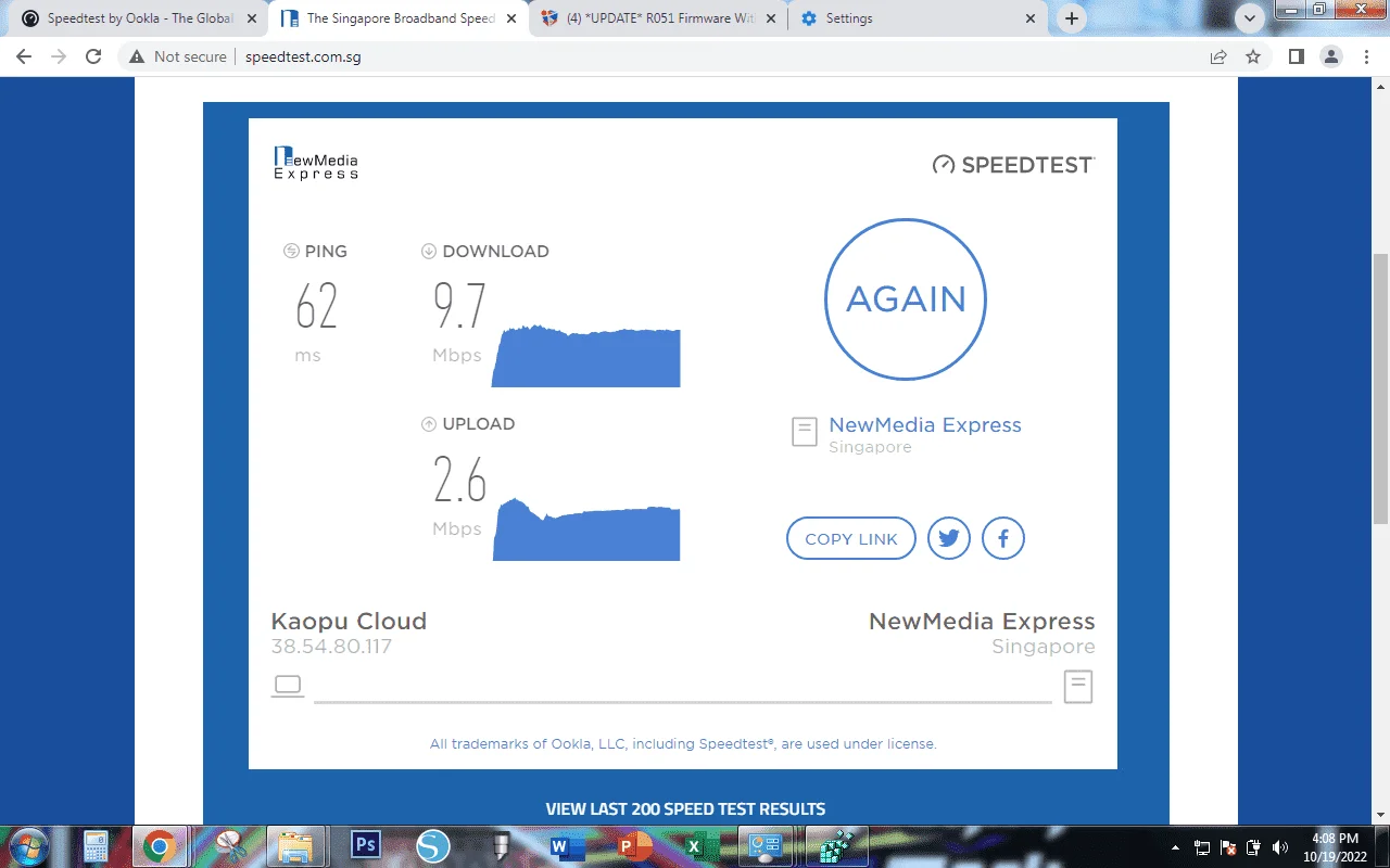

Kahit pala meron nung ibang firmware haha mabuti nareplace nitong ovpn firmware at sobrang helpful nung change wan ip para di ko na papatay patay yung yung modem 🤣( ngayon ko lang napansin yun option na yun😅)
Kaya pala mabagal yung ovpn, yun pala ididisconnect connect mo cp mo muna after connection completed para maging mastick na yung new ip from server config (ovpn) 😅🤣
Mabuti may config si Min3 from modem at nakikita yung 302found status
Salamat ulit ts ahah🤣😅

meron na ako stock modified firmware ng yung v8 na may band locking gui with openvpn ^_^ nasa first post na..
Screenshot from 2022-10-18 22-01-35.png Screenshot from 2022-10-18 22-44-32.png Screenshot from 2022-10-18 22-02-59.png
